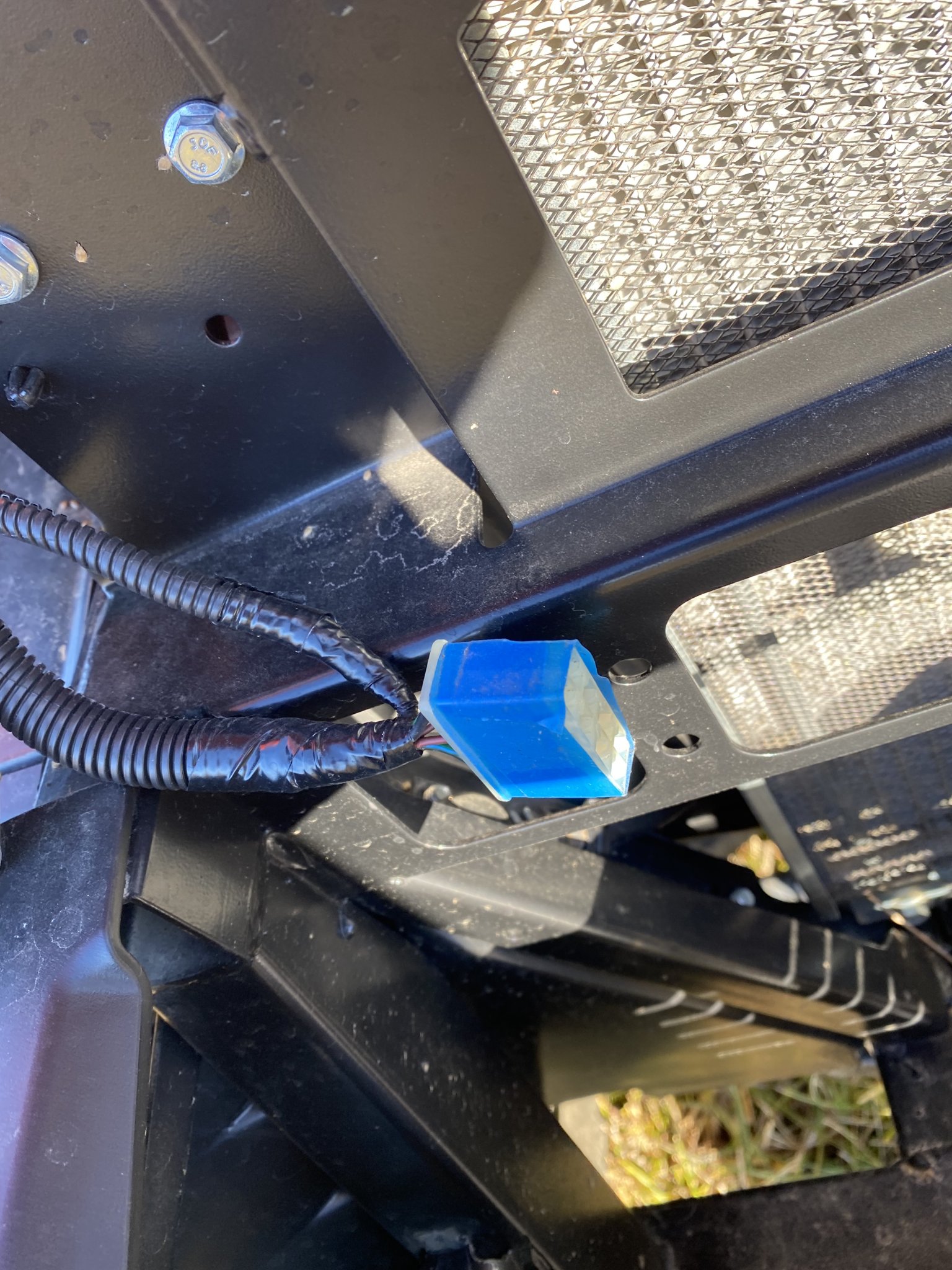

Blue taped plugs are for K aux add ons. If you buy a K kit your harness will just plug right in. If you homebrew then its up to you to figure out what's what. Buying a WSM will give you electrical schematics that will help you figure out which wires go where.
I homebrewed my own aux lighting wiring harness. In hindsight the money I saved I spent on a WSM and time making and fishing harness wires.
The turn signal kit includes a new light switch on the dash and turn signal lights. If I were to add turn signals I think I would buy the kit.
