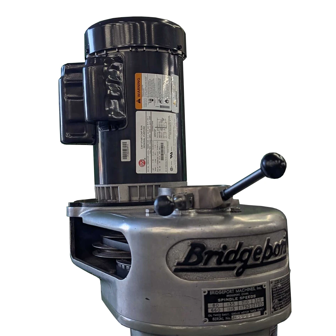

Two options
I bought a digital phase converter 20 years ago.
Set it up in my shop wired the output to a 3 phase panel.
Wired my whole 3 phase shop to the panel .
I have moved twice since then and it all came with me.
I have had zero problem with this setup.
It comes with a price though. 20HP converter in 2005 was $6000.00
I was running 2 CNC machining centers, compressor, grinder, lathe etc.
If this is going to be your only need for 3 phase....
eliminate the need.

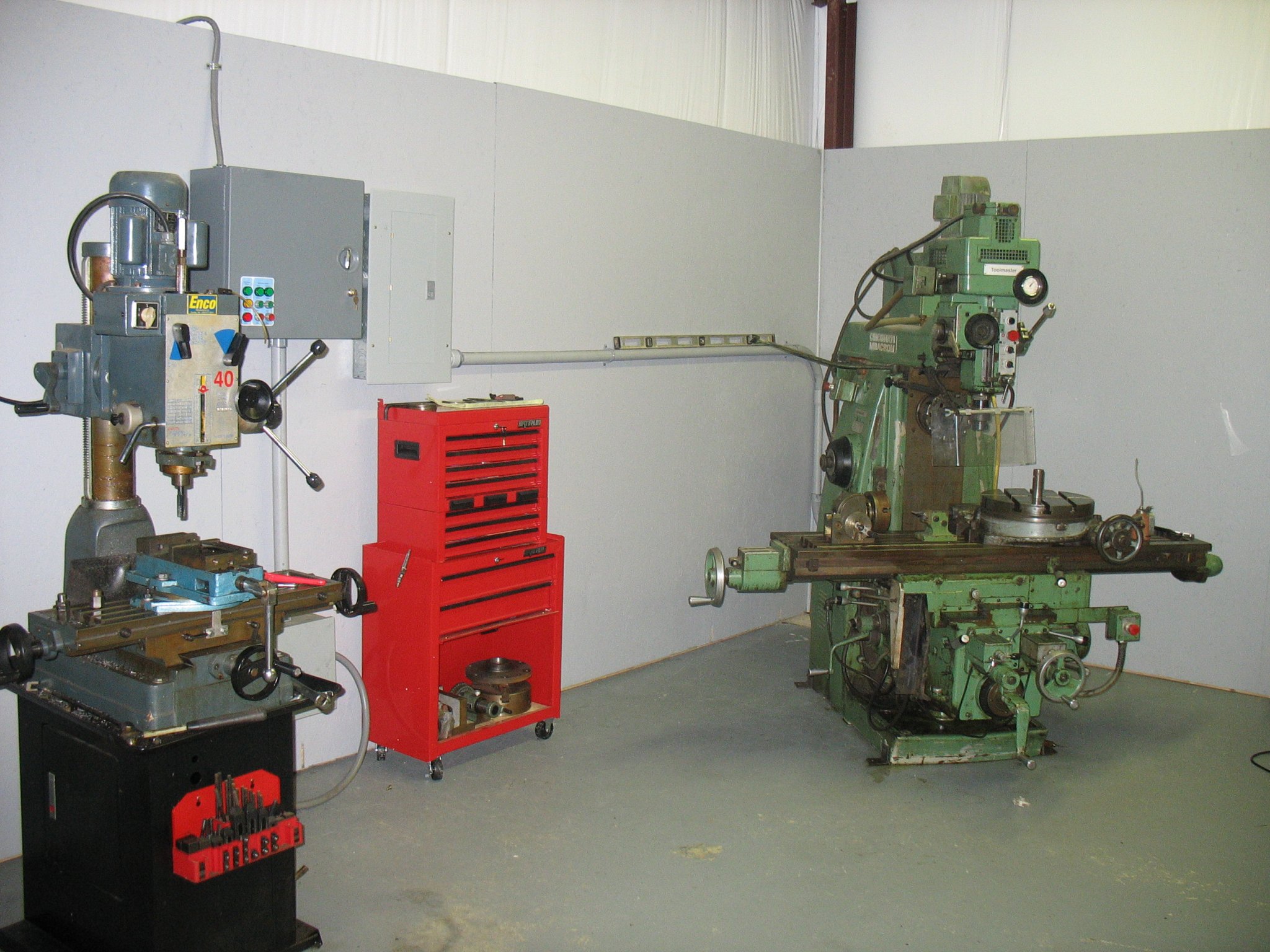

A simple VFD if you only need to power one machine with one motor.
Knowing your situatiin I would strongly recconend a DIY rotary phase converter. Cheap, easy to build and capable of powerung multipke machines and motors.
This is 20 years ago when it was first built for the "new" Cincinatti. Its been expanded to include circuits for two lathes, a horizontal bandsaw, and a cyindrical grinder. Still room to grow.
