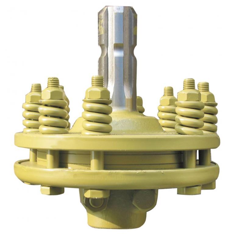

Do you have a slip disk clutch at the tractor end of the pto shaft to the mower? If so it sounds like that needs adjustment.
If the pto protection is a shear pin, and the actual shaft that enters the tractor stops then I think that a clutch inside the tractor is slipping or it is a hydraulic problem in the pto drive.

Or as Russell stats it could be a slipping PTO slip disk clutch pack.
