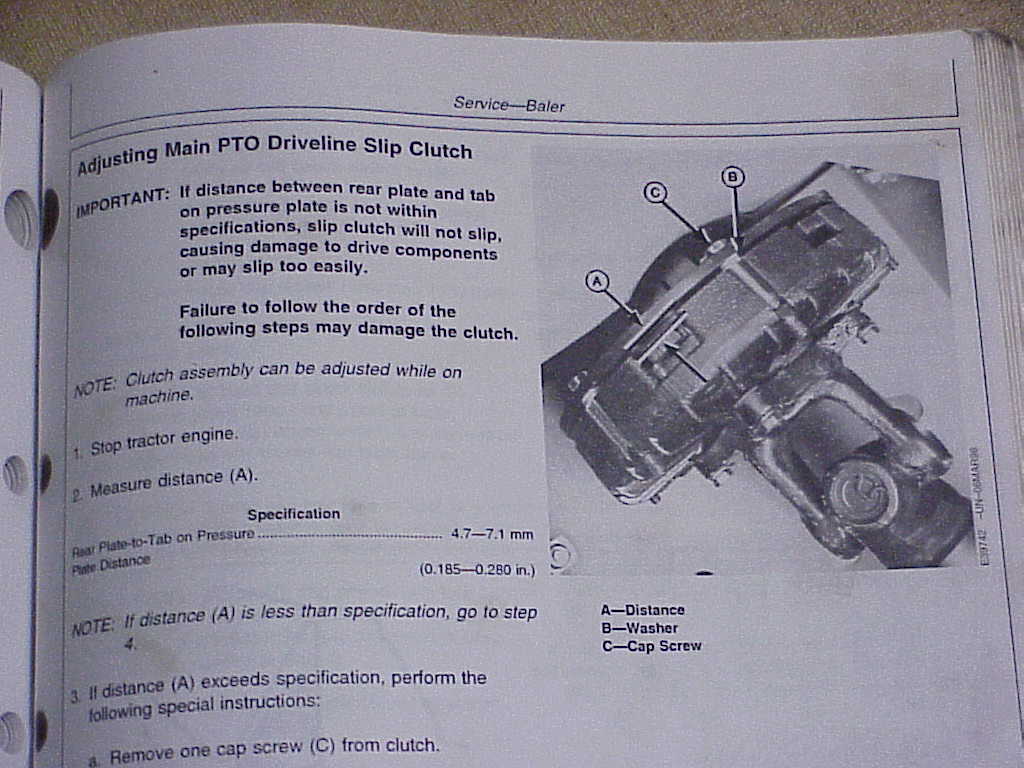

Weasler Torqmaster clutch which is very similar to clutch on my JD 467 rd baler needs at beginning of each hay season to have all 6 bolts loosened evenly until clutch plates slip then tighten bolts back up. I forgot to slip this clutch at the beginning of hay season last yr then a chain broke then locked baler down resulting in main gearbox shaft getting twisted off. IMHO slip clutch is designed to protect implement driveshafts more than protect tractor pto clutch.
