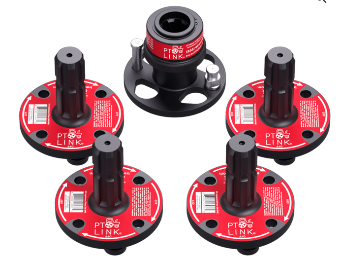

You may have to shorten your existing shaft but adding one of these would help. PTO Quick Connect

A pto quick connect is an interesting consideration for some.
I personally don't use these but a good friend does as he be getting too old for a lot of tasks and finds the investment is extending his working life especially since he makes a lot of attachment changes for his daily tasks. Doesn't need help from the kids and grand kids during the day.
These connectors decrease the needed pto length so acts as an extender as well by something like 4" but means attaching pto to tractor completely painless. He brought them back from his winter holiday from Texas.
