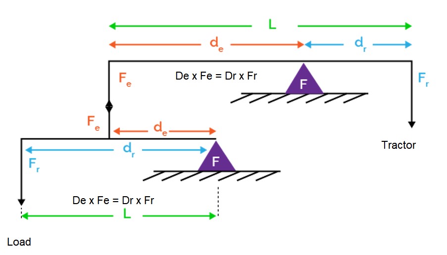

It should be somewhat linear, but it's complicated. Two different types of fulcrums involved. Upper arms pulling on the lower arms, the upper fulcrum values will be constant. The further out the load goes on the lower fulcrum the less load can be lifted. Fe x De = Fr x Dr
