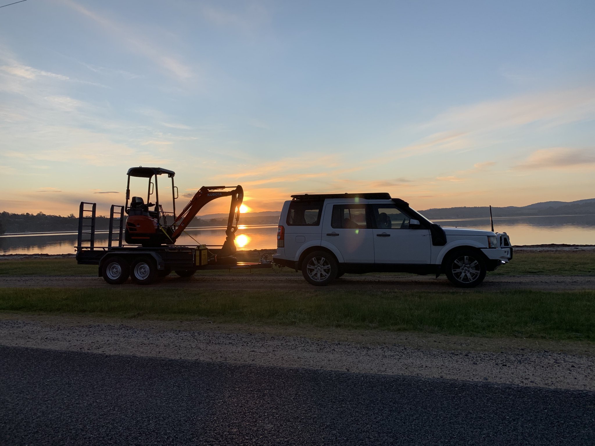

I have a U17 and it uses hydraulic oil (ISO 46). It has a tiny 900 cc 3 cylinder engine and as it was said before the engine basically only drives the hydraulic pump. Propulsion is also via hydraulically driven motors.
I would take the ex over a back hoe any day, I just move around a lot while using the ex. I'd add that digging is not the only thing I use it for, it's amazing how many jobs around the property need an extra (hydraulic) arm. The ex isn't fast but that's not the point: I can move while I use the arm. To a degree at least, on the U17 the hydraulics are not strong enough to move too many rams at the same time.
Hope that helps.

The U17 is pretty small and only has a manual throttle, no auto speed or other options.
However, it tows nicely behind the car on a medium sized trailer.
