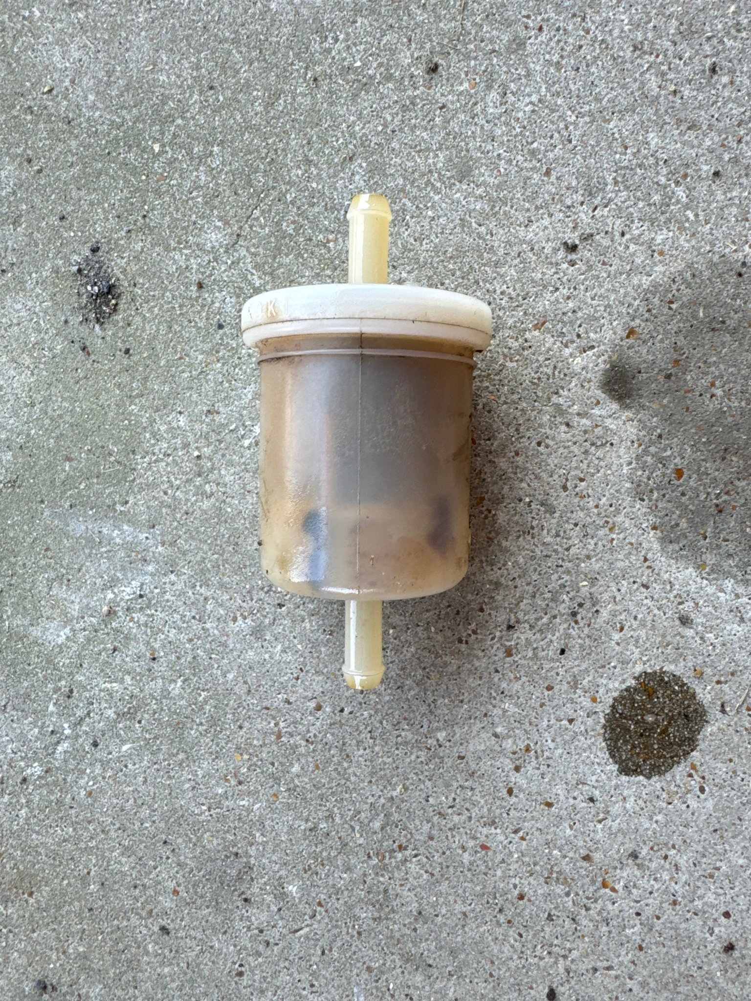

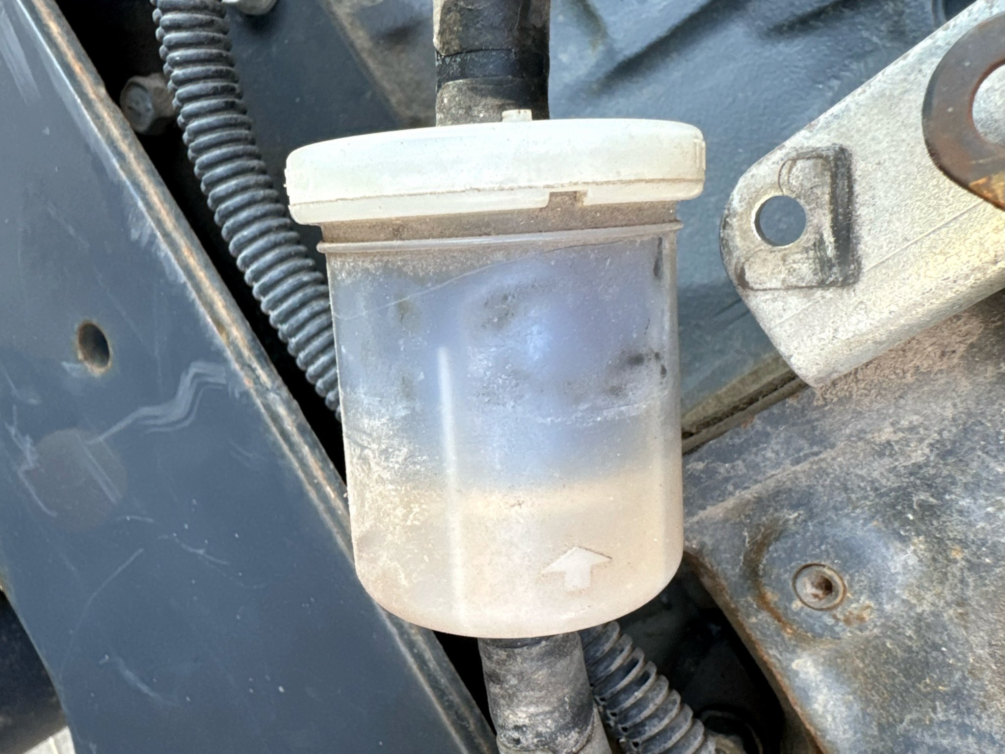

The fuel filters were clogged up, especially the inlet one under the tractor, which I understand is often neglected.
Inlet:
Outlet:

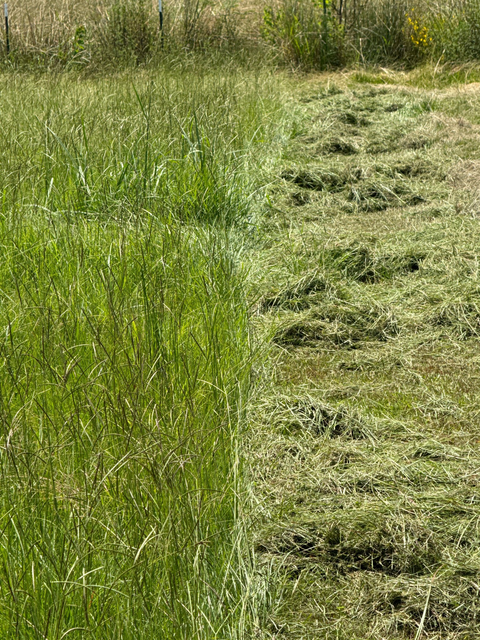

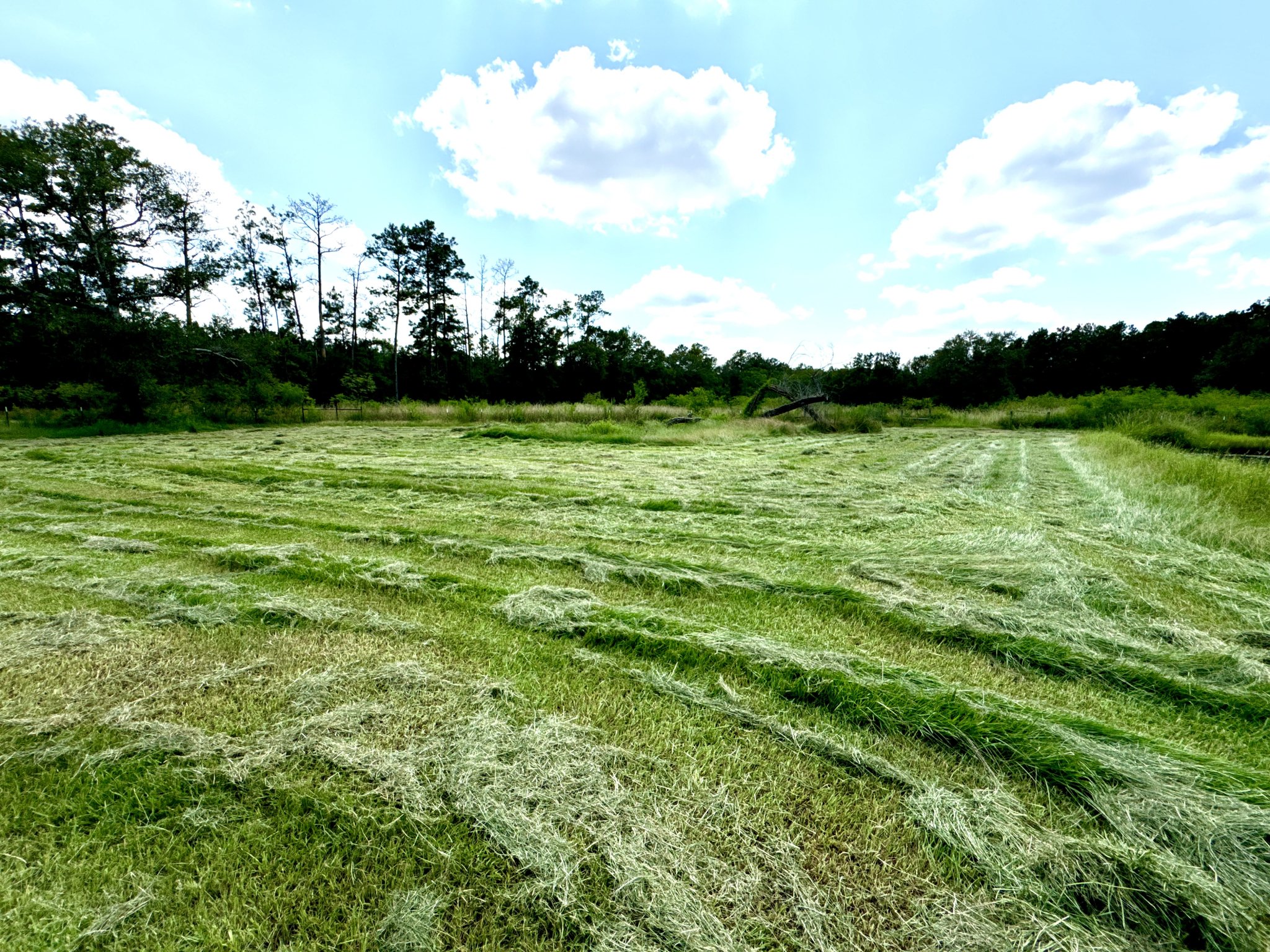

After they were replaced, the tractor and cutter worked just fine:
grass_height.jpeg \

The original smoke was not due to overloading the equipment; it was due to an extremely clogged inlet fuel filter which had probably been neglected by the previous owners, due to its location. See the photo for how ugly it looked, such as the two dark dots at the bottom.
That deprived the engine of fuel, causing black smoke and severe knocking at the smallest load when the PTO was engaged.
Once the filters were replaced, it had no problem cutting the grass, which ranged from 6" to 24" but was not very dense or thick (less than 1/4" thick, with no twigs). The grass had last been cut 5 weeks ago, but was interrupted by flooding.
I kept a constant watch on the temperature, which was never close to red. I never got the sense that I was pushing the tractor to its limits. It cut smoothly and just fine.
