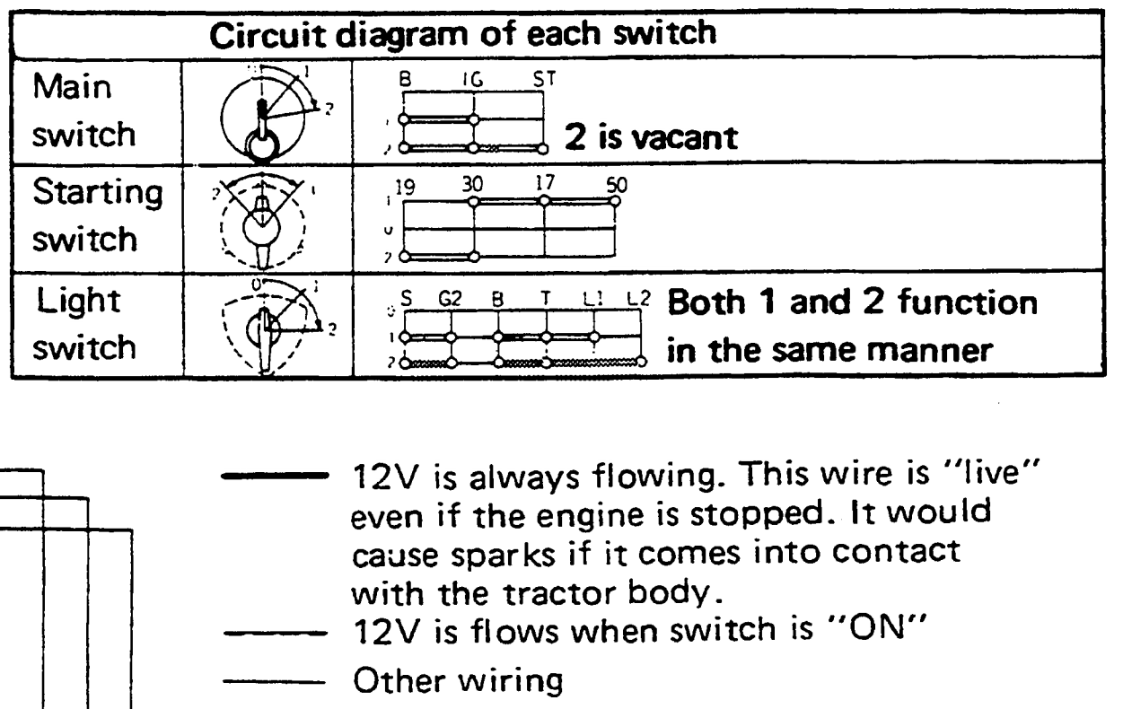

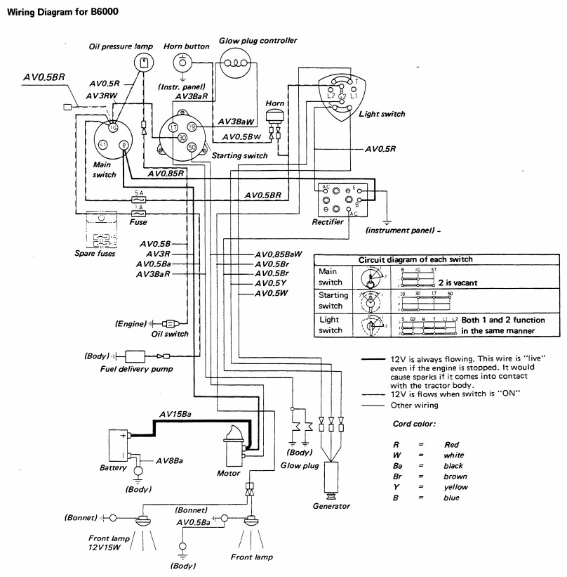

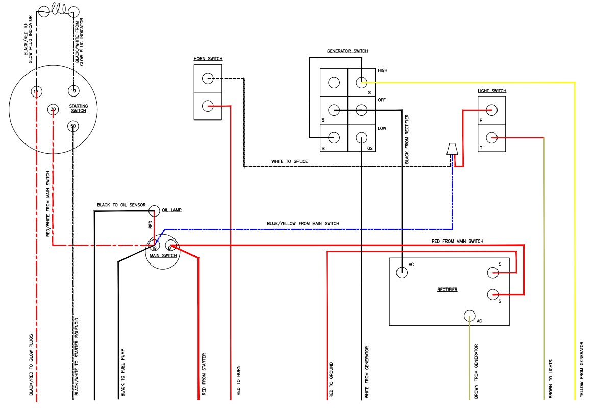

The B6000 light switch is more complicated than jut an on/off switch.
Here is a copy of the wiring diagram.
The previous owner of mine replaced the switch some that are more readily available.
It would probably be easier to try and source an OEM one.
Hmmm. A 6 pole switch, so not unusual, but the big unanswered question is, what does each position actually do? If you have a working switch, it's not difficult to meter out the functions, but if your switch just isn't working, that's not going to work.
Yes, for someone who does not know his way around electricity, that's the simplest route.
