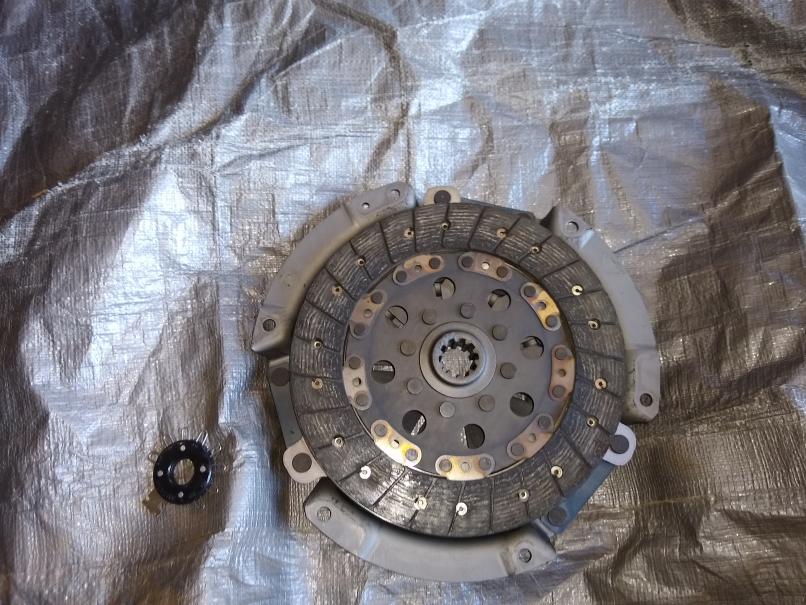

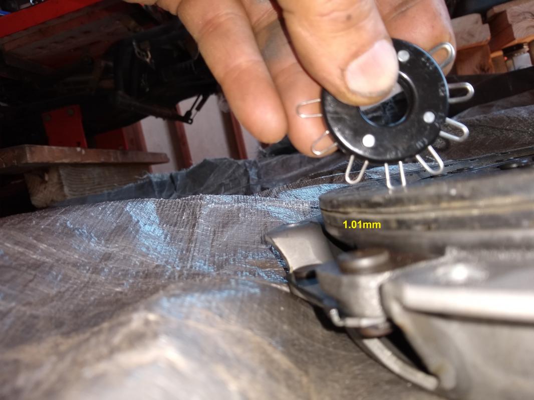

Split a 25-30 year old B2150hst with only 650 hours due to propeller shaft ball joint. The clutch looks very good, lots of surface left. About 1mm, service manual says .3mm is service limit to reinstall.
My question is, since its apart, should I replace just the pressure plate? Do the springs get relaxed or weakened over time? Non Kubota PP's are only about $60. Another way to ask is, what is better, a 25+ year old OEM Kubota pressure plate or a new aftermarket pressure plate?
The tractor is for personal use on 6 acres. FEL, Brush hog, hauling wood up steep slopes...
