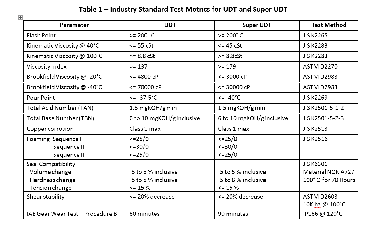

There is no reason for it to be "religous" and I think you are 100% correct on the suitability of UDT versus SUDT2 in most climates. I would extend that to include just about any competing premium UTTO.
The API has no definition for "synthetic" and use of that word is not particularly helpful in this context. The published data however are unambiguous and crystal clear. The defacto industry standard is the John Deere J20C and J20D specifications. It should be no surprise that UDT and SUDT2 look a lot like JD Hygard (J20C) and JD Hygard Lo-Vis (J20D) or that the original SUDT formulation was reformulated as SUDT2 around the same time JD released the J20D specification. If you are looking for a SUDT2 alternative look for an oil that meets John Deere J20D.
The other important property not mentioned in the tables below is water tolerance. SUDT/SUDT2 and J20D both require the oil absorb and hold 1% by volume water without additive dropout or formation of sludge.
