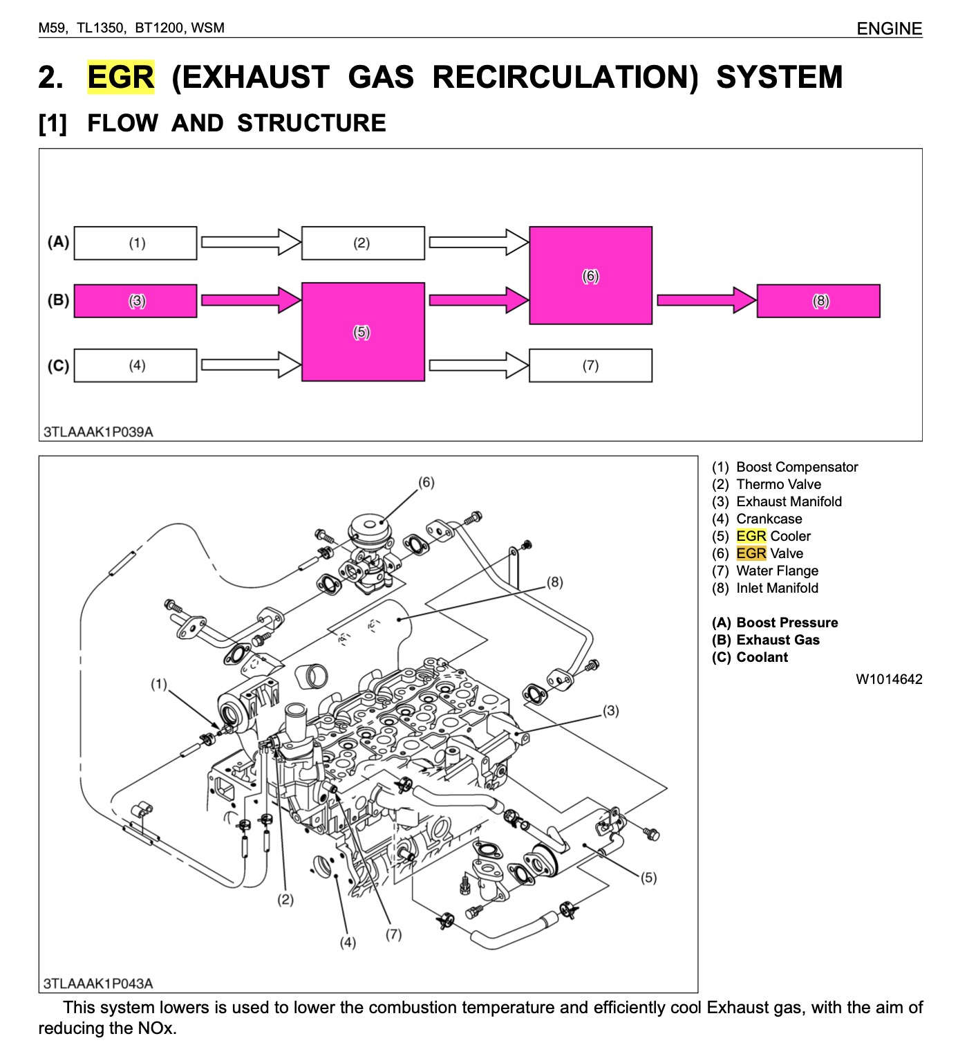

mikester Well-known member Equipment M59 TLB Oct 21, 2017 3,816 2,436 113 Canada www.divergentstuff.ca Sunday at 10:27 AM #1 I don't see any sensors in this setup on the M59TLB. Am I missing something?
North Idaho Wolfman Moderator Staff member Lifetime Member Equipment L3450DT-GST, Woods FEL, B7100 HSD, FEL, 60" SB, 743 Bobcat with V2203, and more Jun 9, 2013 33,059 8,480 113 Sandpoint, ID Sunday at 12:26 PM #2 Are you asking what controls it? #2 Thermo valve
mikester Well-known member Equipment M59 TLB Oct 21, 2017 3,816 2,436 113 Canada www.divergentstuff.ca Monday at 1:50 AM #3 No, basically wondering out loud how critical the EGR is as it looks like a purely mechanical system that isn't integrated with the ECU in any way.
