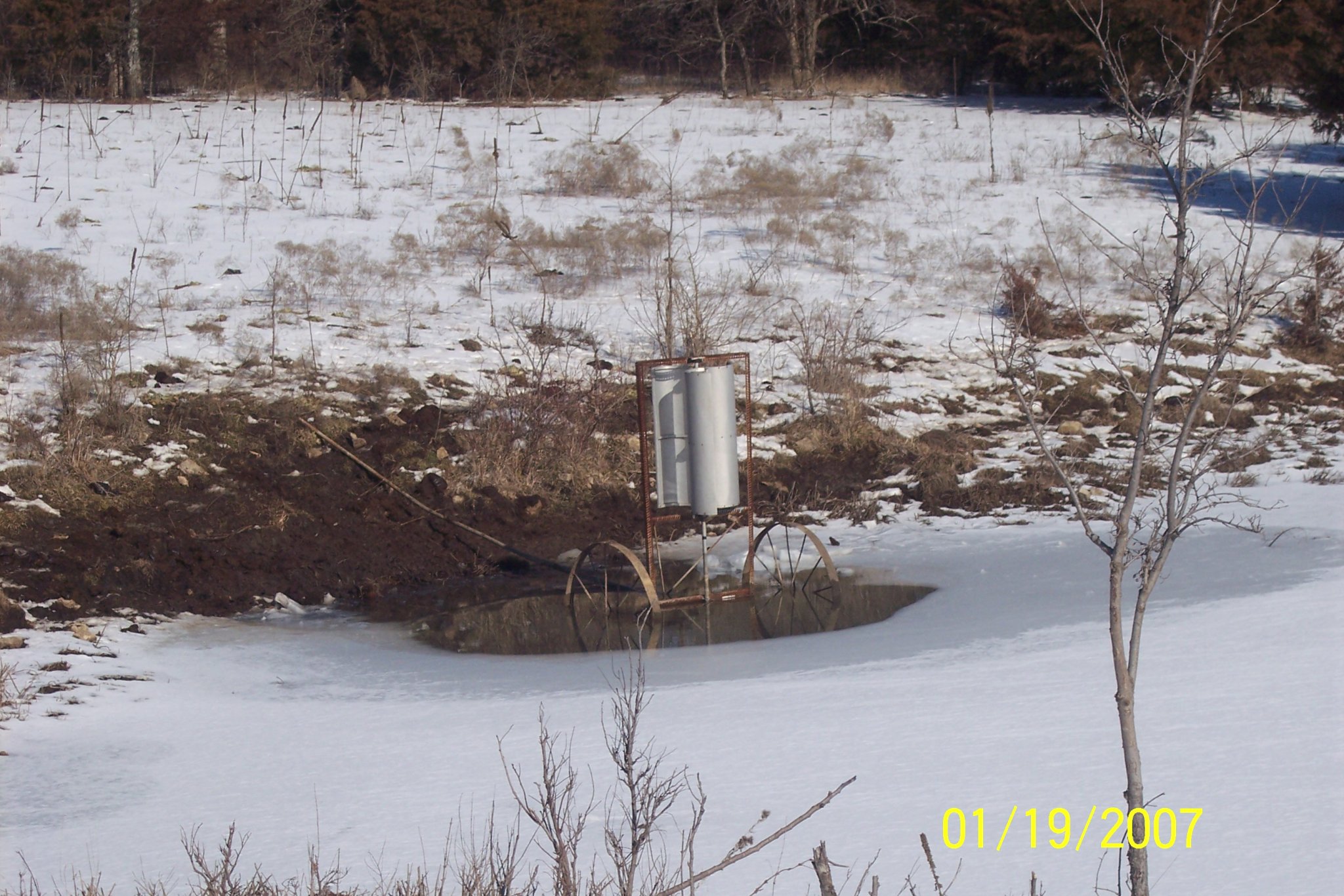

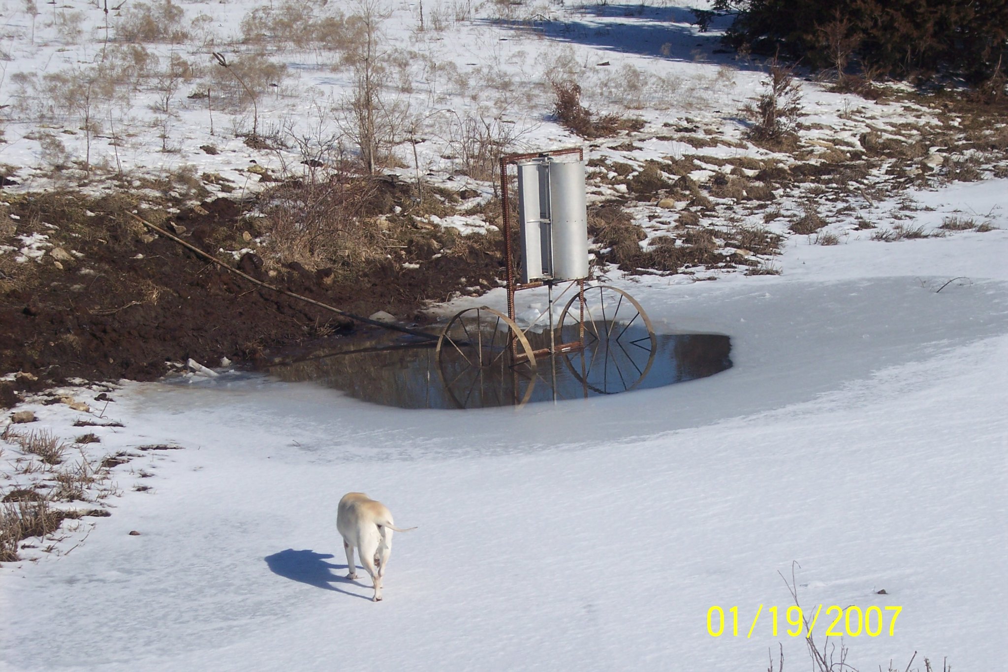

I have a wind activated aerator. It pulls the water up and keeps the pond open in freezing weather. Simply has a lawn mower blade at the end of the shaft. Creates a constant turn over.
