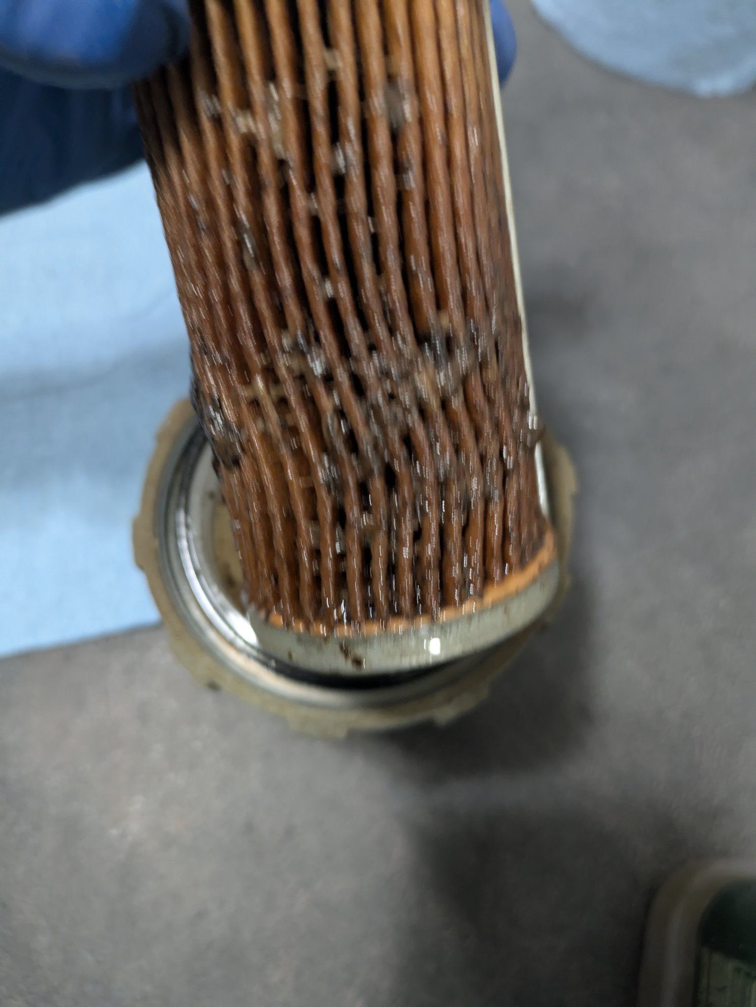

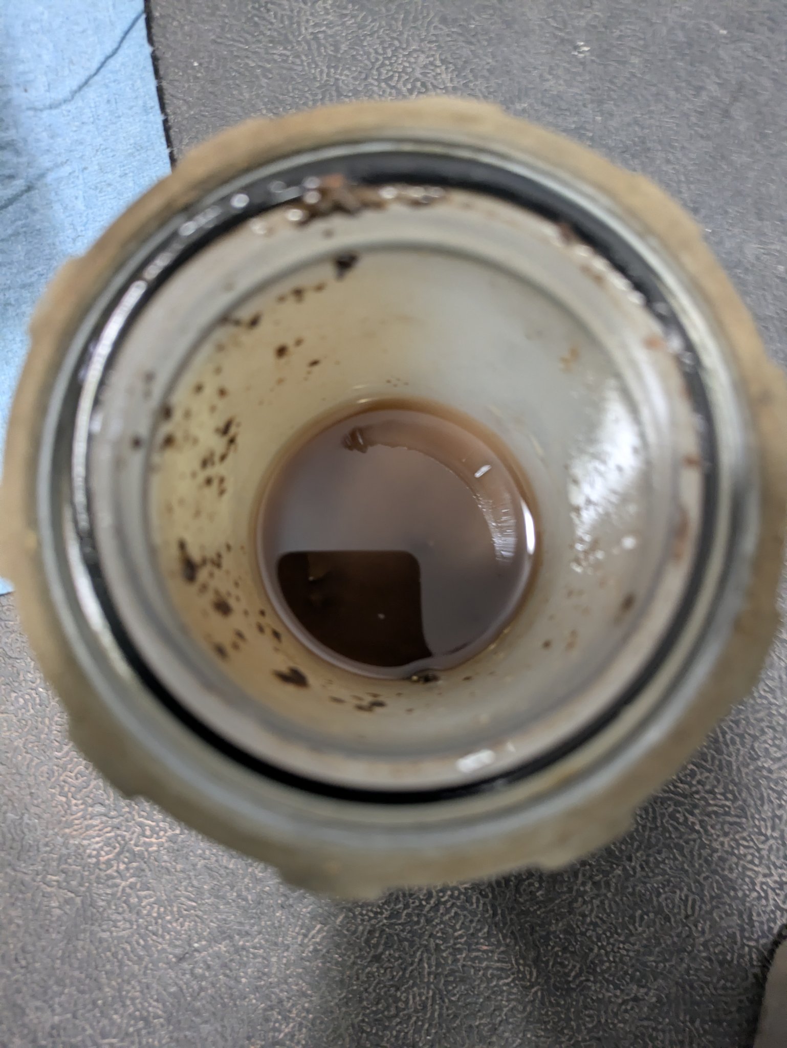

A few days ago my L2550 stayed sputtering and stalled. I restarted without issue but it was still sputtering and stalled again after about 15 seconds. I realized the fuel filter housing was draining every time it would run and once it got empty it would stall. Filter looked dirty so I removed the filter and cleaned it and the housing. Pics attached of what they looked like.

What time does the stuff I found in the filter and housing look like diesel microbes or just general contamination from a 30-year-old tractor?

That looks like bacteria slime, you need to treat the fuel.
You still might have crud in the tank besides the slime.
I wondered about that after doing some googling and comparing photos of slime to what I saw in mine. Thanks for confirming.
