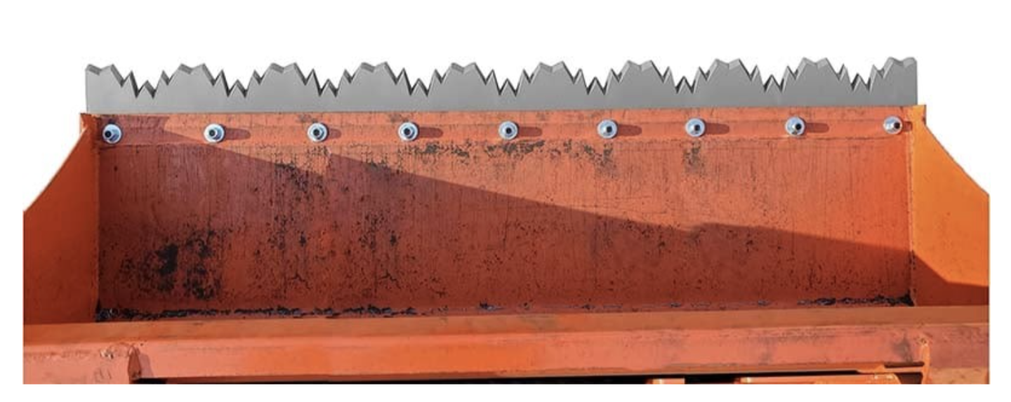

I'm trying to decide between the piranha pro vs two standard bars (one flat and one toothed). I'm about to sign for an L2502 and elected not to get the Kubota cutting edge for the bucket and will just get the piranha toothbar.
The standard piranhas would be easier to swap out with two bolts, and something about the design looks more secure to the bucket. The pro would be more of a pain to turn around with the several bolts. I feel like I'll be in toothed mode most of the time.
Not sure which tooth pattern would be more effective for cutting through saplings or penetrating clay. What do you guys think?
The pro has smaller/frequent serrations and several bolts and is reversible. The standard has two bolts and larger/infrequent serrations.

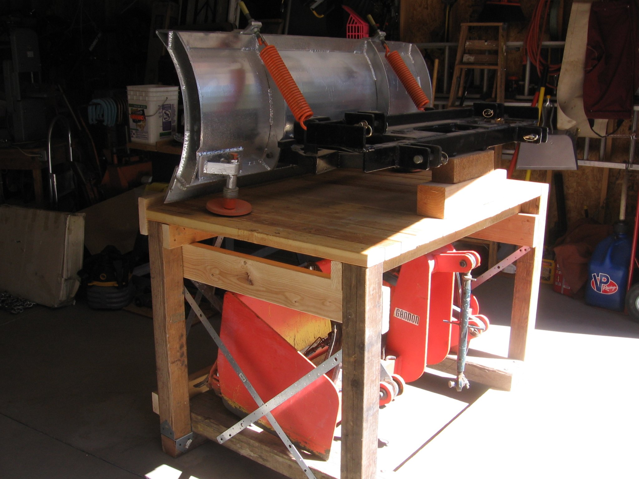

Where do you store it when it's off of the bucket? I was thinking about a shelf of some sort, or try to hang it up but it's probably too heavy to hang/unhang by hand (and sharp?)?
I have an implement stand I built, I just lay it on the top shelf.
(pics below are test pics, the plow blade is actually set all the way to the back now, leaving room for the PTB)
