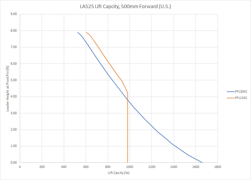

Thanks for the thoughtful responses on this topic. The interesting points seem to be that if you want to push the loader at high elevation, go with PFL1242. If you want max lift at lower elevations, go with PFL1242. In order to clarify this point, I decided to develop loader curves for both sets of forks which I present below. I developed the curves using the following assumtions:
- The weight of the forks and the load are at 500mm (~20") from the bucket pin.
- When the rated capacity of the forks is reached, the unit can not lift any more weight.
From this graph in appears that if you're under 4 ft, the PFL2042 would be preferred, but if your over 4 ft, the PFL1242 will give more capacity. Of course, I have no idea as to how much safety factor is built into Land Pride's capacity ratings.

I have same loader and the 2042 forks....more handy than pockets on a shirt. Will easily lift 900-1000lbs to trailer height (<24"). But you got to be mindful of where/how weight is distributed, keeping as much as possible toward the rear against the headache rack.
There are other means to lift heavier loads. Recently needed to lift one end of a large chunk of concrete, prolly 2500-3000lbs. Forks would not do it....but swapping over to a beefy root bucket and some chain, was able to lift enough to slip some 2x under it. My point is, the bucket was 200lbs less than forks....just enough to gain the extra oomph I needed.

You should be fine with the 1242's. The loader rating is at 500mm or 19.68 inches. The pallet forks are rated at 24 inches from the front face of the frame. This is another 6-8 inches from the loader pin. By the time you figure that far away from the pin your capacity has dropped well into the range of the pallet forks.
