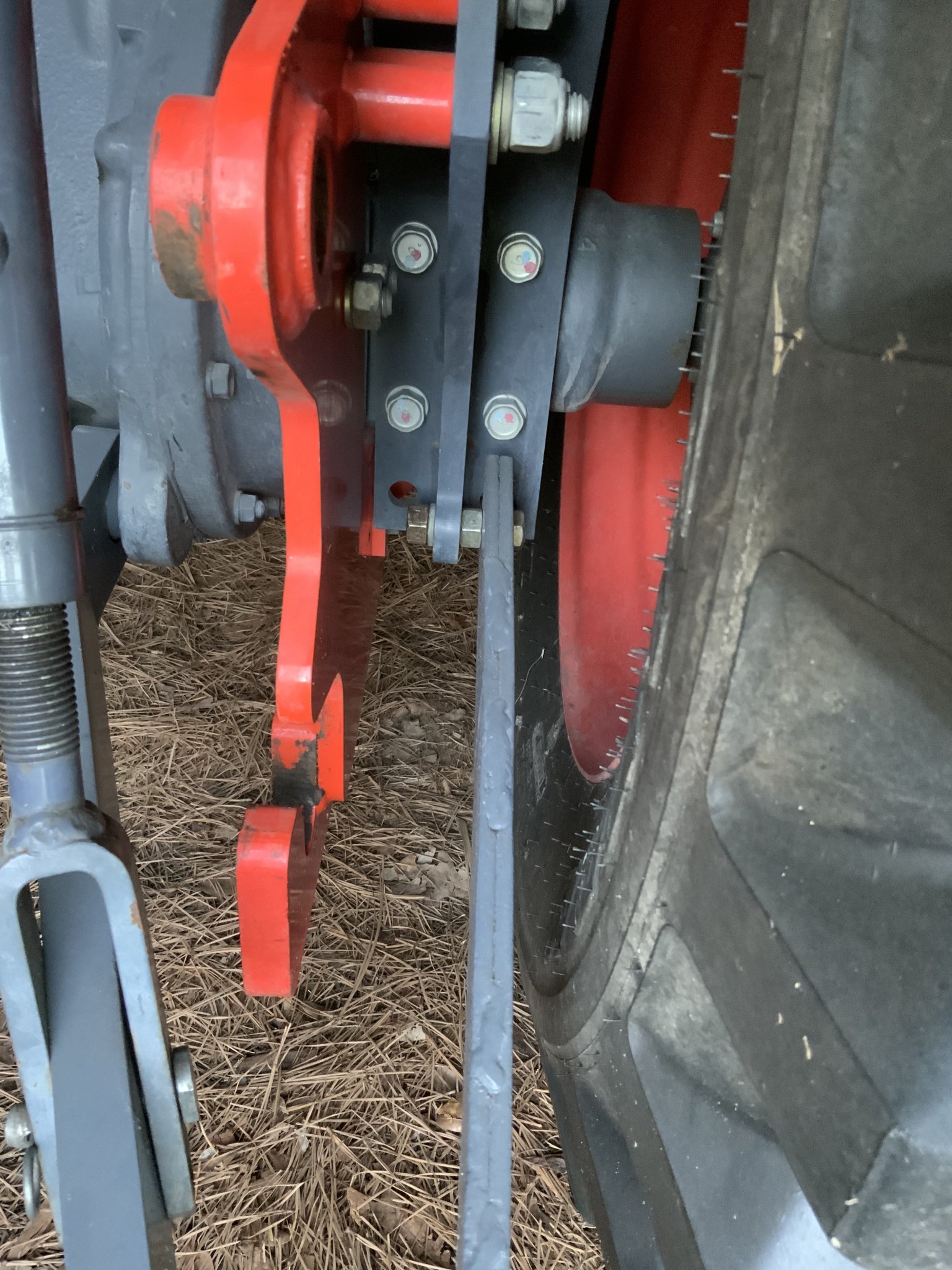

Check out your lift arms. Notice they have ball joints on both ends. This is to compensate for geometry changes when you raise and lower implements or change the side link to angle the implement.
Tried Pats on a BX and rear tiller. It started to damage the tiller pins because all the bolts clamping Pats to the lift arms transferred twisting forces to the implement. Don't despair they make good boat anchors when you upgrade to a quick hitch.
I never experienced that problem after using the quick hitch for over 15 years and yes I used a tiller on the tractor. But it was a larger tractor than a BX, so the lift arm geometry was different.

Well that's one of the downsides of a quick hitch, is you have to run all your pins the same way and some implements almost won't allow it to work without major metal mods.
Without a quick hitch you can often decide to face pins in or out on a given implement to fix clearance issues.. but then gotta mess with your stabilizers more often. :)
Also, top links are cheap, and the middle of it is just a pipe. If you need a longer one buy a longer one or weld 2-3" of pipe into the middle of the one you got.

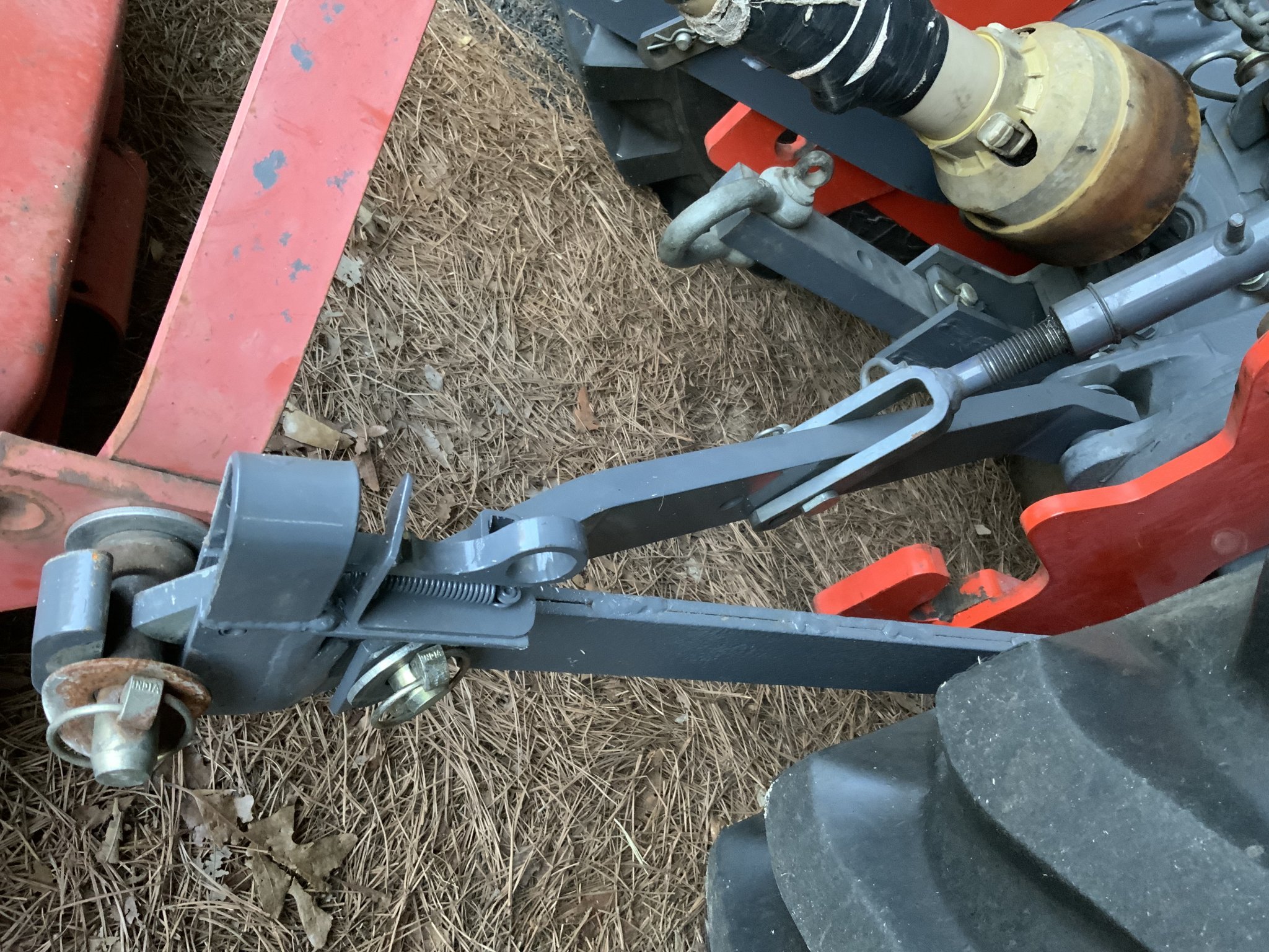

I have a conventional QH that I bought at the local farm store on a black Friday sale for $199. It's made in India but has good weld's and seems as good as the Land pride QH15. All my implements are QH compatible. It's not an issue to hook them up. The QH mounts to the factory balls. Plus I have a top and tilt kit. The advantage to me off the setup I have is the top link is always connected. So I don't have to deal with the top cylinder being loose and needing to have it hanging off the back.
Velma
B2301, FDR1660, RB1560, SGC0554, Pats QH, CMP Dethatcher
May 12, 2022
74
47
MI
Pats QH is awesome.
So much easier hooking up the rear blade. Attachments with lower pins are a pain…especially heavy ones. Now those attachments can be lifted from the seat of the tractor. Or lighter ones simply placed in the hooks. Easy.
Didn’t really need it for the finish mower as it’s on wheels and has floating(clevis?) type bottom links.
As a bonus I don’t need the QH straps either like you would with a normal QH and a finish mower.
I also did NOT have to get a longer top link. It extends enough on a B2301 to work with everything I currently have (which aint much). And the finish mower has some adjustment on the lower links to offset the length from the QH.
If you do get a set. Test fit first. I had a hell of time getting the pins in (a hammer and cuss’n was involved) before taking a Dremel to the casting and smoothing some of the inside edges. After that the pins slid right thru.
and do remember to rotate the locks in place. I have forgotten on more than one occasion. Things will release and come out off the hooks. Not sure how but they will.

I've heard about quick hitches and the fact that they don't have ball joints either, I'm not that impressed by the hatchet job.
Well, the 3pt ball ends are still there. You can think of the qh as an implement of its own. It can still rotate on the ends of the arms if you adjust your side link, etc. You just have to leave enough space to either side of the ball ends to allow a bit of angle before the arms themselves start hitting something. That's why a lot of the balls in the ball ends on top links etc have 'spacers' sticking out the sides of the pin hole in the ball.. to keep the walls of the bracketry far enough away for the arm to be able to move around.
Not saying it's perfect, but putting a QH on a 3pt doesn't necessarily ruin ALL of its articulation.
