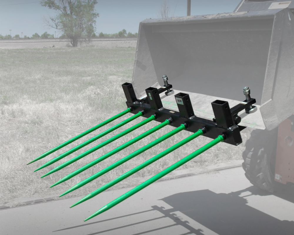

You may have more luck with a add on manure forks if you are just looking at carrying debris.

The one in your photo may work better than the clamp on only type, but look at that chain link going over the top bucket edge, don't you think it will bite into the tiny contact point and cause bending there?
