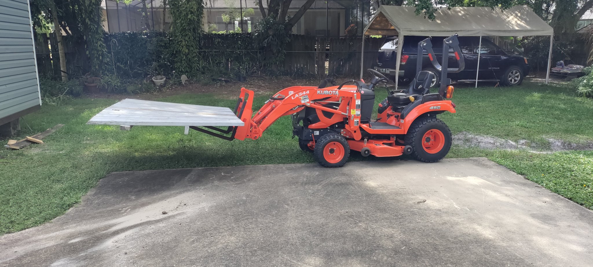

I got these forks in pin on configuration and 36 inches for my BX1880 being the most affordable at the time and appear to be well built. I have used them for several things, including digging and they have worked very well.

I got these forks in pin on configuration and 36 inches for my BX1880 being the most affordable at the time and appear to be well built. I have used them for several things, including digging and they have worked very well. View attachment 92065 View attachment 92067 View attachment 92070

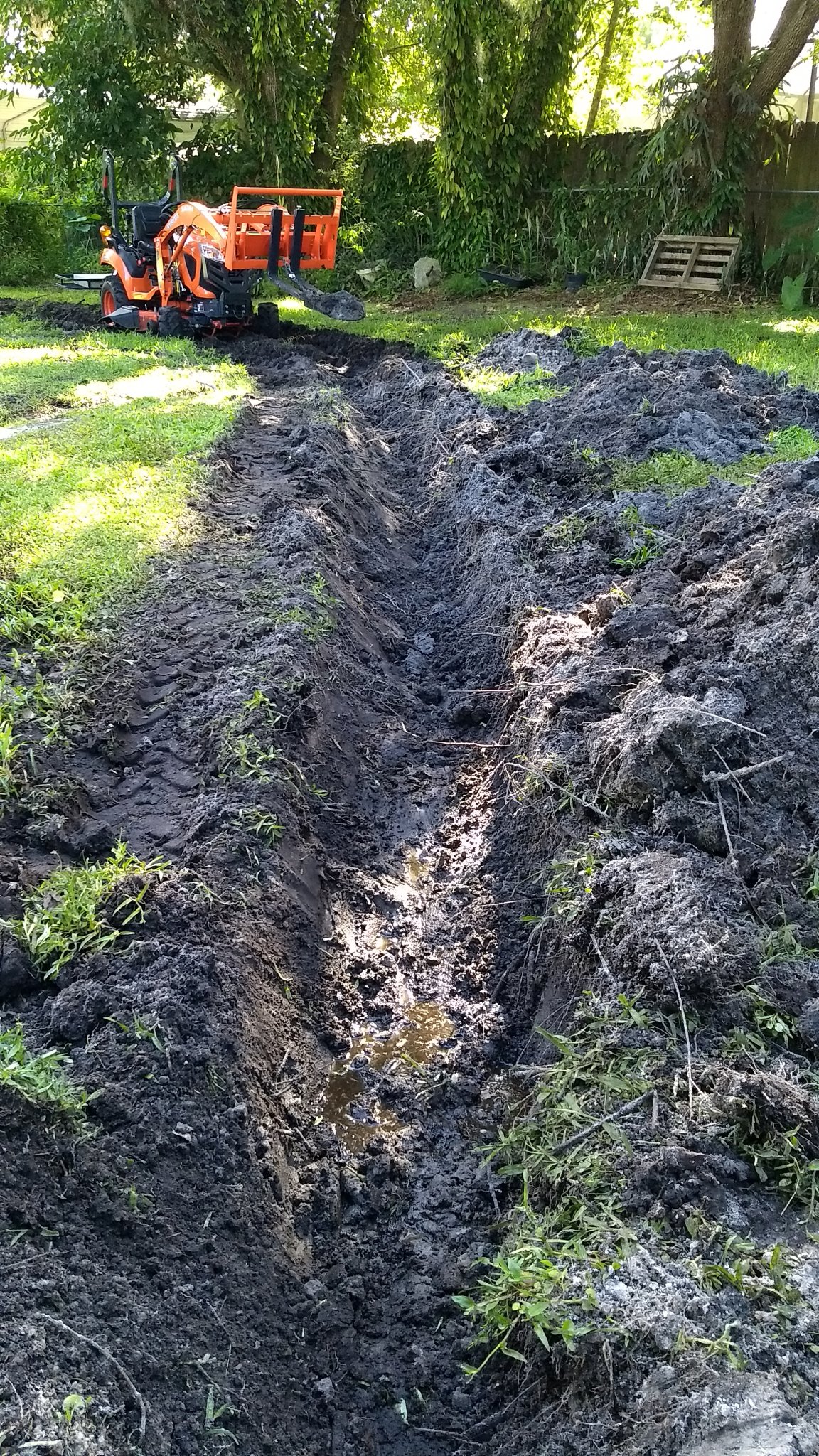

this is amazing. I hadn't thought of digging with them. is there a shovel mod on the front of them, or is that dirt? I have to rebury cables so this is super interesting
I'm interesting that fork shovel too!

Go to the Agri Supply website, and search "Subsoiler".
Subsoilers (3 pt.) are also sold at TSC.
The TSC website has a cable laying sleeve attachment for their 3pt. subsoiler, but that attachment is also simple to make.
MUCH easier/faster for cable laying than a backhoe, or the "spade" shown above.
I have the Agri Supply model.
It is a great little tool, and very inexpensive.
Its a Paumco Quick Spade. Its intended for a skid loader but it worked great for me with my 36 in, forks and my tiny BX1880.
