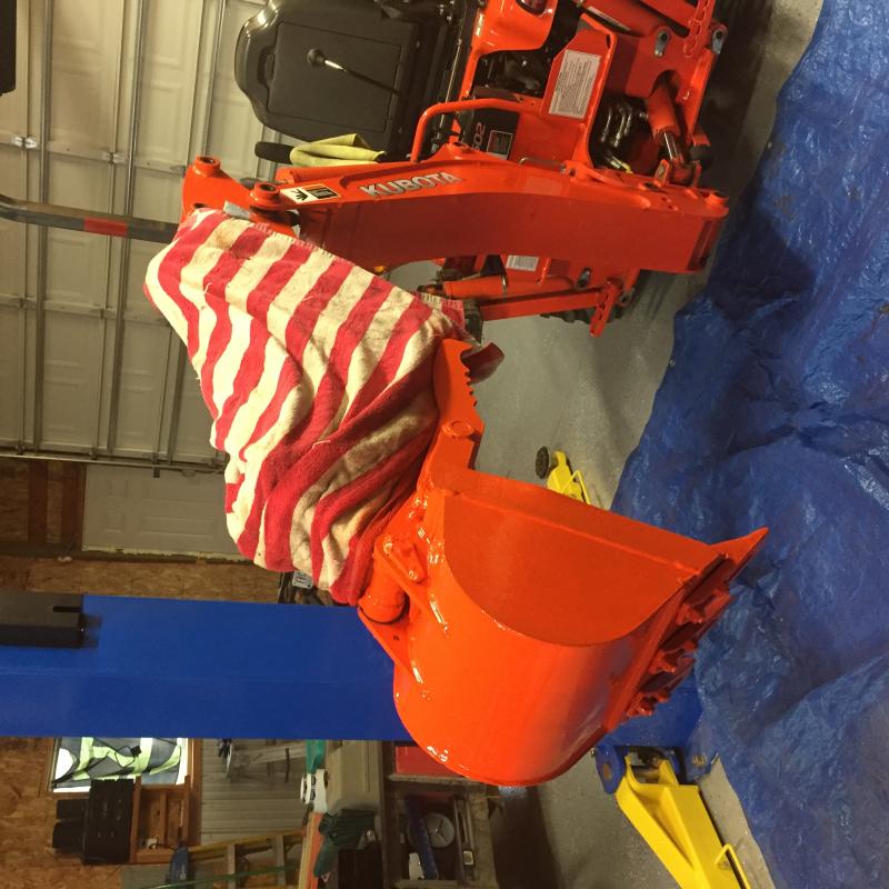

North 40 carries a paint in aerosol, gallons or quarts. It's called Van Sickle, and I paint my implements each season when I take them off for storage. Here's an example before and after. IMG_5243.jpg
One aerosol can will do the FEL, hoe or snow blade. It does take 24 hours to dry to the touch, but it's a thick glossy paint, and looks great till you dig again the following season. If you do the whole tractor, you can purchase hardner and a gallon.
