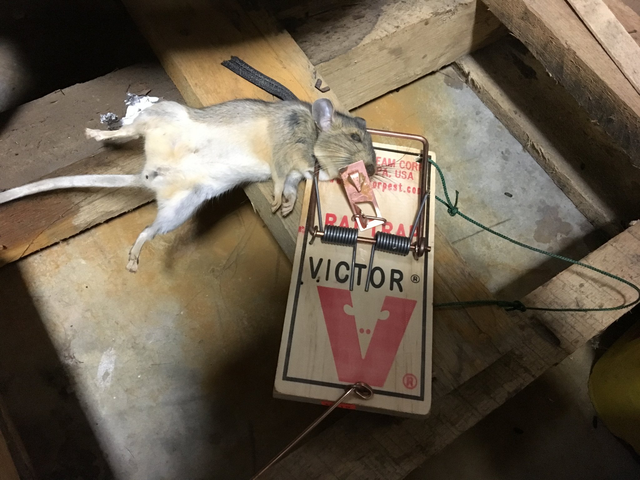

Used to think they only existed in a saying until I found this mess in my shop one day. Couldn't believe all the stuff it managed to drag under my compressor.
It did have a happy ending though, got him the first night using peanut butter. Got a neighbor who can't get rid of them. He's got one that for some reason brings his "treasure" up onto his back porch right outside his door.

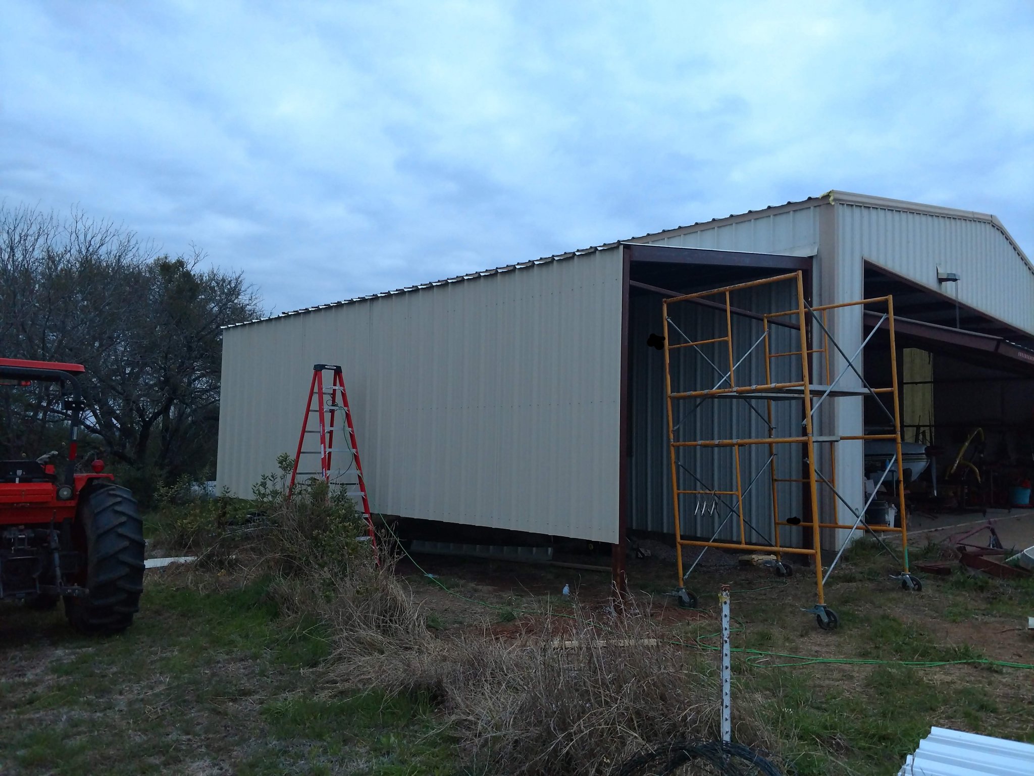

D2Cat.... I have a pontoon boat under a R-panel side-shed (pic taken while under-construction) and the Birds like to sit in the purlins and poop all over the boat. I bought some plastic spike-strips that are a perfect fit inside the purlins and that took care of that. They then chose to perch on the string-of-lights that run down the center-line of the shed. I bought another spiked-product which I wrapped around the light-string full-length and that took care of that. Wasn’t cheap... but sure worked. Here are links to the products:
