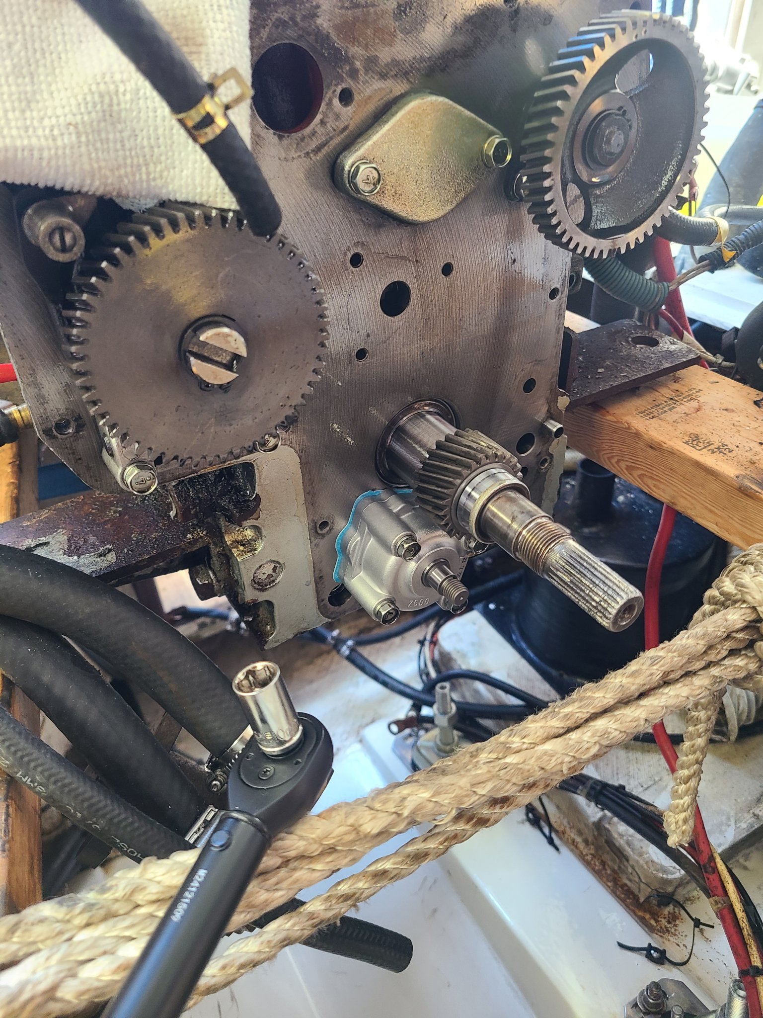

-replaced oil pump
-replaced pressure relief valve

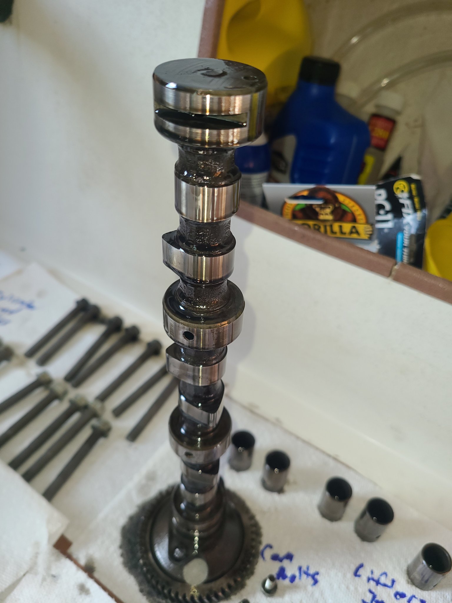

I can't figure out what else could be at play, only other thing i saw someone mention was that if the camshaft or block was worn where it rides since it has no bearings that could possibly affect oil pressure, but I only saw one person mention it in a thread.

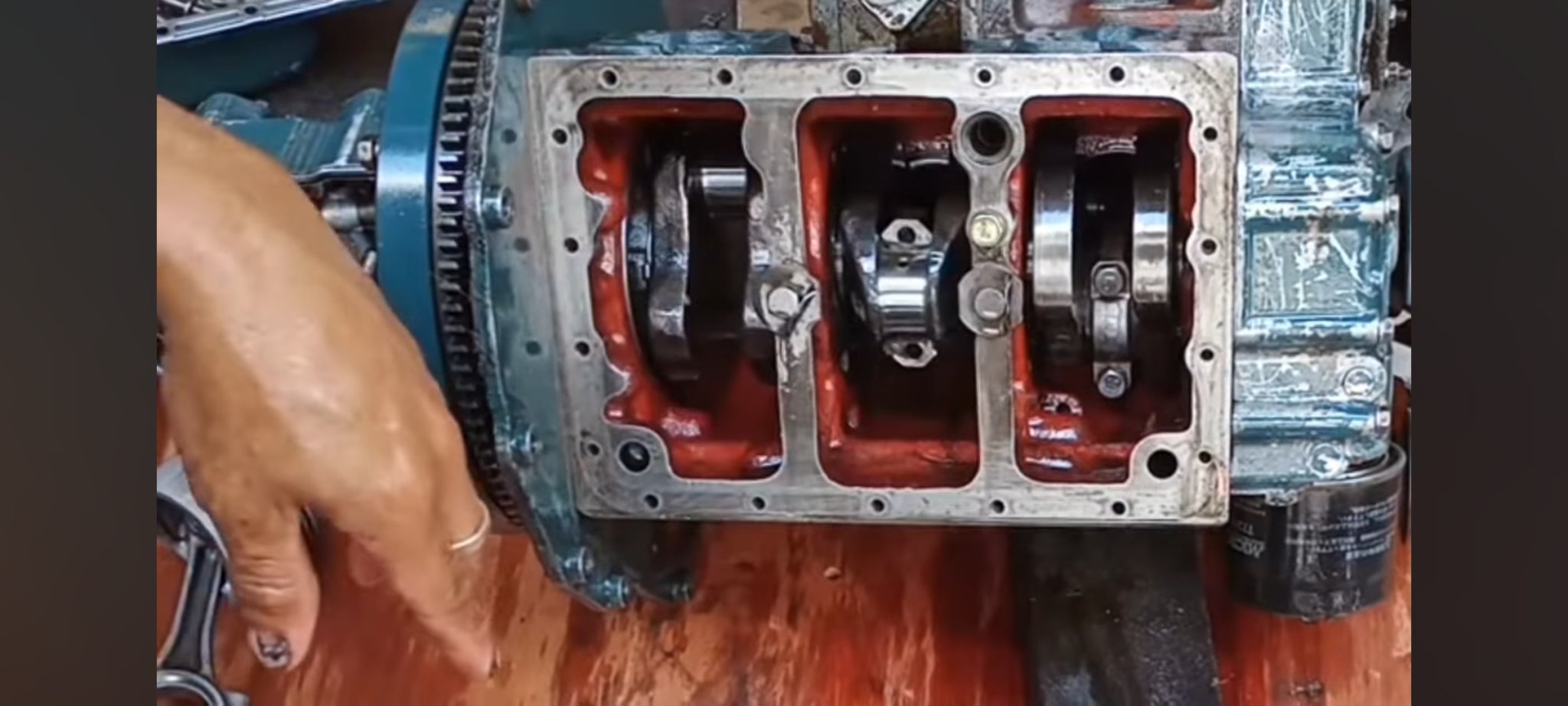

Some photos from before reassembly in case they have any clues:

There is a cam plug on the backside also, I'm quite sure.
Yes confirmed that plug is in as well, and had taken some photos during rebuild where we can see the back of the cam, added to original post. I wish it was something simple like that!

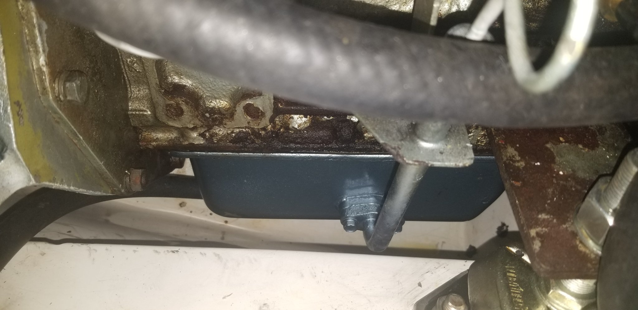

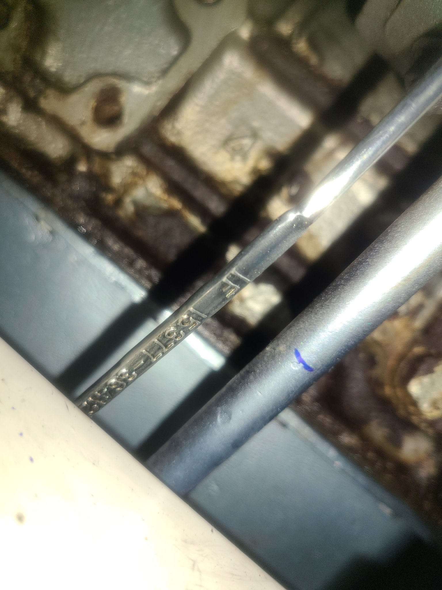

Continuing from JohnDB's tips, i took the dipstick and marked the tube on the outside approx where the full line is when dipstick is seated, and its definitely above the top of the pan...and the crank counterweights on this engine come to within about an inch of the top of the pan if I recall...it could be churning in the oil, Im going to bring down the oil level to half way between F and E on the dipstick and see if any difference. Wouldnt it be nice if it was that simple...i somehow doubt it lol, but desperate at this point!

... i took the dipstick and marked the tube on the outside approx where the full line is when dipstick is seated, and its definitely above the top of the pan...and the crank counterweights on this engine come to within about an inch of the top of the pan if I recall...it could be churning in the oil, Im going to bring down the oil level to half way between F and E on the dipstick and see if any difference. Wouldnt it be nice if it was that simple...i somehow doubt it lol, but desperate at this point!
That oil level looks way too high for my liking. If you lower it, need to ensure it doesn't compromise the oil pickup from the sump when the boat is operating (motion from waves etc).
