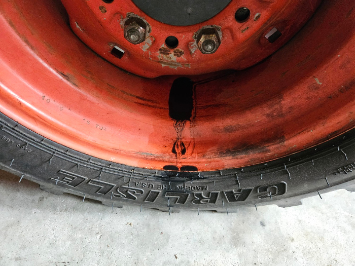

Is this from a worn-out axle seal? Are they a pain in the butt to replace? Thanks.

Clean and recheck to see EXACTLY where it is seeping from. Baby powder sprinkled on after a time tells the tale.

I believe it's a bad seal and/or bearing. I topped it off so I could work today. The job doesn't look too tough.
6,288
3,629
Bevel Case seal takes about 2-3 hrs if you‘ve got the parts, and don’t make the mistake I made first time. (Remove ALL the old seal or you’ll end up doing it twice.) BTDT

Usually, if it is leaking onto the wheel, it is the axle shaft seal.
Remove the wheel, remove the cover bolts, and pull the cover off.
Pull the inner axle shaft bearing and lift off the gear.
Two C-shaped collars will appear, which can now be removed.
Push the axle shaft through the bearing and seal.
The seal is also a 2-piece, and the sleeve will probably still be on the axle shaft.
Check the cover, bearings, and shaft.
Reassembly is self-explanatory.

Looks like your lugnuts are on backwards too. Bevel end faces the rim.....

Thanks for all the help. Before I get into this, is there any difference between 4WD and 2WD? I have 4WD with a mid PTO.
The taper facing the rim only applies if the rim holes are tapered.
If the rim holes are flat, the wheel nuts are on correctly.
The grand L10 series use lug-centric front wheel with tapered holes. The exception is a model with a 5-15 front rim. that is a hub-centric setup that requires the lug nut be reversed and a lock washer installed. This is straight from the manual....
