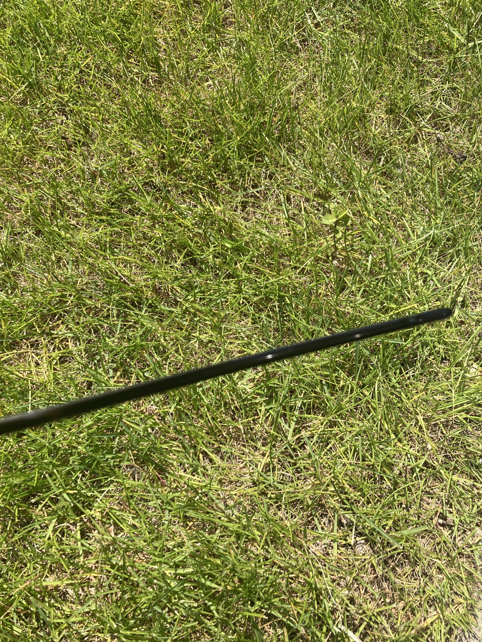

Just so you have a reference, this is a pic of my trucks dipstick. 5.9l Cummins with 280K
I changed the oil 3 days ago, so it's got about 30 miles on it, and its "blacker than the Ace of Spades."
As the others have pointed out, it's perfectly normal.
