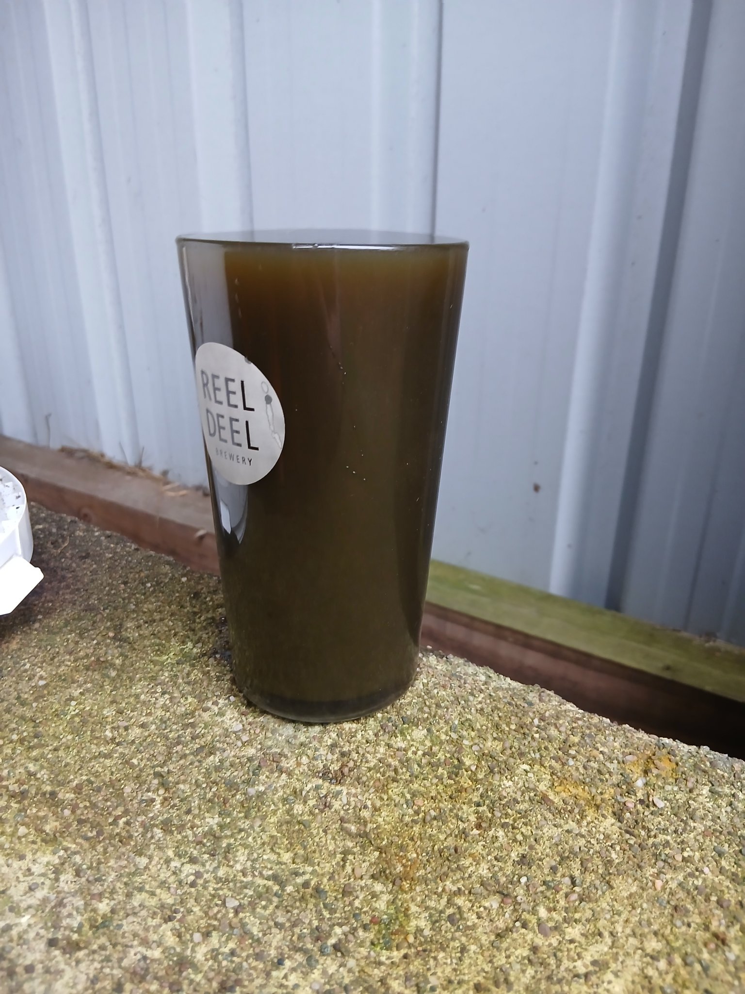

Hi Guys,
Just what it says. The brakes are making a horrible noise when applied. It happened suddenly. Would they wear out like that? Is it a big job to replace them? I have never worked on wet brakes before. Found a YouTube video belonging to someone else
Kubota L3450 DT GST
Thanks
