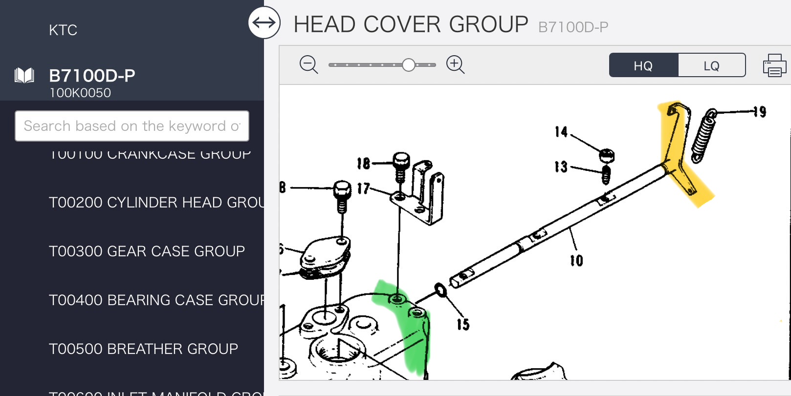

I believe that engine has a decompression system that allows the engine to crank easily. That may be the issue (if you are lucky).
See the parts diagram below and look at the front of the valve cover (green highlight) for a lever (yellow highlight). There should be a cable running from the lever to the dash to a pull/push knob. Move the lever and see if it moves freely, if not then shoot some penetrating oil on the rod that enters the valve cover to get it moving well. Push the ever all the way towards where the spring would pull it (clockwise from sitting in the seat (I think).
If you removed the valve cover then this is not the problem.
