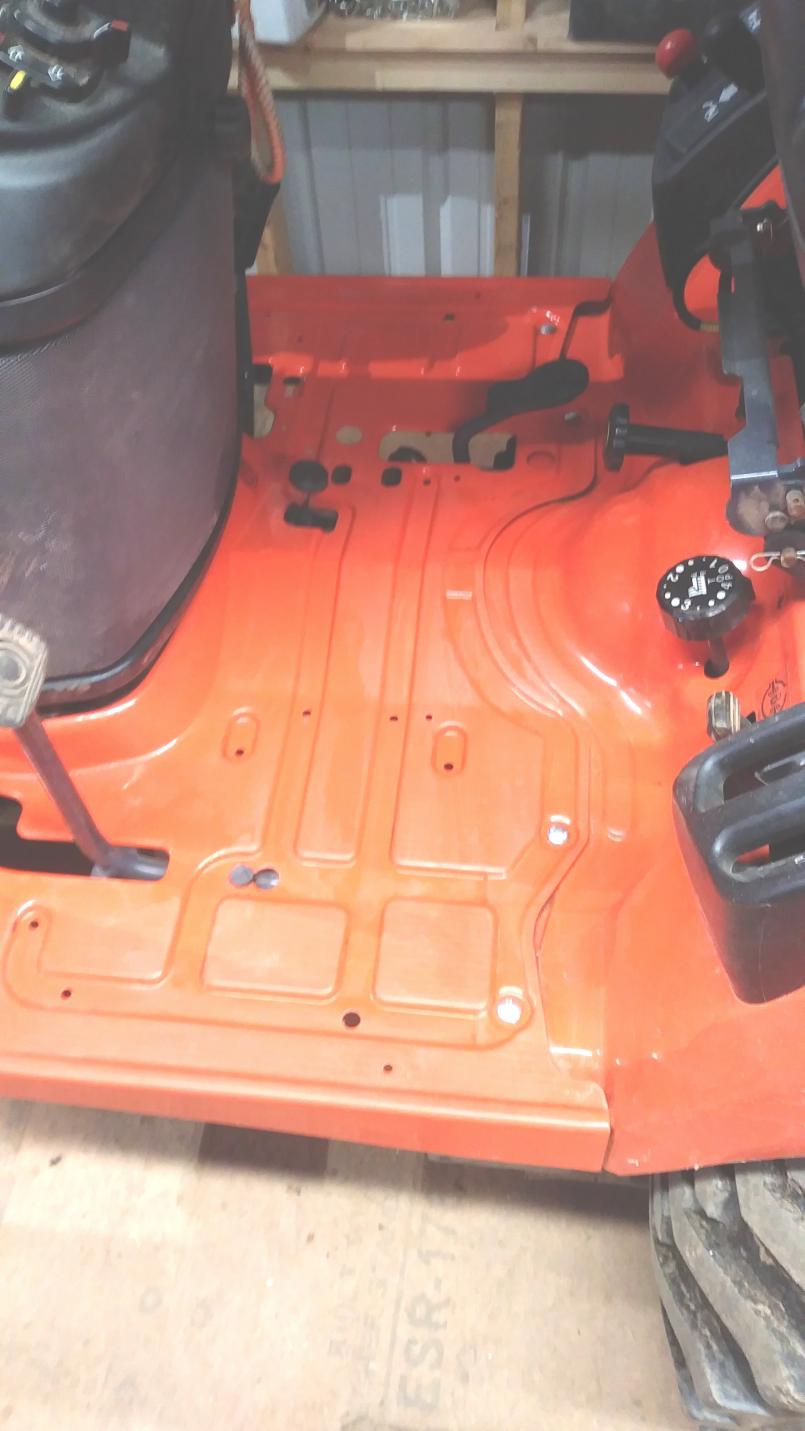

OK guys......you convinced me! I went ahead and ordered the "new" thicker mat from Coleman's , about 80 bucks shipped, ordered the plastic rivots too.
And I think the idea of spraying a "liner" before the mat is a good idea too.
Next question......after the 5 minutes of taking the old mat off, and the 45 minutes of cleaning the dirt and whatnot from UNDER the old mat......should I block off the multiple holes BEFORE I spray???
I know all of these holes allow for the deck to come off and other holes are for water exit too - however, the amount of dirt that comes UP through these holes is tremendous. The brake pedal only needs about 1/3" of the opening to function. The HST side also has a long opening. All of these openings could be closed up quite a bit. I do realize IF THE floor panel needed to come off, all of these openings would need to be made larger again.
Even if something like "tape" was used to enclose the holes, then sprayed over - the tape could be removed later if need be.
What thoughts do ya'll have - I think a can of "bed liner" type sprayed down then place the new mat over.

I would put the new mat on the pan the way it is. I don't think "do it yourself" bed liner will make a difference. Reducing the openings with some kind of tape may help keep it some dirt out.

I think I would just do the mat only. But years ago I did a roll on bed liner for my truck. On the tailgate used the assorted circle felt pads(used for cabinets) to put over the screw heads in case I needed to get them at a later date. They worked out great.
