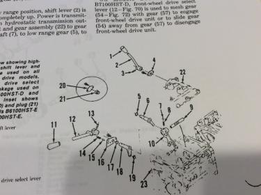

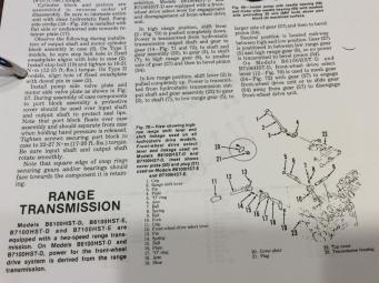

I think your instinct is right - it is time to pull the cover plate off the “range transmission”. This has the high/low and front wheel engagement gearing. The control levers for each are on the right side and there are 6 bolts on the top.
Of course I haven’t done this so get a WSM and take photos so we can all learn.;)

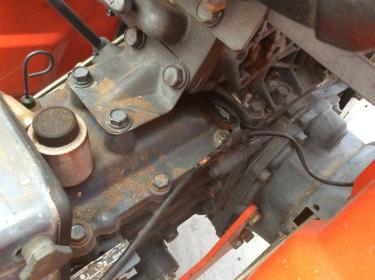

so I’m getting ready to split the tractor or atleast pull it partially apart because the I guess you could call it the bellhousing? The formed metal housing which the HST is inside off. Is blocking the front two bolts to take the top cover for the range transmission off. It looks like it has two big bolts on either side and two nuts on the top which go to studs on the cover for the range transmission. It’s hard to really see on the WSM what part of the linkage could be the issue since they are so old and the pictures aren’t super clear. So I’m hoping I don’t have to remove everything like I’m fully splitting the tractor I would love to just be able to pull it apart just enough to access the bolts to remove the cover. Going to need to unbolt the rear of the loader frame underneath,suction’s lines, and a couple linkages for brakes. Also the front driveshaft I think and maybe the input for the HST from the clutch.

Torch linked the actual Kubota WSM. Much better than the one I have.

So I got the thing apart enough today, heres what I found.
(Bad pic links removed look at future post for pics)
So the Fork is snapped, gears still slide nice into low and high range by hand. So good news is thats the issue and the Hydronic trans is good! So going to order the stuff Monday. Just need to make sure I order everything I need. Looks like kubota shows a updated PN for the fork I wonder if this was found to be a part that had a lot of issues so new ones stronger? Anyways so far I have the PN for the fork/top cover gasket/ball and spring for the shaft. Anything else I should do while I have it open?
Looks like the shaft for the shift fork needs to come out the back of the trans so thats a bummer that ill have to take that off.
