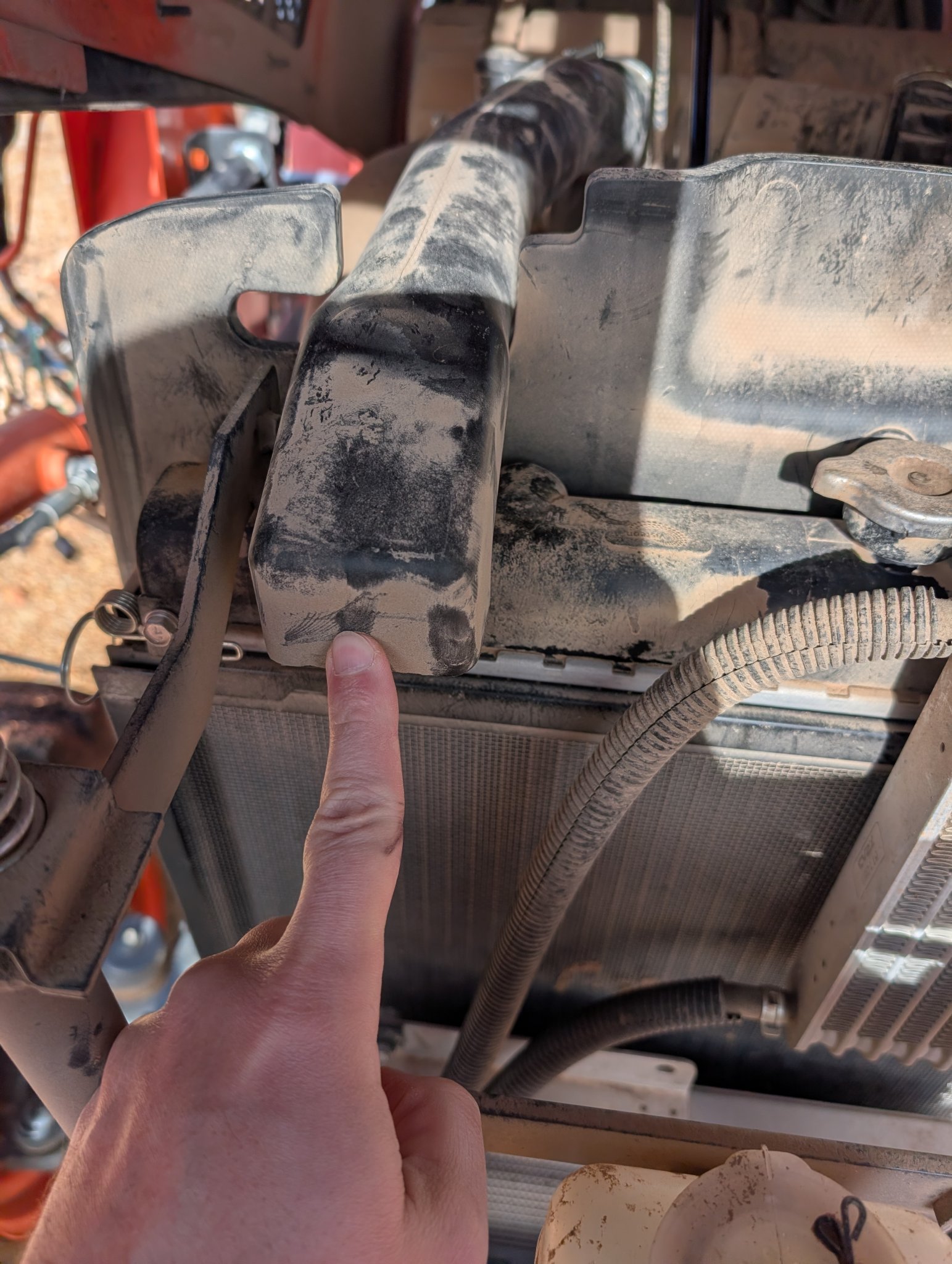

That hose being off wouldn't hurt the turbo or engine because it's air before the filter.

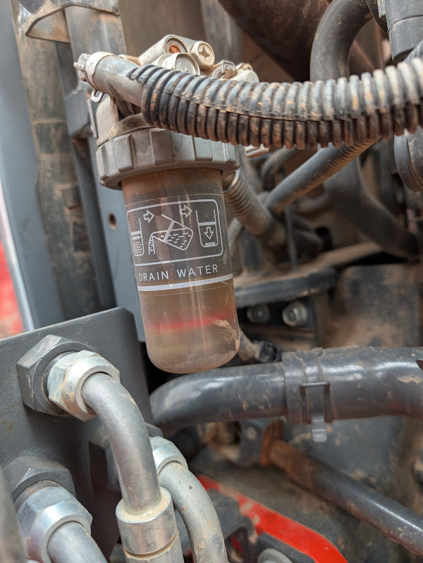

The upside down gauge does not matter, it's not a water trap, it's a vacuum gauge and nothing more.

That extra intake hose is odd. I don't have that on the MX so not sure why the L6060 has it. Clearly rodents aren't getting to the turbo from the inlet or exhaust side. The DPF really attenuates turbo sound, which is very apparent when you run a straight pipe from the turbo back.
