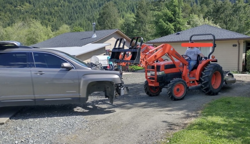

Look at the total weights of the PF assembly. That detracts from your lift capacity. I even remove the forks and rig rocks directly to the PF frame in order to increase my lift.
I got the EA PFs for the same price you can get the LP forks, delivered within driving distance. They were the lightest PFs I could find with one of the best fork ratings.
Like this?
Boulder, 1/2 of a Chevy Equinox, about the same thing.
