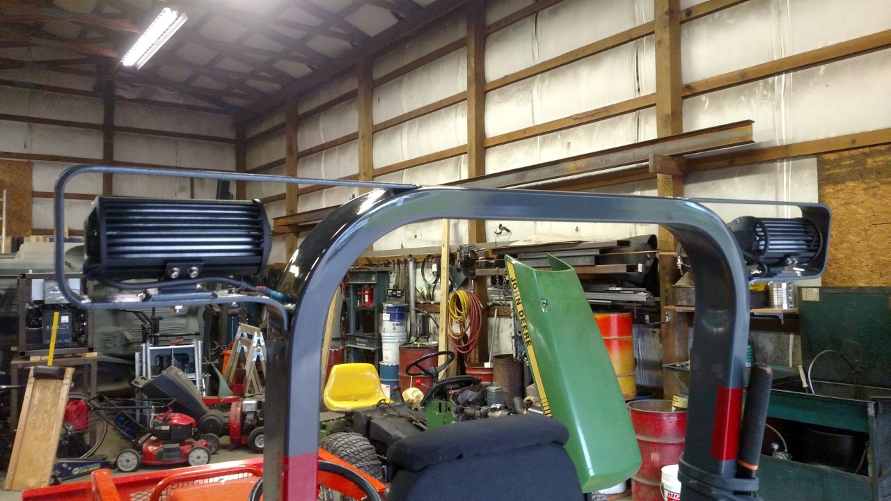

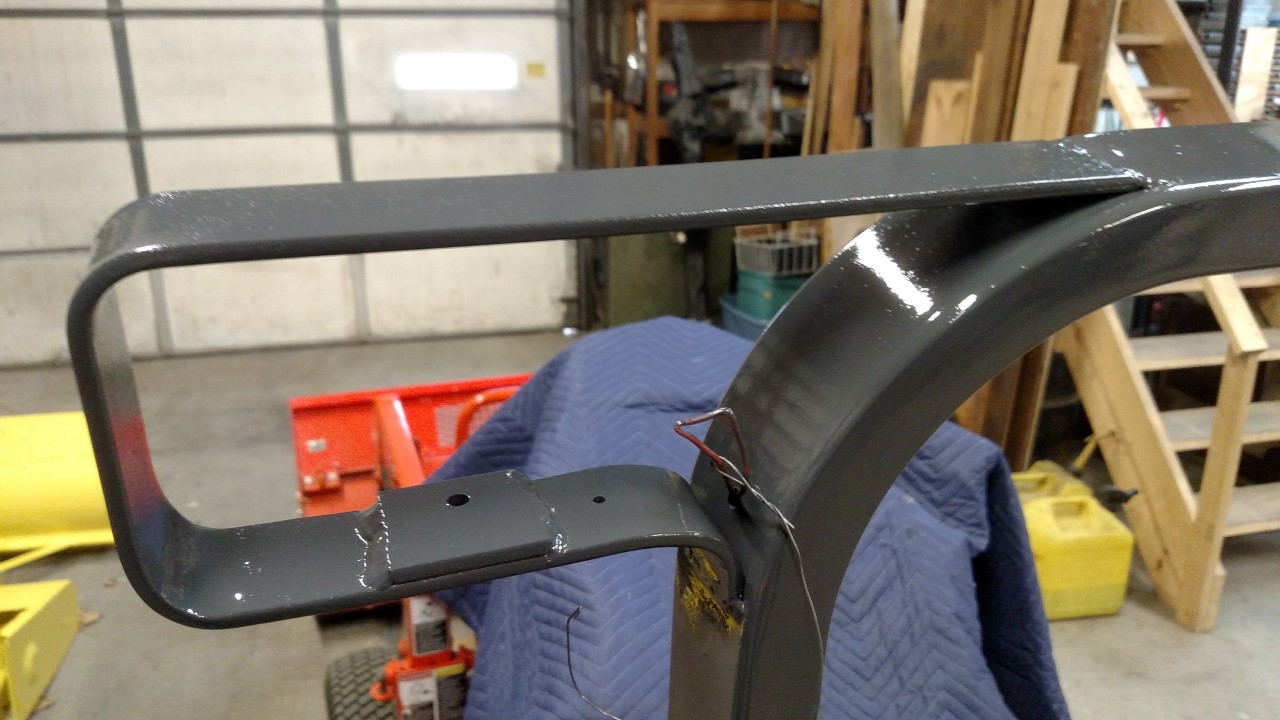

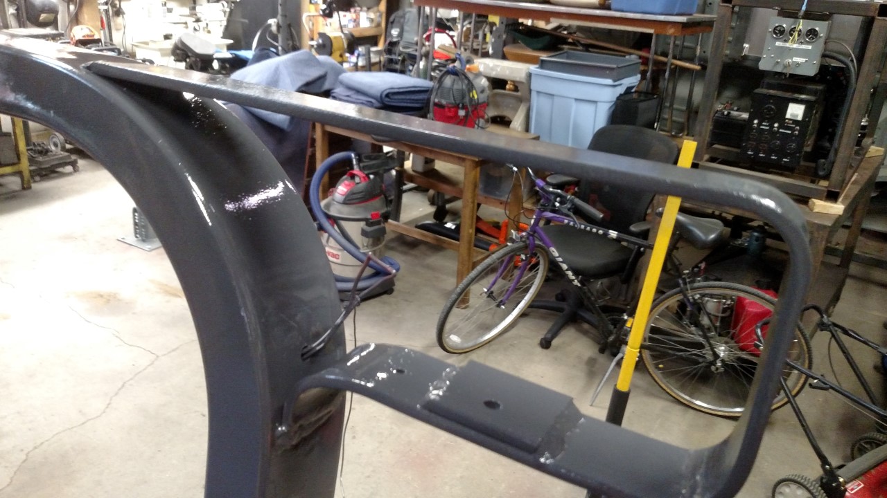

I finally took the time to fabricate and install mounts for a pair of LED lights I have had for over a year. I used my metal bender to bend some 2" X 1/4" strap to the shape I wanted, trimmed it to fit and (GASP) welded it to the ROPS. I drilled holes and fished a 16ga. wire across the top to the other light, then down to the bottom hole, using my fiber optic camera to locate the wire in the tube and help fish it out through the holes. Brought a wire plugged into the aux light wire over to the left rear corner and put a metric-pack connector on it and the wire to the lights. Made a mating pigtail and ran it up to the plastic quadrant for the PTO levers, and cut a hole for a snap in rocker switch. Hooked it up and it worked fine.
I'll have plenty of light for any work after dark now.
I'll have plenty of light for any work after dark now. View attachment 49585 View attachment 49586 View attachment 49587 View attachment 49588 View attachment 49589
