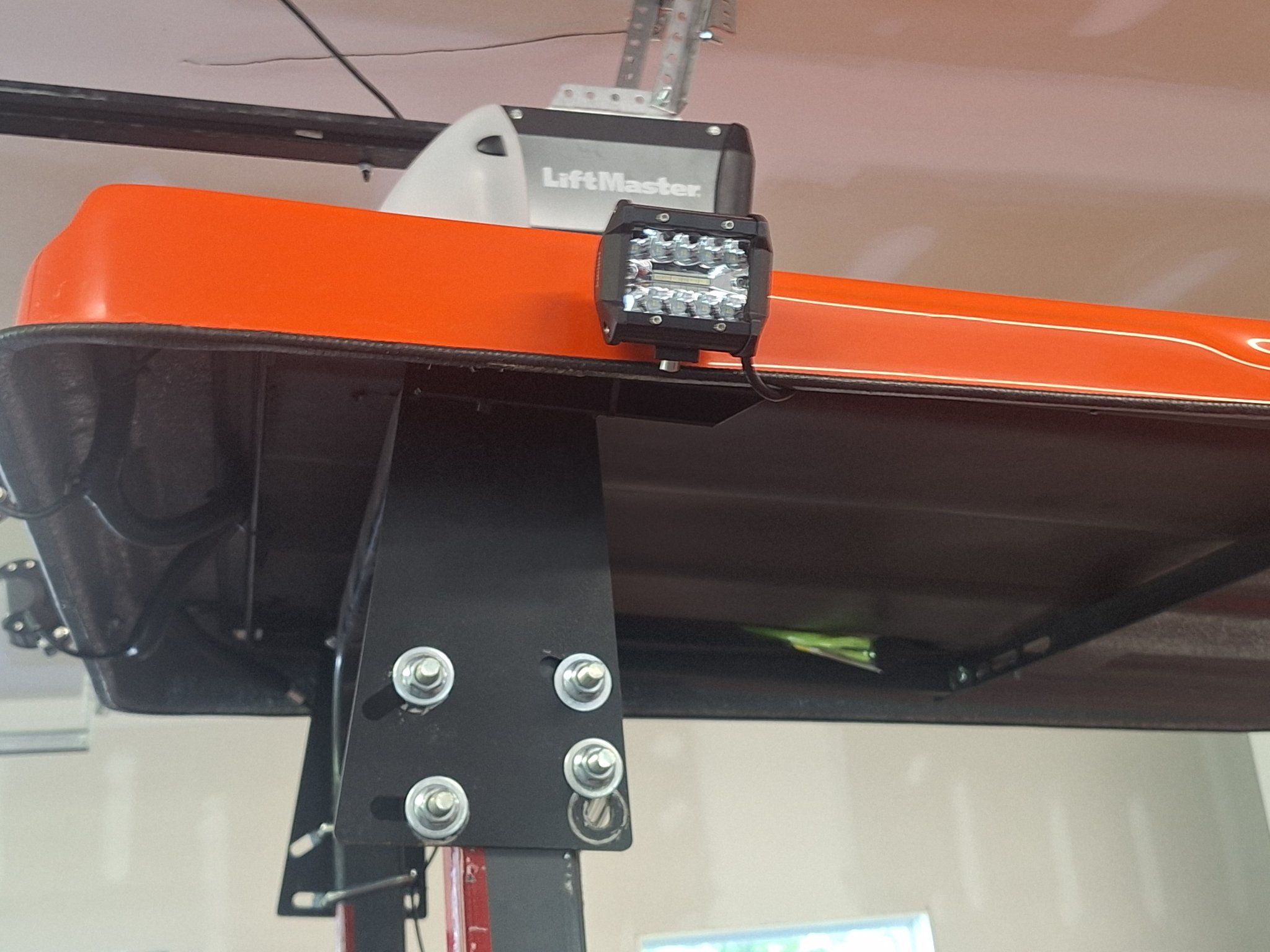

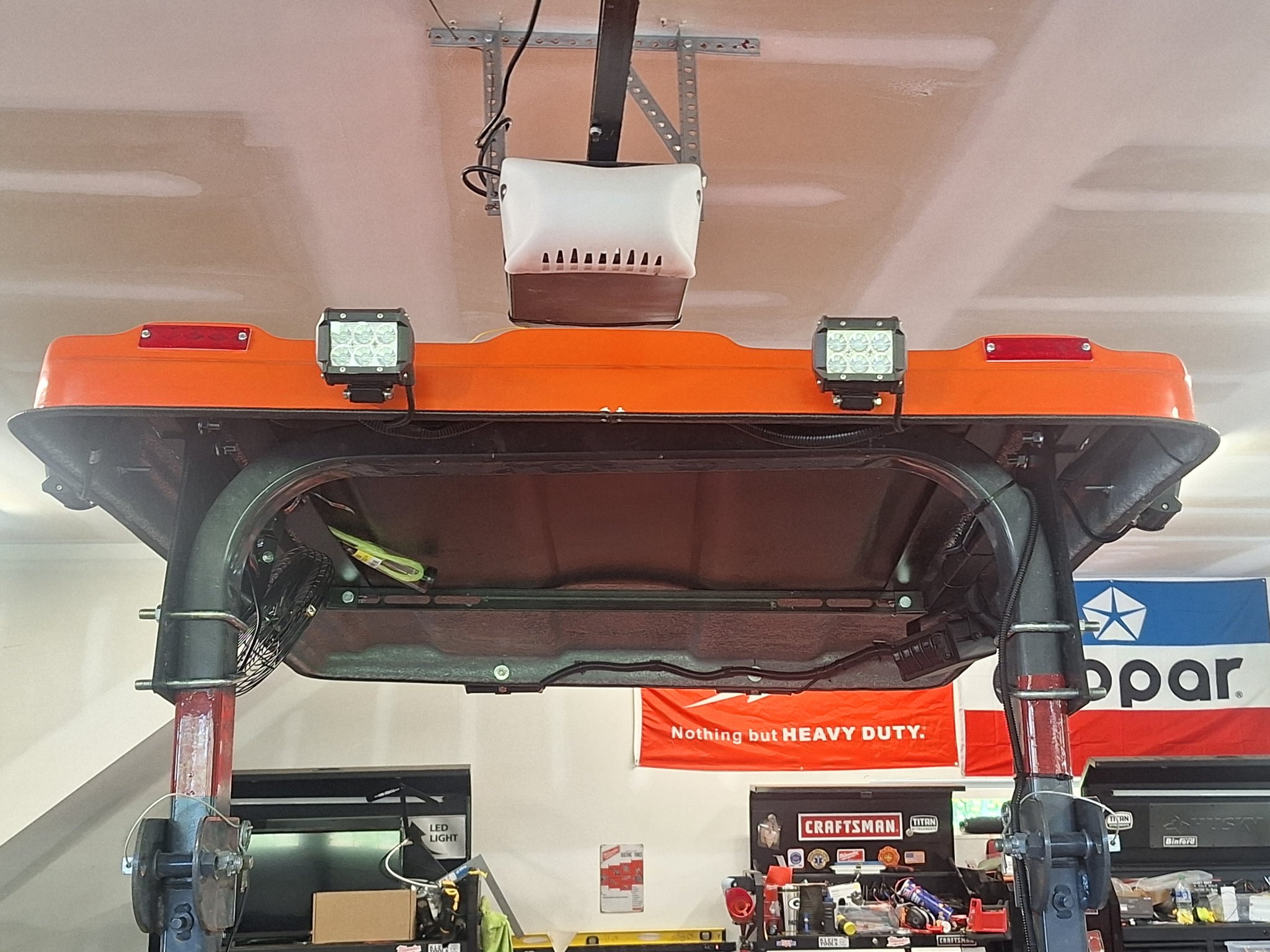

New lights and fan on top.
Carson398
L2501 with a LA525 loader, bushhog, finish mower, debris forks, quick hitch
Jun 19, 2023
Mechanicsville Va

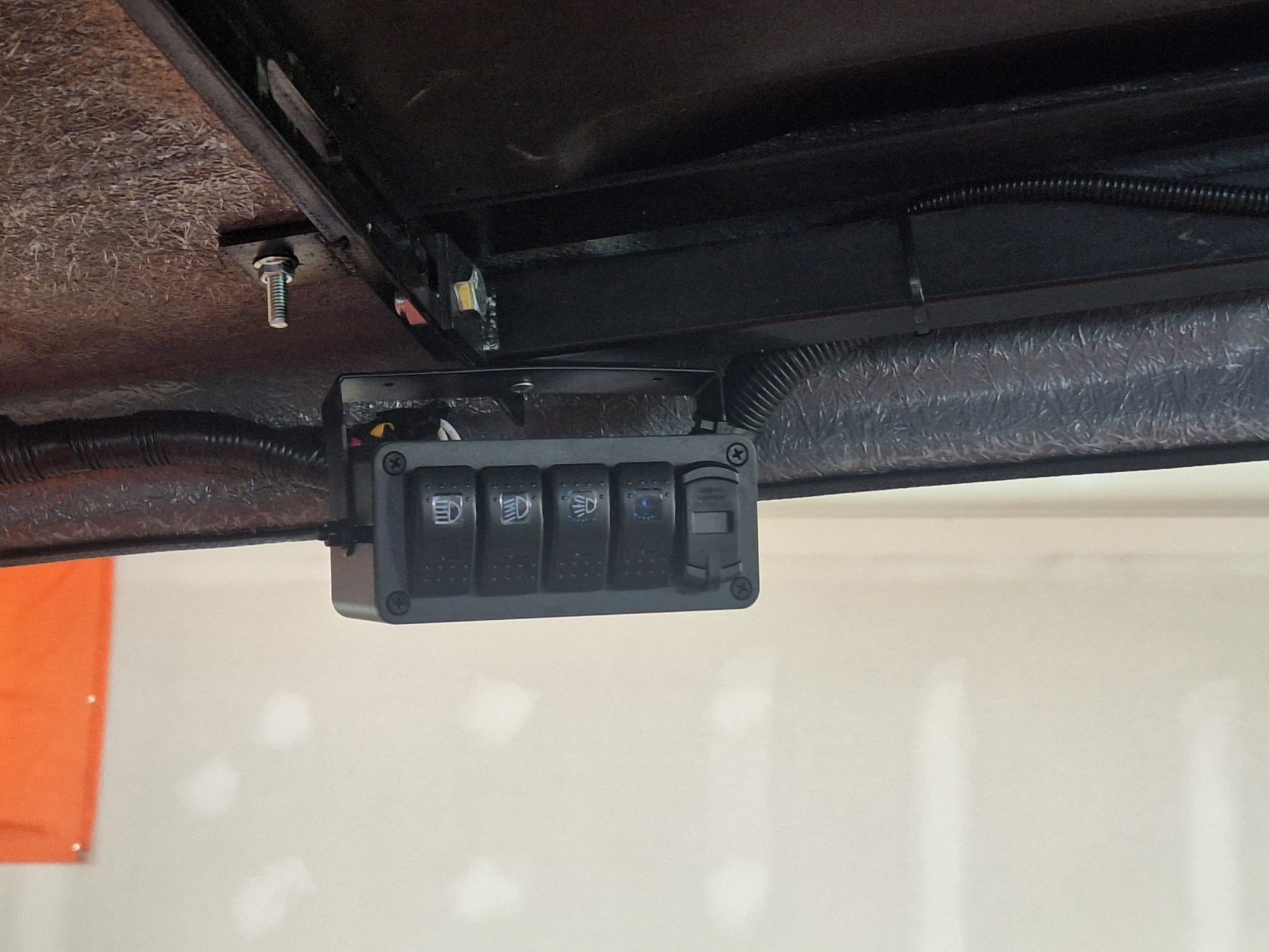

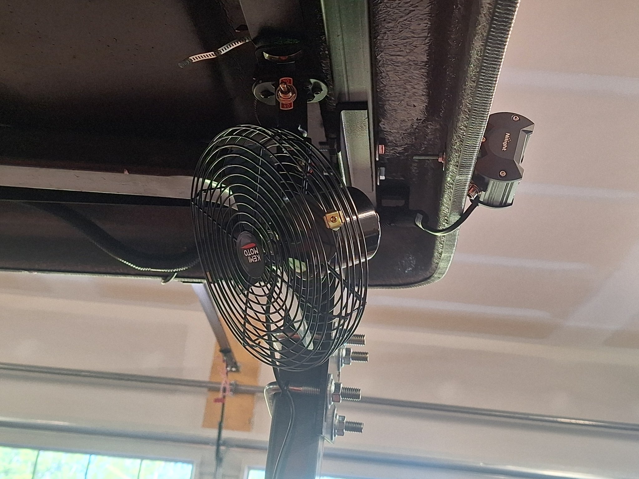

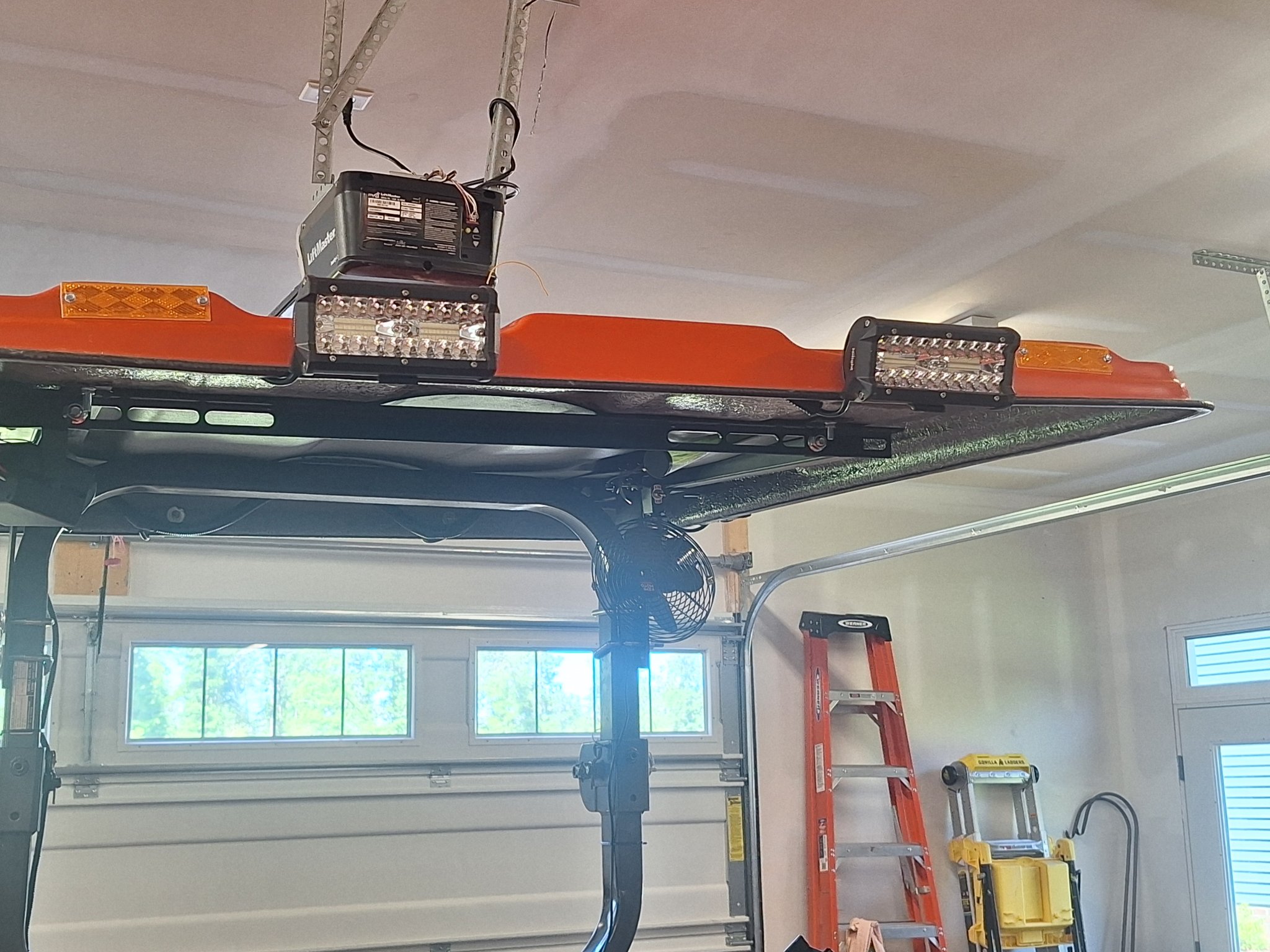

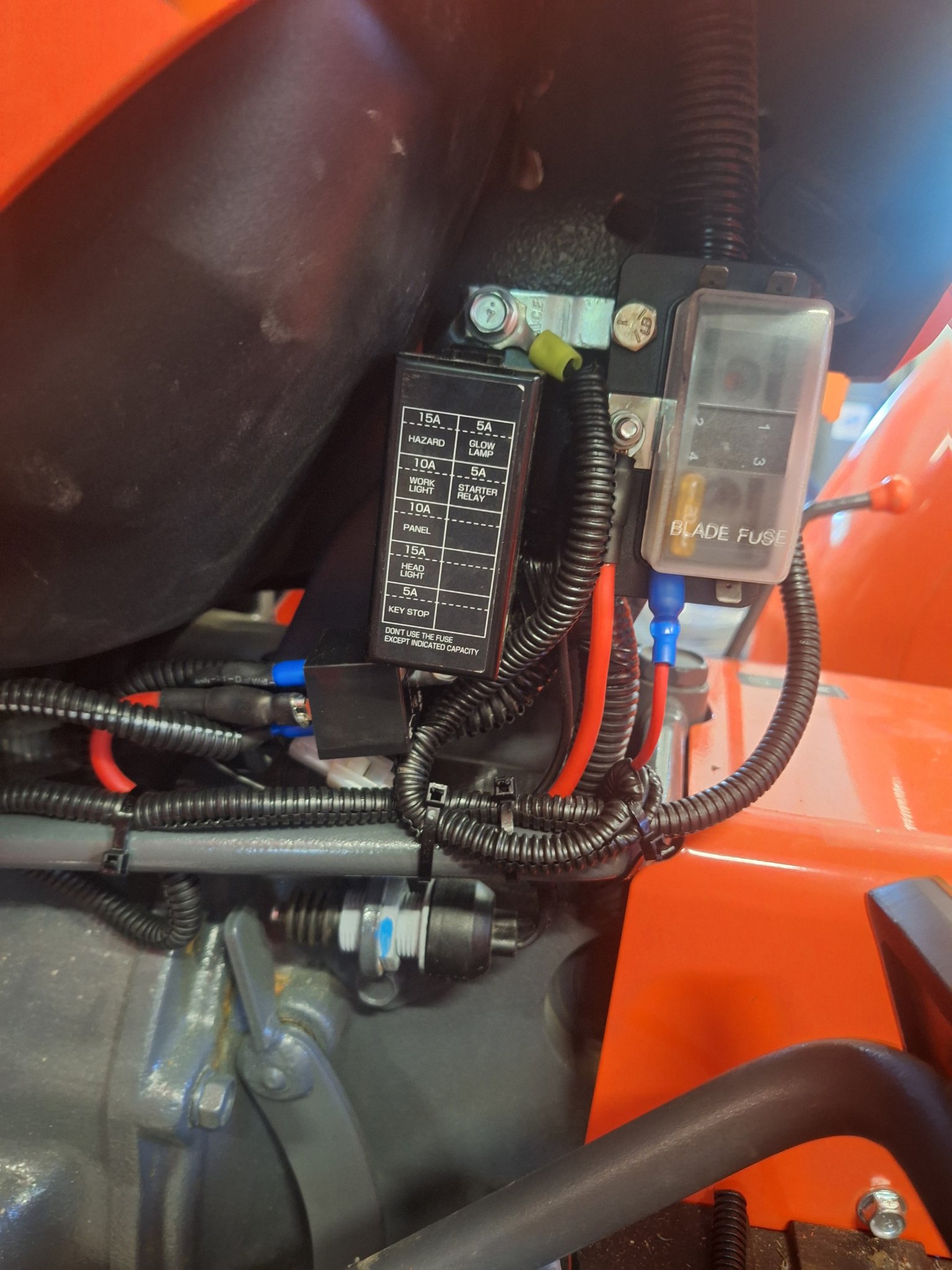

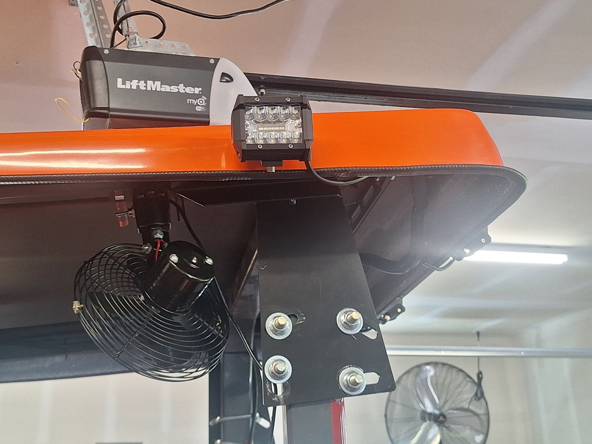

I installed new light made by Nilight with one of their switch boxes. I also installed a fan, I ran it's power from the work light plug. I ran power for the lights though a relay directly from the battery and installed a new fuse block. Relay is turned on by the ignition. Next I am going to put hazard light in my canopy.

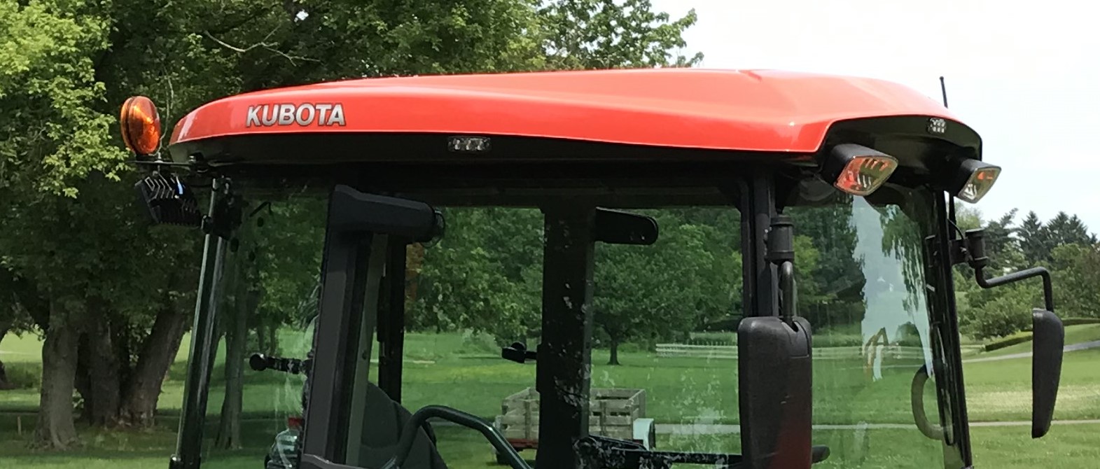

Sounds a little like my approach. Picked up some of these small amber LED's at The Trailer Shoppe in Ephrata PA. They're surface mount with the wiring going out off the back side and make a clean installation. These have several different flash patterns. I have one each on the left, front and right sides and three on the rear. When I wired them I programmed the center one in the rear to make its pattern out of synch with the rest.
These are bright for their small size. When I drive the tractor to town on Winter nights to clear snow at the church, the side blinkers light up the houses as I pass them.
This pic is from a while back when the 4240 still had the front factory work lights.
