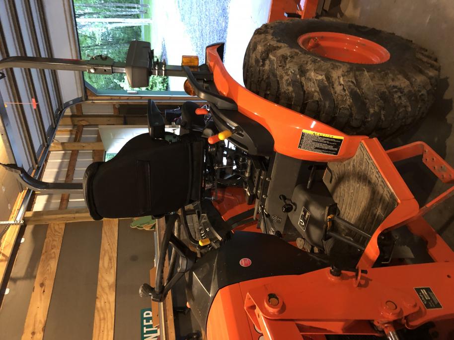

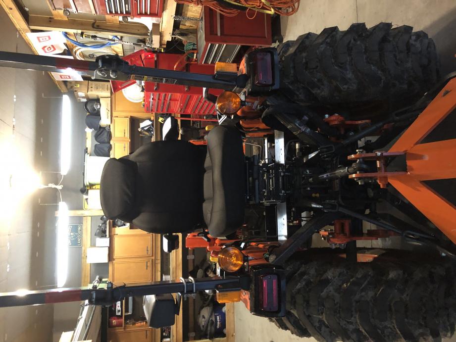

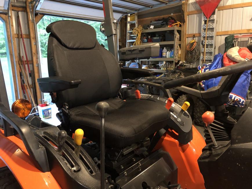

Got the seat installed last night. I had to just drill another hole in the flip bracket on the tractor to get it installed. I did not use any of the brackets that came with the seat. I may revisit the seat mount at a later date when I have some idle time.
My first impression is that it's a pretty nice seat. However, it does sit a bit higher than the stock seat, and it's a little more forward. If you have long legs, it may not be the best fit for you.
I'll try it for a while, but will be hanging on to my original seat as well.

Super great review. Please keep us informed on how you feel with further use.
