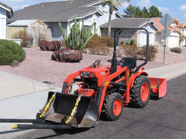

The B219 came with the 2 lever, 2 spool Cessna valve as shown in one of my pics. Because the valve is no longer made, people assume that it is not rebuildable, so many have been converted to single lever valves. (I've thought about it myself, I like the single lever setup.)
The tag on mine had been painted over also, but I used a graffiti remover solution to carefully clean mine, looks like new. The only thing interesting is the serial number, but the company has been out of business for decades, so there is no support from them anyway.

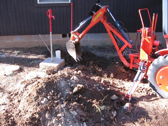

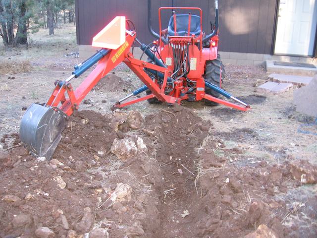

Yeah, I got pretty lucky when it comes to implements. Backhoe worked when I got it, but leaked everywhere & had a lot of play. Rebuild thread:
http://www.orangetractortalks.com/forums/showthread.php?t=5482&highlight=b670
The cylinders on the FEL need rebuilding next, I've done the hoses & control valve, but I'm trying to get through a major driveway project before I take it out of service.
