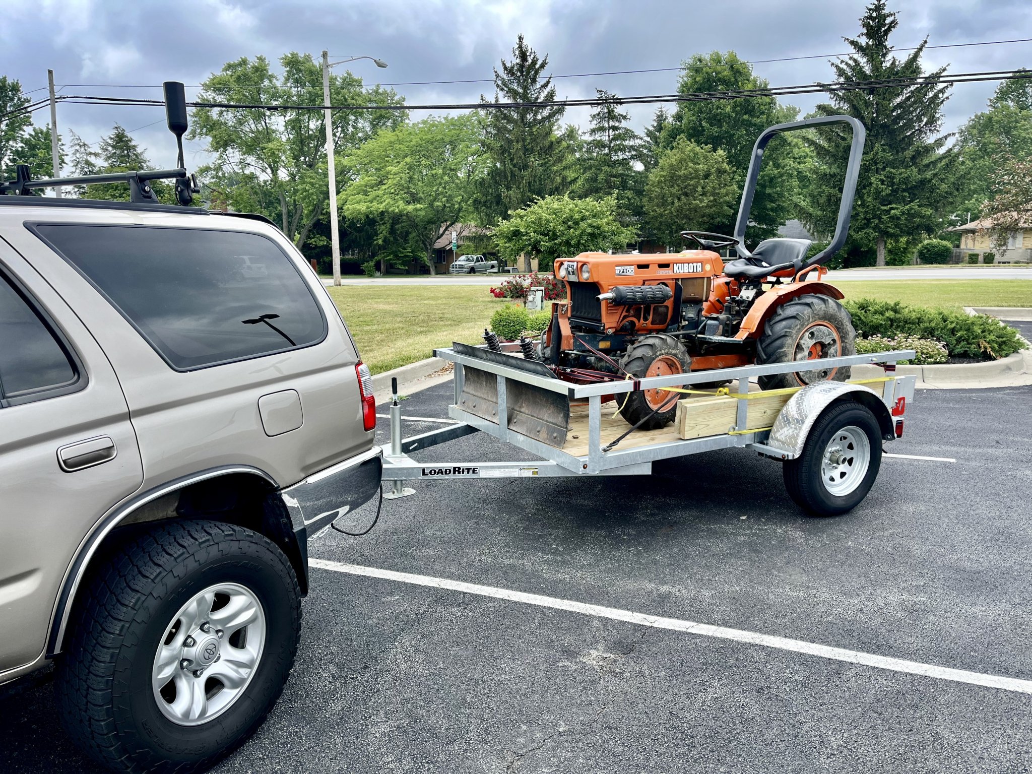

This is my first post on OTT. I recently purchased a 700+ hour '79 B7100 that came with the two-way front blade, a newer Kubota ROPS, and original Goodyear ag tires.
I have been assembling everything I need to completely go through the tractor. The factory front blade & subframe are coming off as the tractor will only be used for mowing. To that end, I found three old 55-lb suitcase weights and purchased a new rear mower.

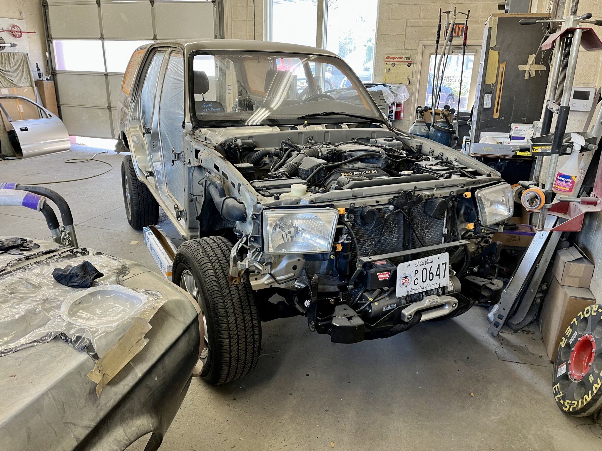

It was gone at a bodyshop in PA for three months at the end of the year to have the rear wheel openings cut out, new metal formed, dents & dings removed,, followed by a glass-out respray. I stripped the truck and drove it there, far from road legal. :)
Rust is what tends to sideline these things. Thankfully my frame is sound - I've hosed it down with Fluid Film for years.
