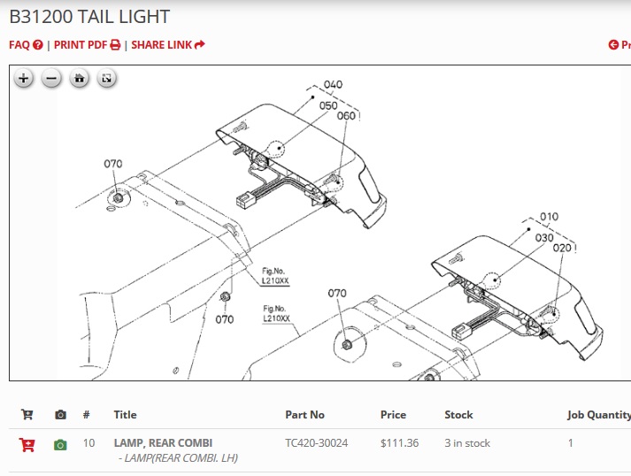

Need a part # & recommended supplier(s). Broke left side - lens only. Tks
There are three models of MX5200.
I only looked at the parts for a MX5200 DT
The entire lamp is sold as a complete assembly only. The only parts sold separately are the bulbs.
The light hand one is TC420-30024 for $111.36
This photo is of the RH lamp.

The info is from Messicks web site.

I looked on eBay.com with no luck either for a lens or complete lamp assembly..
Did this this elsewhere for $53:
LH lamp
Remember there are three different models of your tractor and the part number I provided is not verified for all of the models just one.
