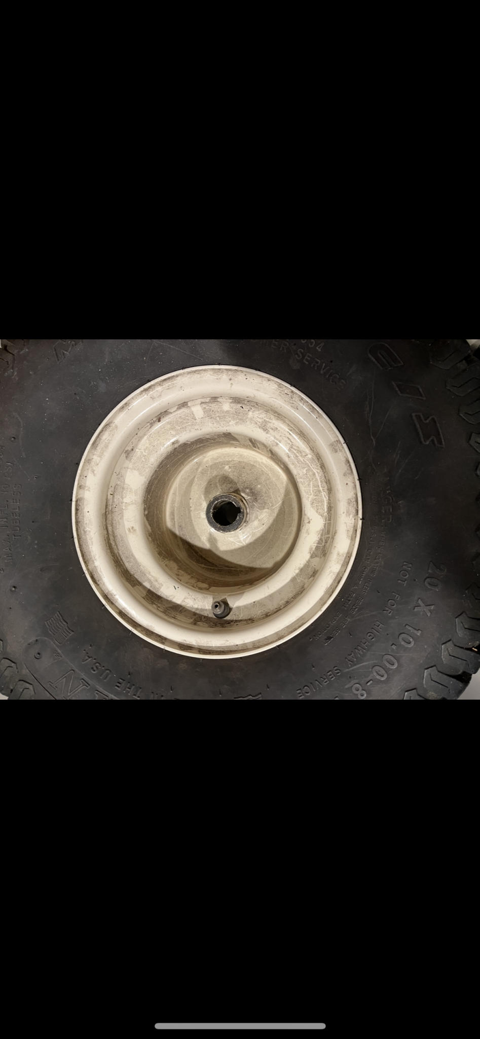

I am a new member-my first post, but have read posts in the past. Original owner of a Kubota T1560a with 40” deck. Oil, oil filter, fuel filter, air filter replacement each year, replaced the large deck belt & blades both 1X, and sharpen the blades each year. Use it about 15 hours per year; kept in a shed. We planted some Raspberry bushes a few years ago…great berries….but they spread like weeds…and the thorns puncture the 20”x10”-8” OEM Titan Multi Trac C/S 2-Ply rear tires. I tried to patch it with a tire ‘plug’ kit…first time it worked well, but second time have a very slow leak.

2. The tires treads seem OK, obviously the tires are ~25 years old. Was thinking about putting tubes in the tubeless tires… but then thought about the configuration of typical tube & valves-slightly offset at best. (Tires are 20”x10”-8”) would a JS2 valve (hand bendable schrader valve) be needed or use a typical schrader valve?
If regular valve, one with a metal nut to hold the valve in place?
Will a rubber grommet be needed too? (Existing has a tubeless valve stem).
The only JS2 valve tube(1” valve offset; 1.3” long valve) I found is a 20” x 8“-10” to 20” x 10”-10” Firestone lawn tube #551-252.…will this fit a 8” rim—-or will it be too big?
Suggestions for tubes?

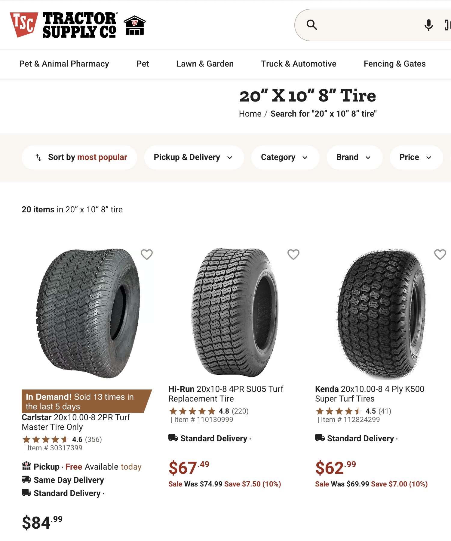

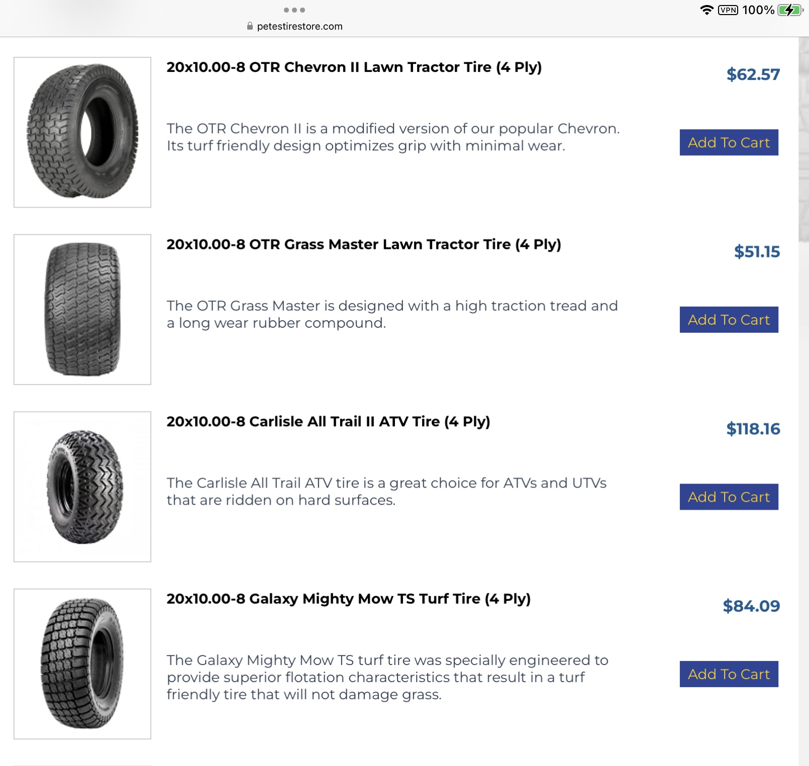

4. Tire suggestion (If I need to replace…). Any large difference between ‘generic’ imported tires and Carlisle branded tires (‘if they are made in the US, that would be a plus to me).
Difference between 2 ply and 4 ply…guessing the more the ply #, the tougher and stronger the tire (and harsher ride)?
Any suggestions for tires?
Suppliers?
****does increasing the ply #, from 2 ply to 4 ply, make installing the tire MUCH more difficult? I did buy a HF mini tire changer gizmo, and 2 long HF tire levers…have not taken it out of the box yet. Have viewed many online videos on using it…many cons…some pros—sturdy mounting seems to help in successful use.
