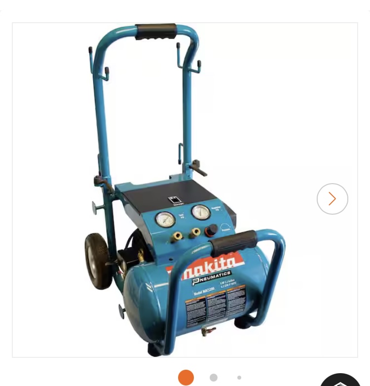

Two years ago I bought a Makita air compressor for use in my woodshop and it powers everything I have extremely well…I’m not sure what the price is today but was a tad bit under $300.00 two years ago. It’s quiet ( for a compressor) has a quick cycle time and is portable; I bring every where I need it. It powers all of my nailers, my wand to clean out my radiator fins on my Kubota, fills tires and works extremely well on my 3” orbital sander that I use to finish bowls i turn on my lathe.

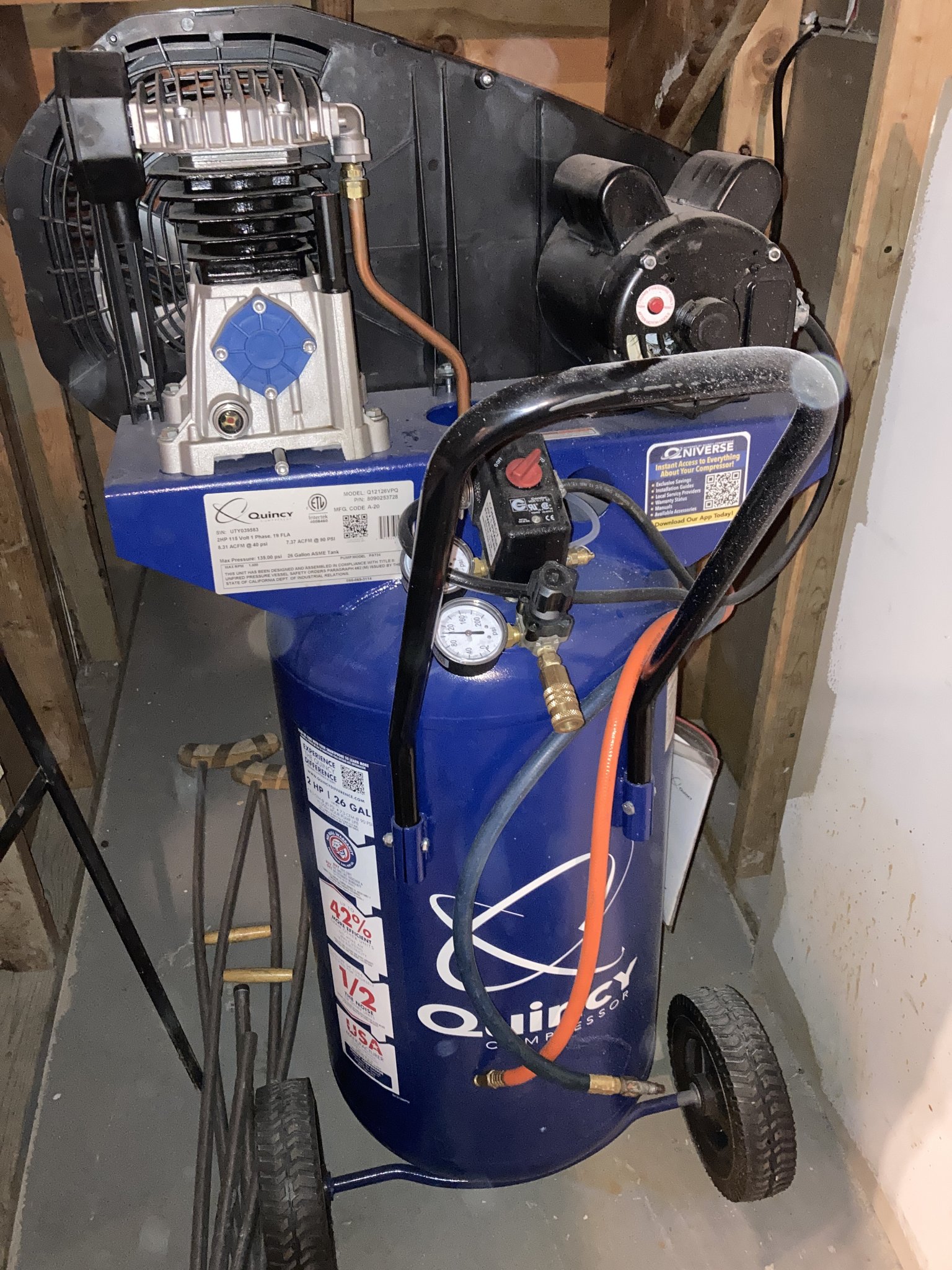

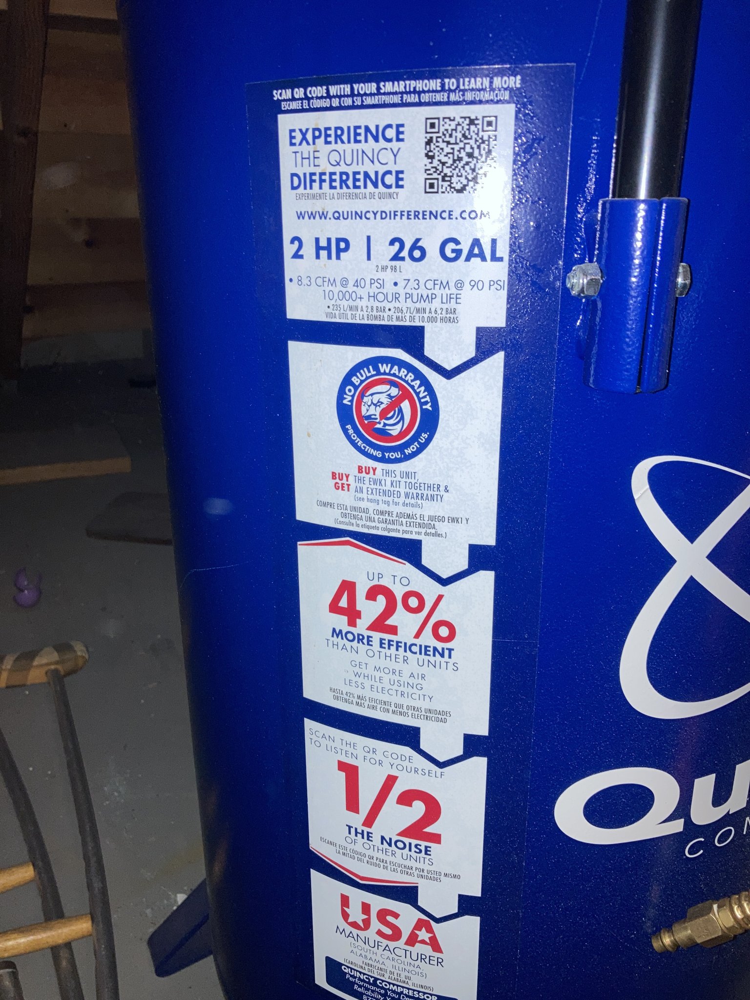

I purchased a Quincy QT5 220-volt over 30 years ago, and it is still running strong. If you only need it occasionally, then any of the inexpensive units will last you a very long time. If you plan to use it every day, consider investing in a higher-quality unit that will last you for the rest of your life and beyond. Leave it to someone deserving in your will.
