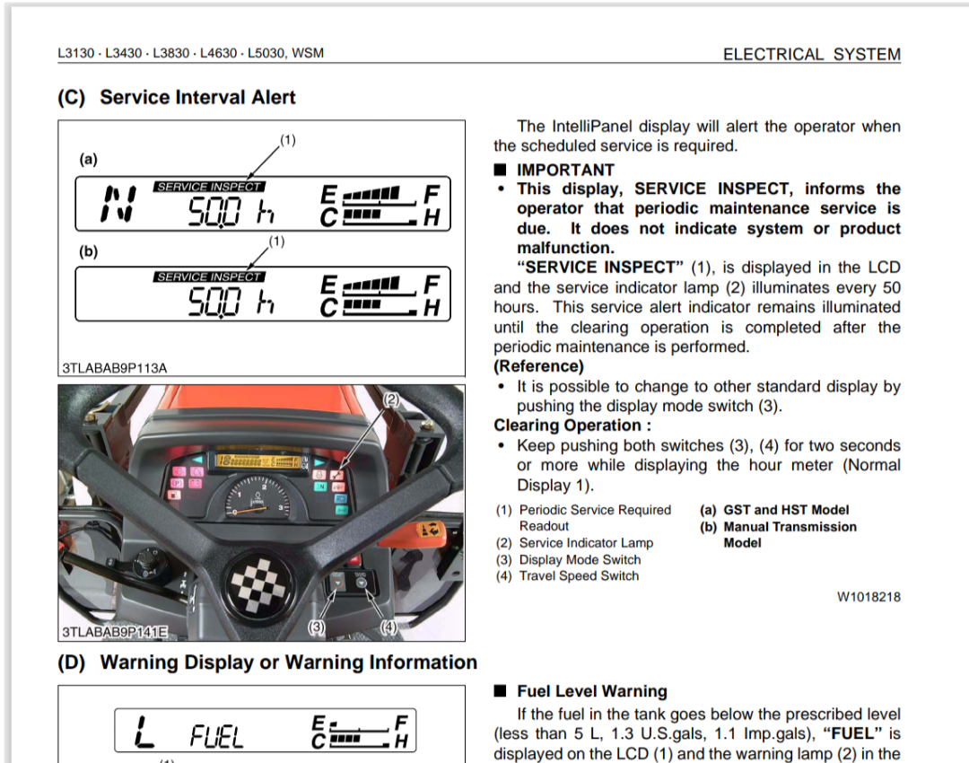

My service light came on so I guess it's a routine service. You're right I can do simple stuff like that so I just need to find what's included and order the parts. Thanks for pushing me in that direction. I used to would have found out exactly what I needed to do and jumped on it w/o a second thought but as I've gotten older I've lost my motivation. I hate that about myself.
