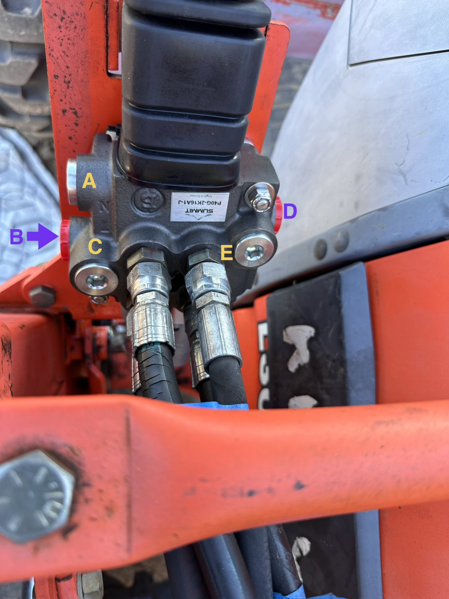

I am attaching a photo of the new Summit Control Valve with the available ports labeled A,B,C,D,E.

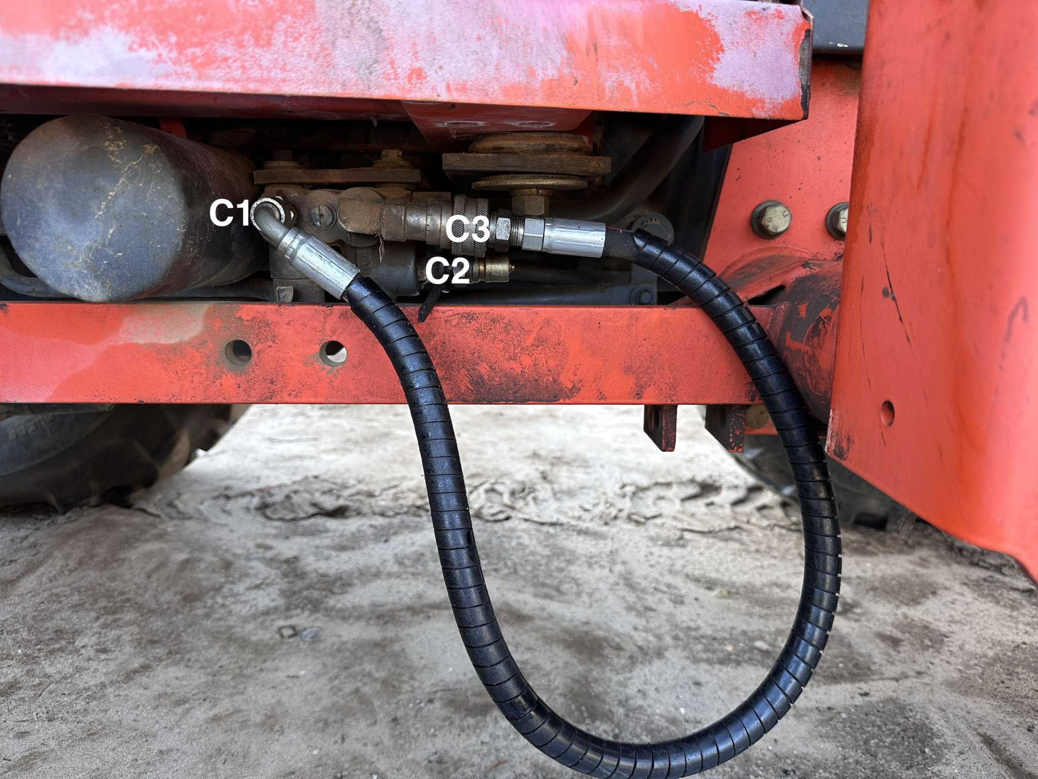

I am attaching a photo of the hydraulic connection points on my Kubota Tractor labeled C1,C2,C3.
Note - shown currently is where I looped one hydraulic hose so I could use the tractor without the front loader attached. I needed to use the tractor with the 3-point box scraper to move dirt before a rainstorm.

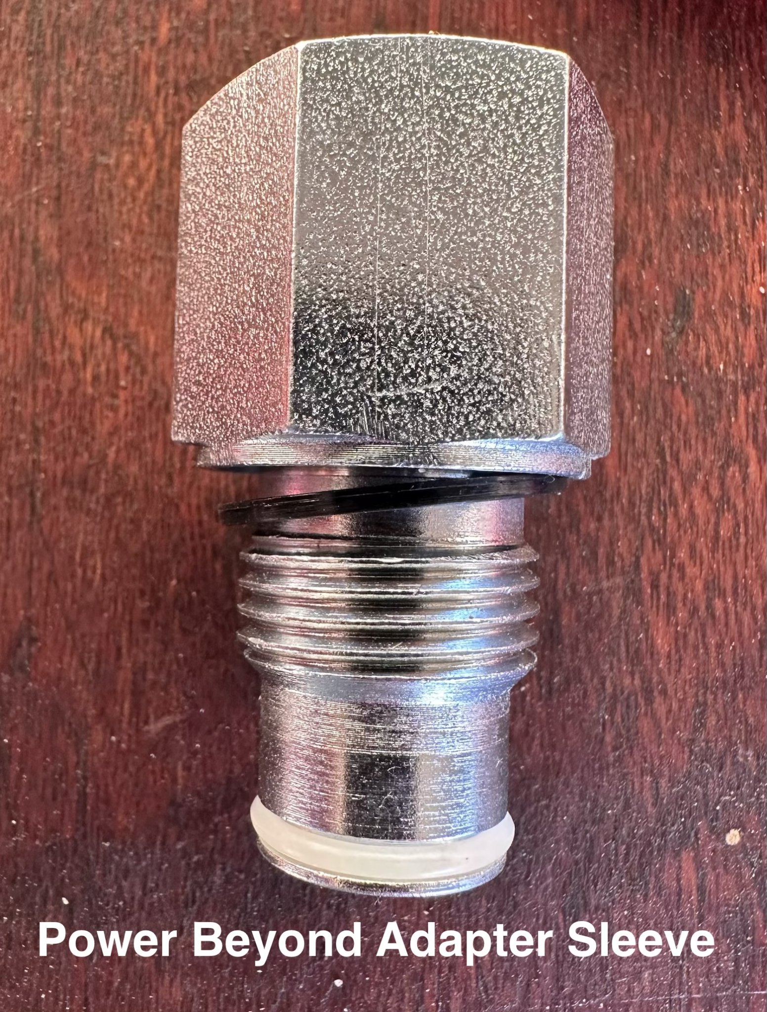

According to my Kubota LA481 Loader manual, my Kubota Tractor’s Front Loader has the “Float Feature”. I believe that a Summit Power Beyond Adapter Sleeve is needed due to the “Float Feature”.
Attached is a photo of the new Power Beyond Adapter Sleeve.
I could really use some help getting my front loader hydraulics installed correctly. Can someone advise me as to where the hydraulic hose(s) connections go and where the Power beyond Adapter Sleeve goes.

On the tractor:
C3 is Power out
C1 is Power Beyond
C3 is Return or Tank
The Hoses:
H3 is Power
H2 is Return
H1 is Power Beyond

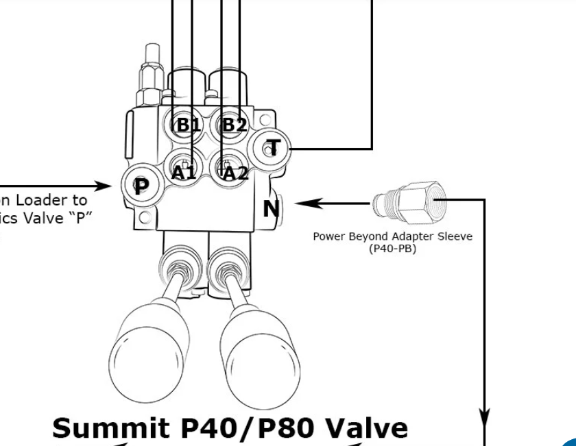

On the Valve
Remove the plug in "A" (labeled N) install Power Beyond sleeve, this will be your PB line.
"B" and "C" are the same (labeled T) this is the return line
"D" and "E" are the same (labeled P) this is the power in line
