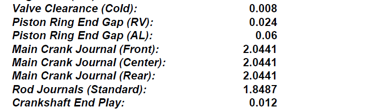

M Mike Harrison New member Equipment Kubota l-4850 Oct 14, 2025 6 2 3 Washoiugal WA Oct 14, 2025 #1 Can everyone tell me what the ring gap should be set at? Also what should the tolerances be on the Rod bearings?

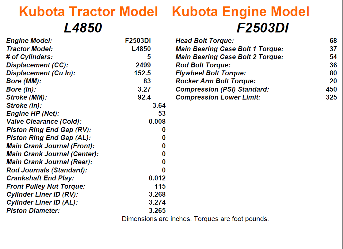

North Idaho Wolfman Moderator Staff member Lifetime Member Equipment L3450DT-GST, Woods FEL, B7100 HSD, FEL, 60" SB, 743 Bobcat with V2203, and more Jun 9, 2013 34,181 9,371 113 Sandpoint, ID Oct 14, 2025 #2 Here is the missing information from the bottom part of the above info:
M Mike Harrison New member Equipment Kubota l-4850 Oct 14, 2025 6 2 3 Washoiugal WA Oct 15, 2025 #3 Thanks for the help. exactly exactly what I was looking for Reactions: 1 user
