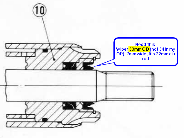

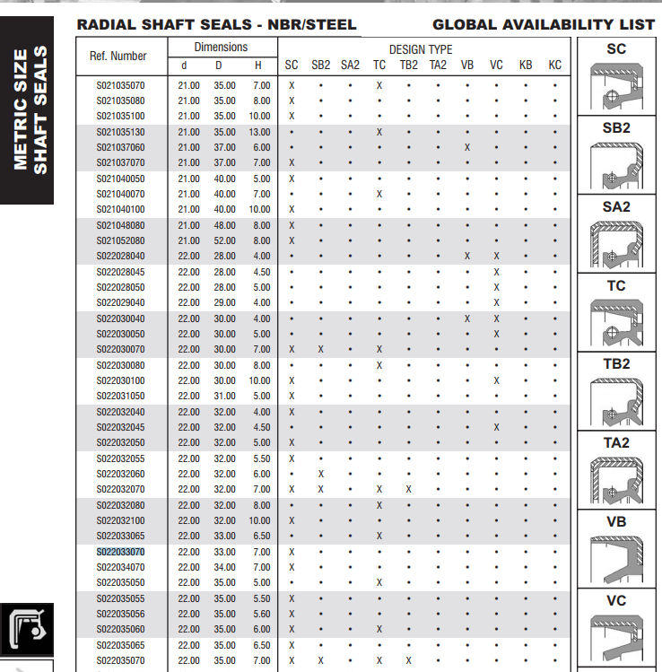

A final thought. Since 22 x 34 seems to be more standard, have your gland machined from 33 to 34mm.

Hey mate,
Drop the inner diameter and height if you have them, and I’ll have a look around for you. Or post a clearer pic of the markings if you can.
Hi, thanks for the kind offer, and welcome to the forum!

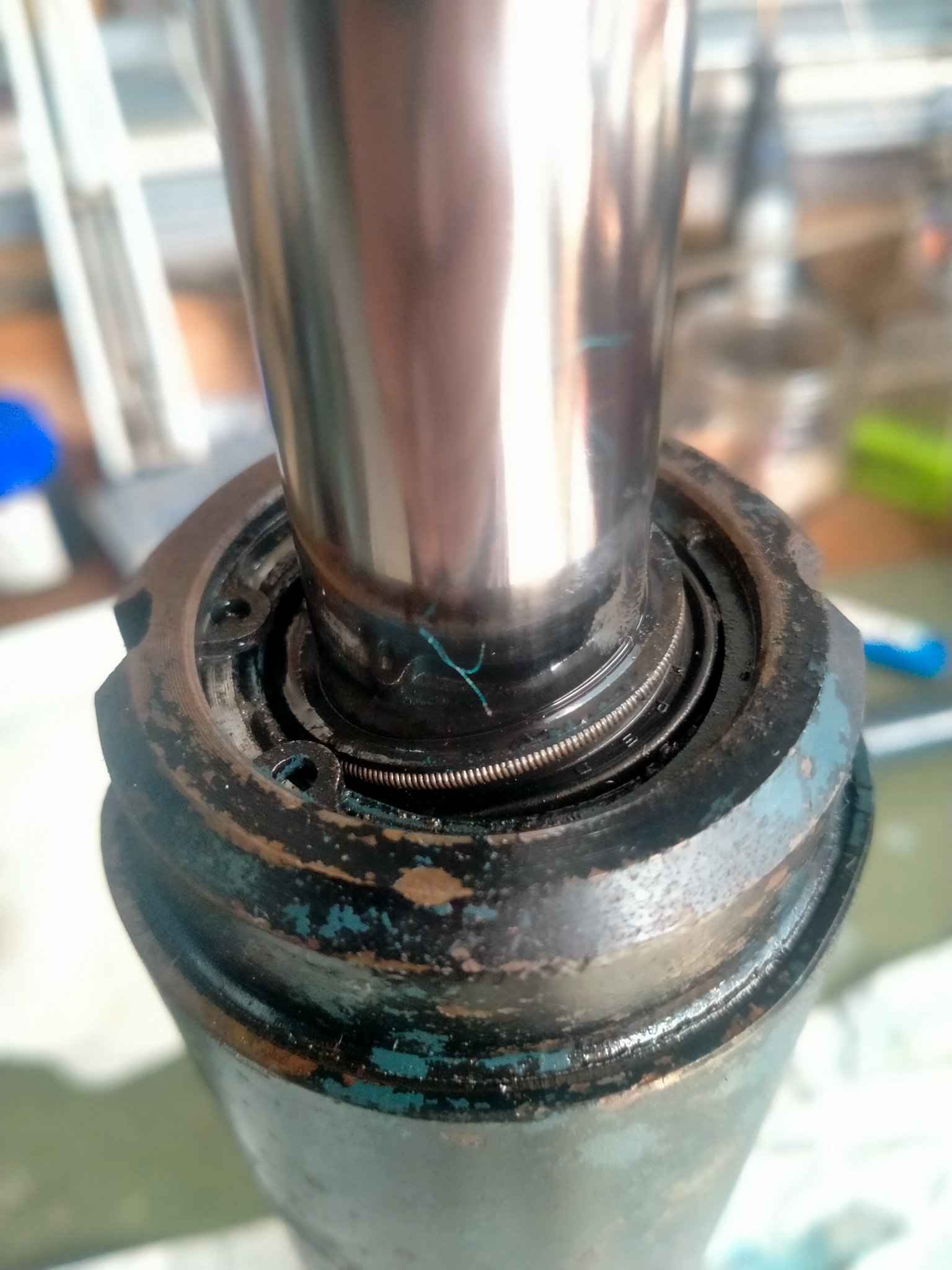

I have completed the re-build, with a new rod wiper. I put potentially useful info about the re-build here: https://www.orangetractortalks.com/forums/threads/power-steering-rebuild-kit.77801/post-843378 Turned out the OD in the end was 32mm, my bad (really bad). I'll edit this post to 'solved'.
