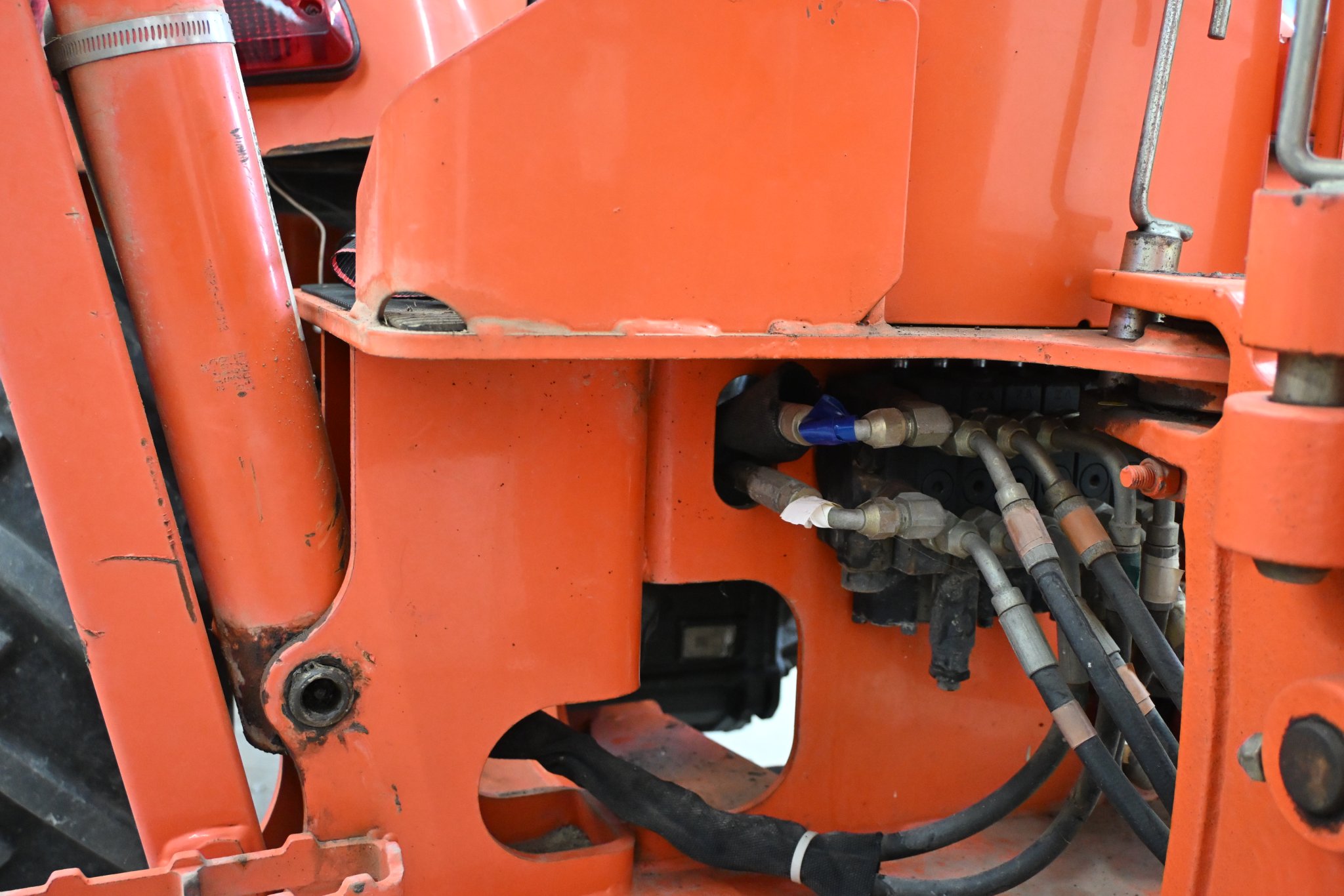

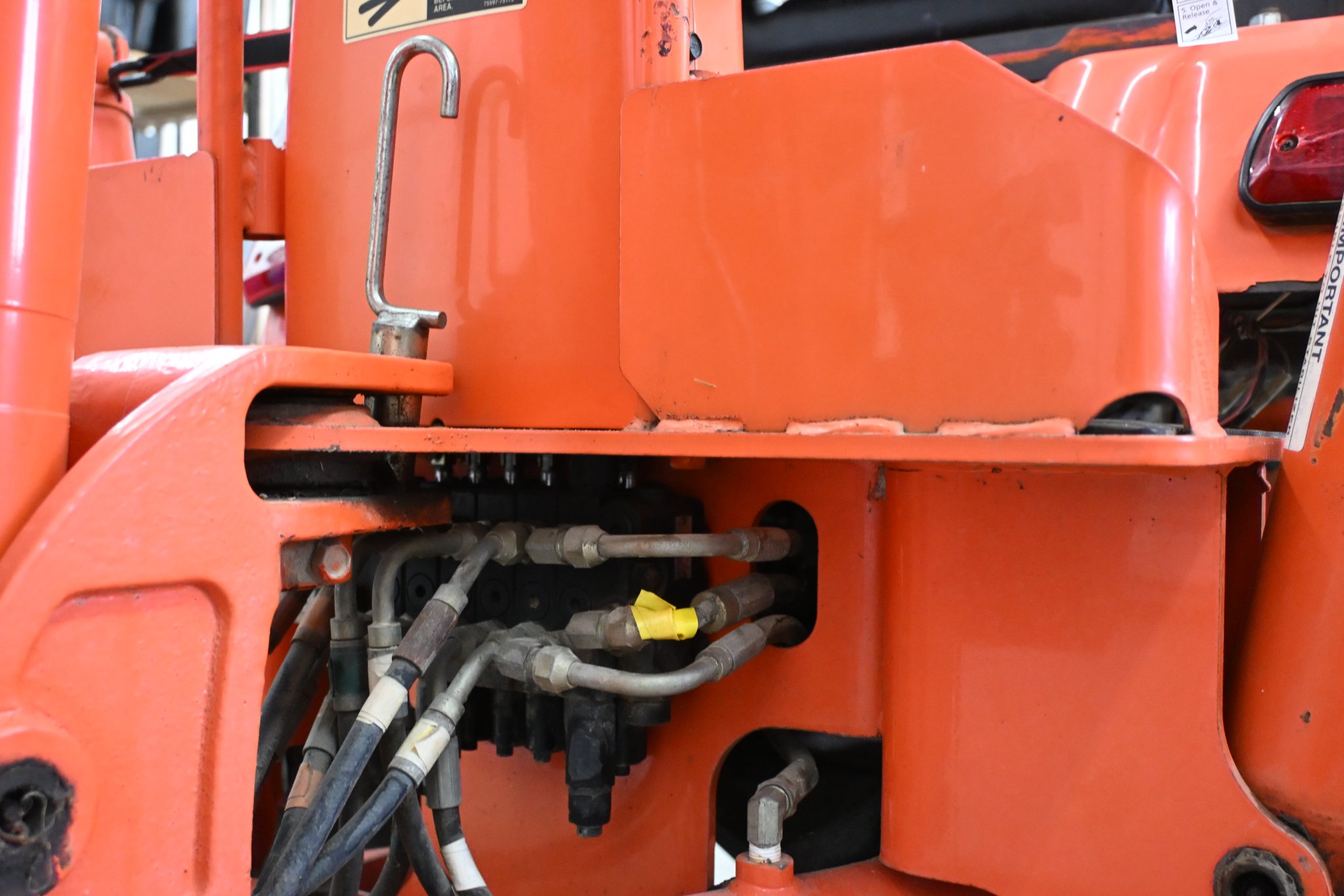

Hello, looking for assistance with connecting hydraulic lines between aBT601 backhoe to Kabota BX2670 tractor.
I have attached pictures, and color coded the lines. Blue, white and yellow come from the backhoe. The yellow is on the left side of the valve body and blue and white on the right side looking forward. The brown hose comes from the tractor. I think I can tee into the pink and green lines.

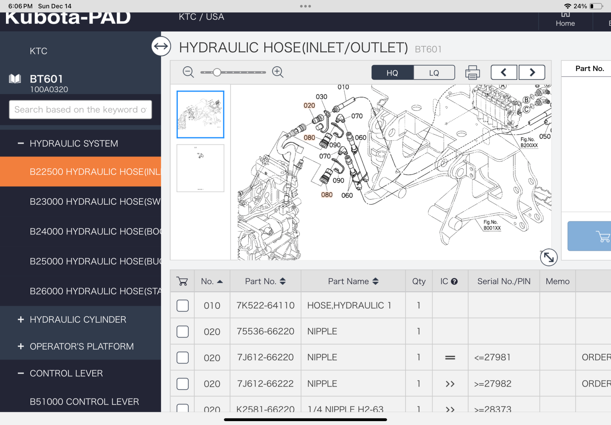

Go to this website and search for the backhoe model and you can find this diagram that shows how it is connected to the tractor hydraulic connections. That might not help if your tractor has not been set up for a backhoe.
Thank you for the info. I am starting to see what I need to do. My BX2670 was not plumbed for a backhoe.

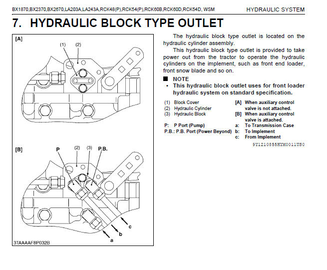

It's actually pretty easy to add a BH to that model tractor.
I'm assuming you got all of the subframe to mount it to the tractor.
This is the easy and proper way to tap into the system.
The P line goes to this block.
This is the adapter plate on the side of the tractor.

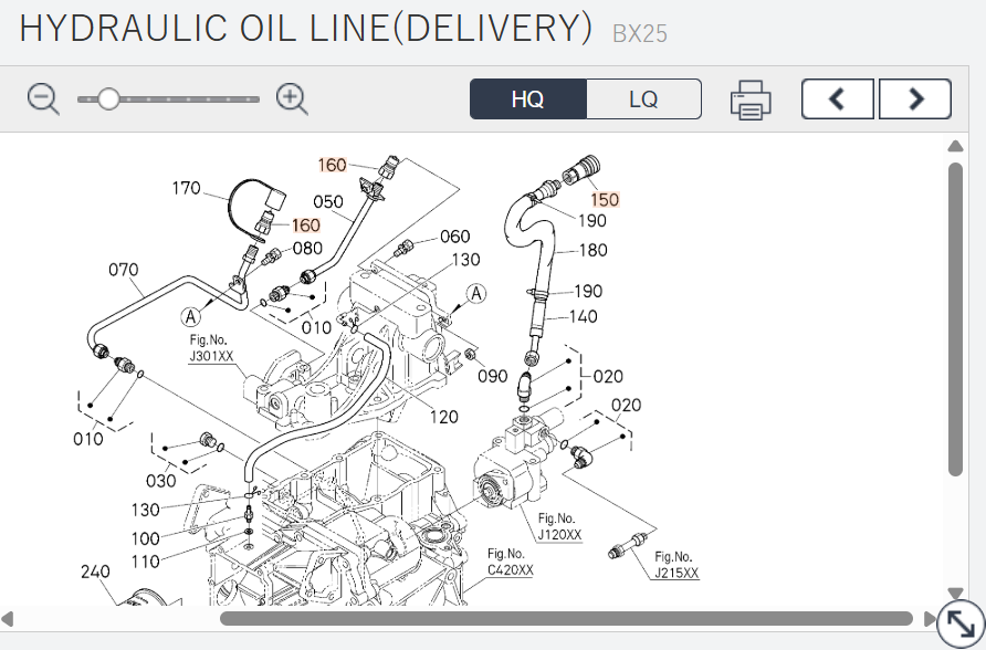

Thank you for all the information. I now see what needs to be done. I do have one question. I would like to purchase a Kubota original part. It is the PB tube from a BX25 part number 050 so I can connect the loop when the backhoe is off the tractor. Can I order parts online or do I have to go to a dealer?

If you want to do this, you will need a few parts.

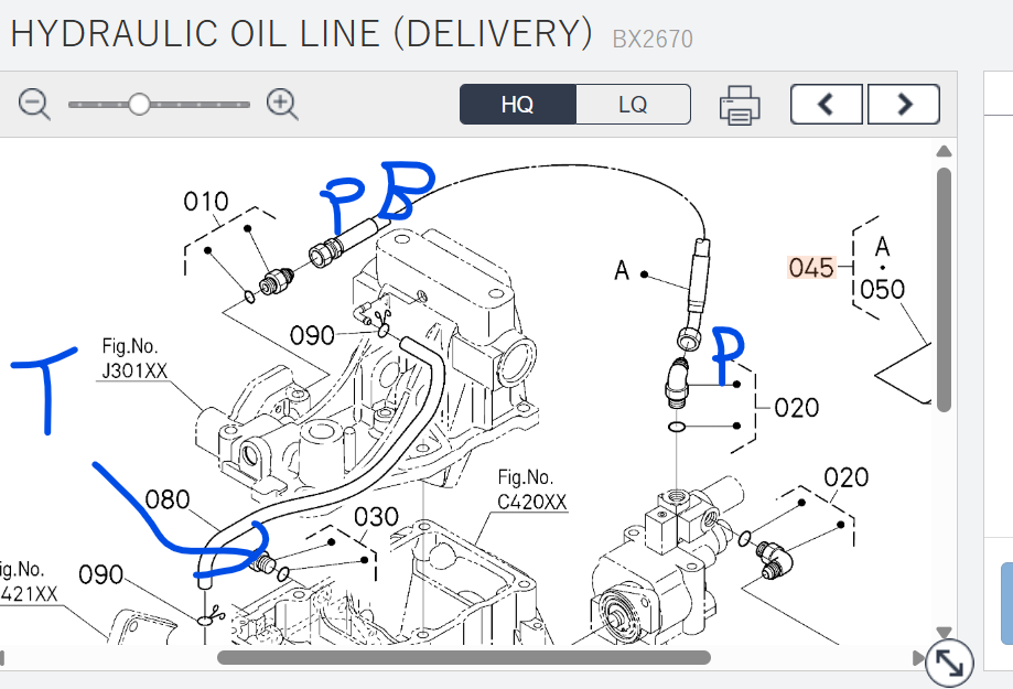

I have the backhoe connected and everything works great! I bought and installed part # 140 pump pressure hose and #50 PB tube for a BX25. On the attached pictures I connected the white hose to the P line from pump, Yellow to the PB loop and Blue to Tank return. Thank you to everyone for your input. It really helped a lot. Merry Christmas and happy digging.
