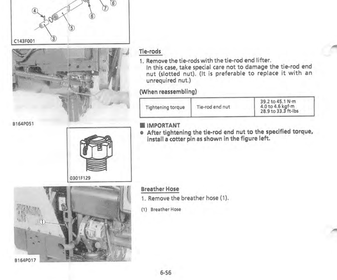

This is all I saw in the WSM
Mine has some wear in the bell crank (steering lever) bushing and/or pin. I need to get around to it.

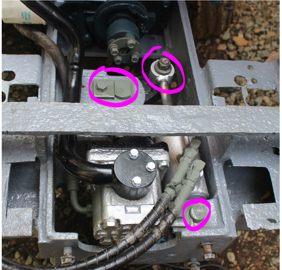

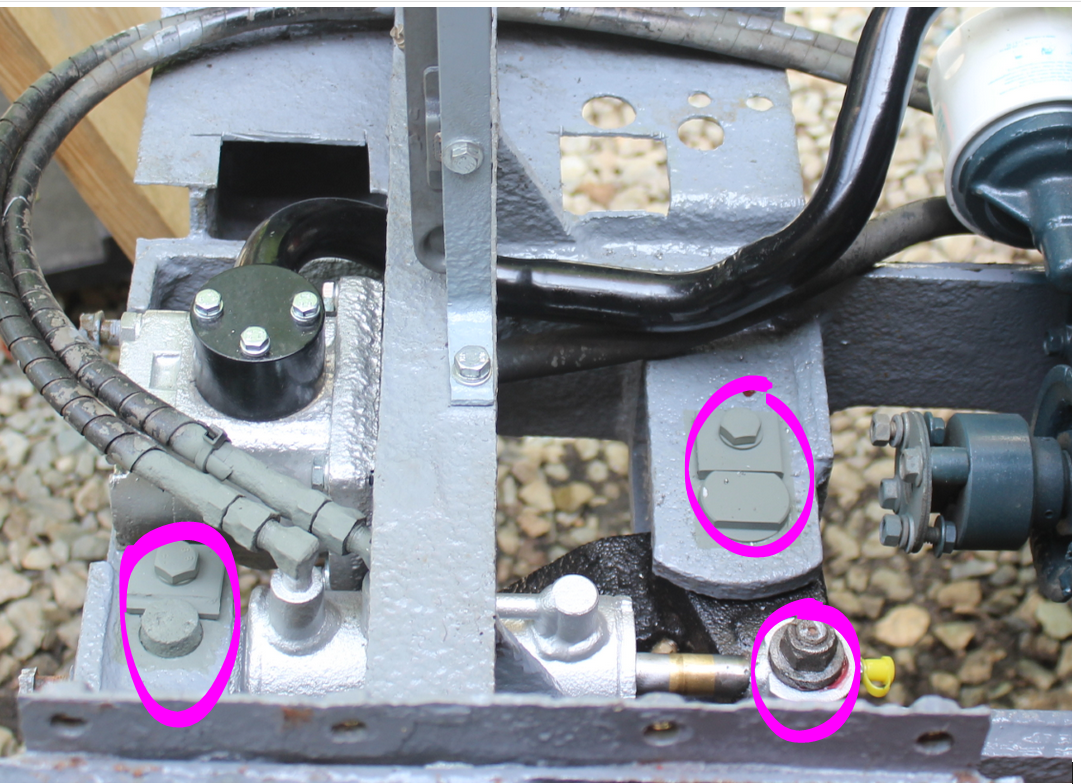

Hi @captaintmb.
It was a miserable job and the first thing I tackled starting the rebuild.
Both pins were ruined. Lack of lubrication, rust and wear ruined them.
The steering pin (very large pin) was seized almost like the pin and plate were the same metal.
I made a tool out of 1" steel square tube welded to a 1" solid round bar. It looked like a "T" shape.
The idea was for my lovely wife to hold the tool by the square tube, (and thick gloves) while I hit the round bar with a sledge.
I used two propane torches on the pin (all over - red hot) and just beat the pin from the top.
For the smaller cylinder pin. I did the same thing. Suggest you disconnect the hoses from the cylinder and remove as much hyd oil as possible.
Each pin has a notch at the top to keep the pin from spinning. There is a bolt that simply holds the little metal plate in place. I was lucky that I was able to extract the bolt without too much trouble, but that is really not as problematic as the pins themselves.
The steering yoke has a large bushing (that mates with the pin) that likely is ruined and should be replaced.
The cylinder bushing on the pin end wasn't a problem. Amazing not much wear - but then the cylinder doesn't move very much. The bushing on the other end of the cylinder likely will need replaced.
I had the axle removed since I was rebuilding all the seals and painting/powdercoating the components. The frame was placed on some tree trunks I had cut to the proper length. They were very solid.
One more thing - If the pins are not available, you can get some steel and have a machinist turn to the right OD.
Let me know what else you need.
