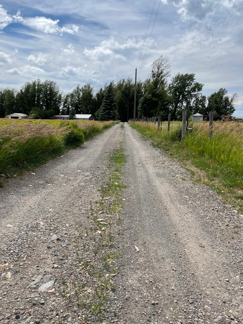

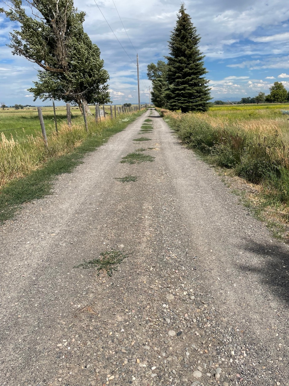

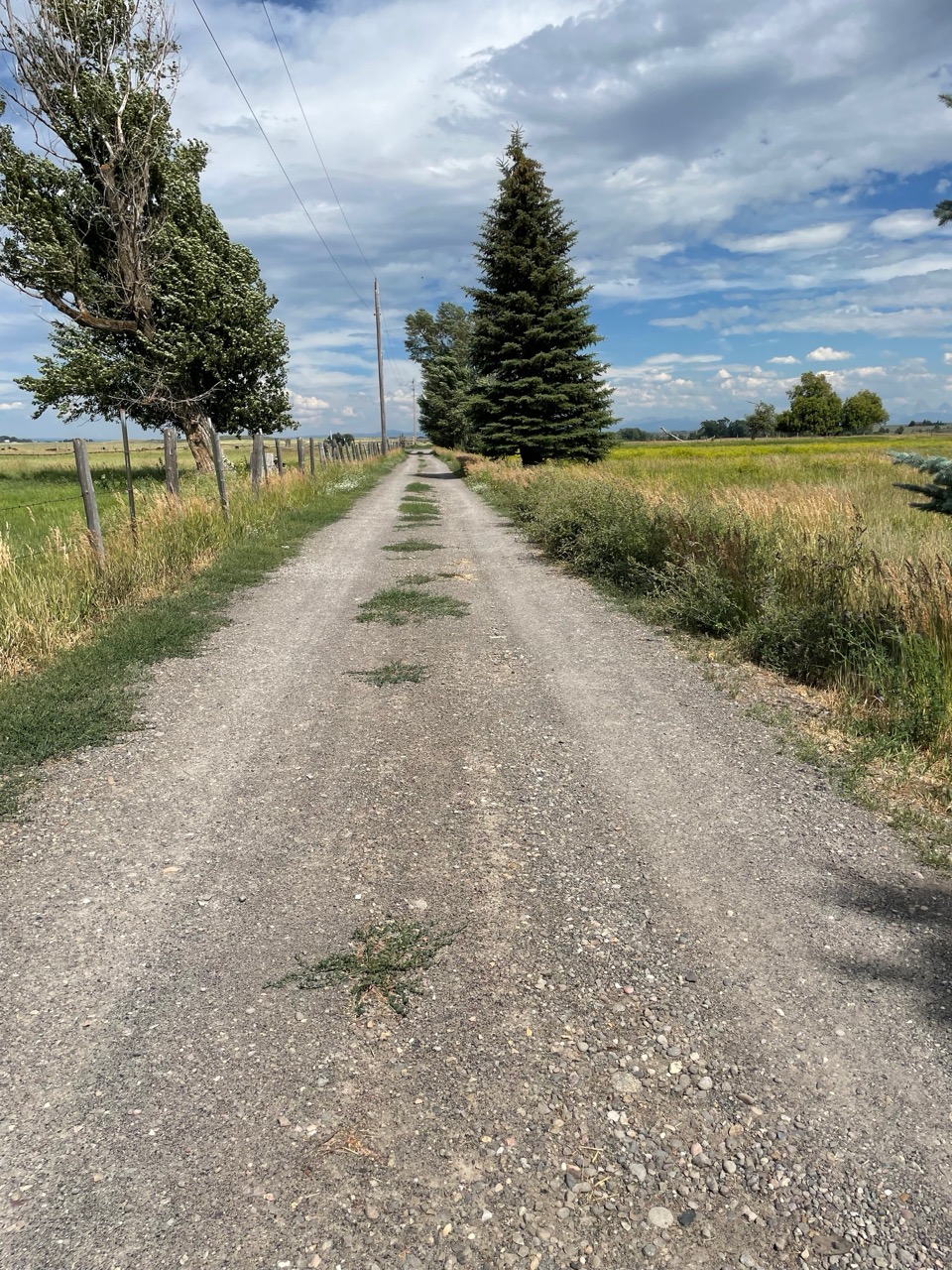

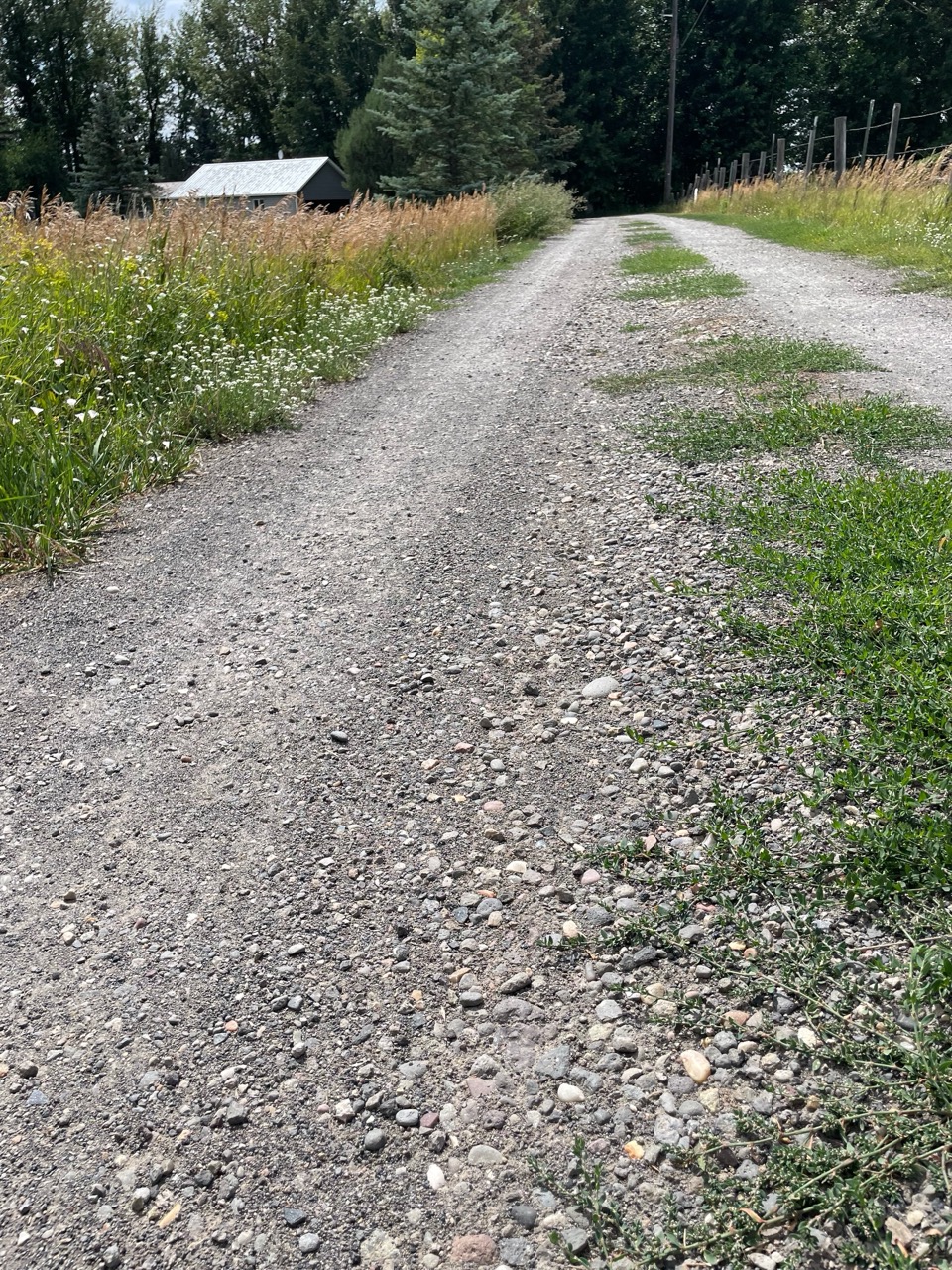

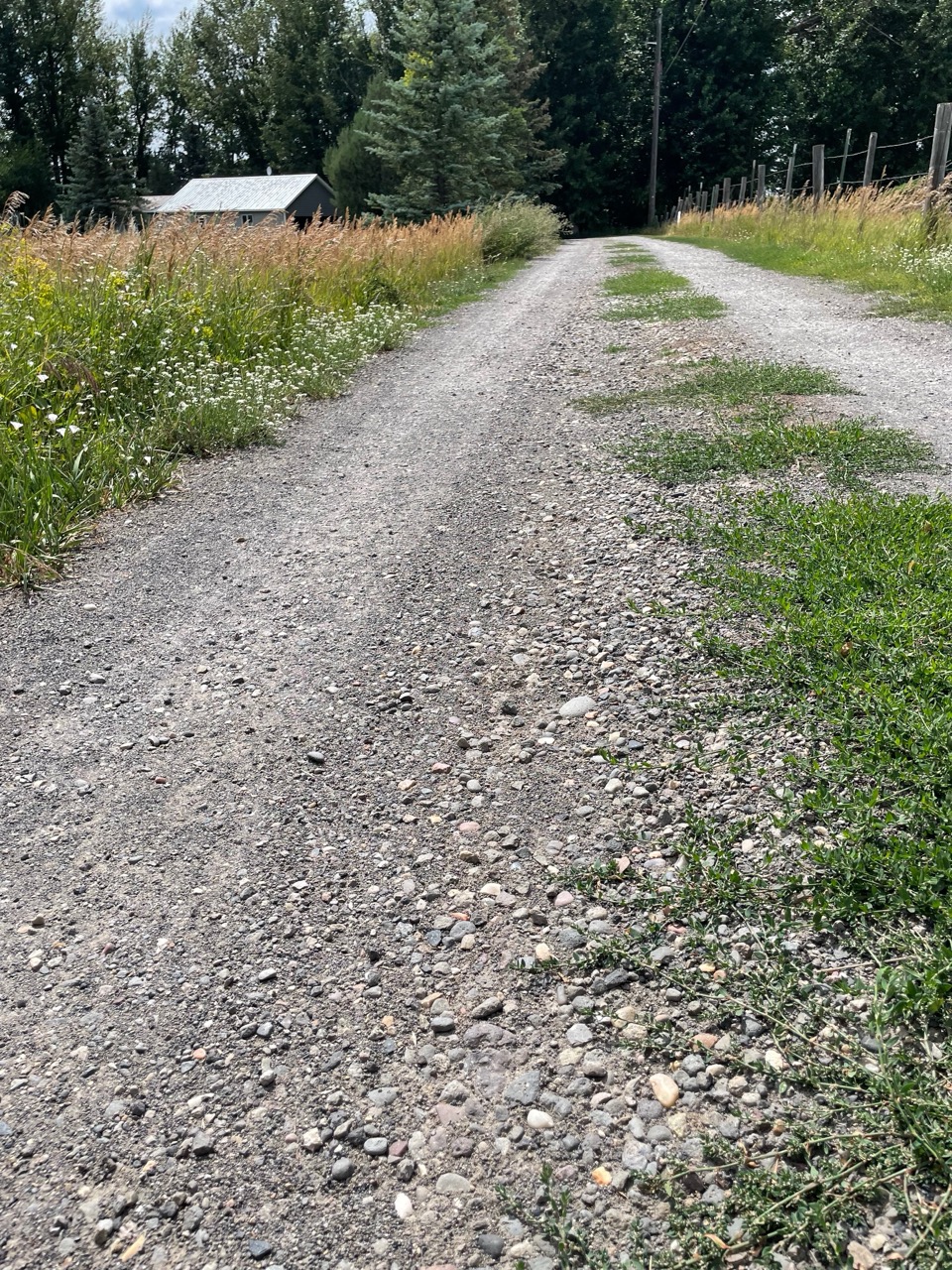

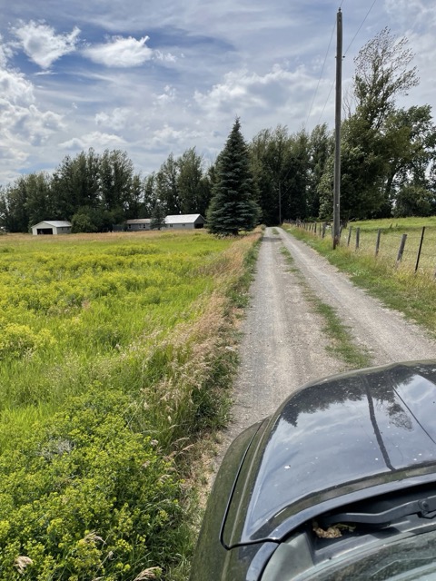

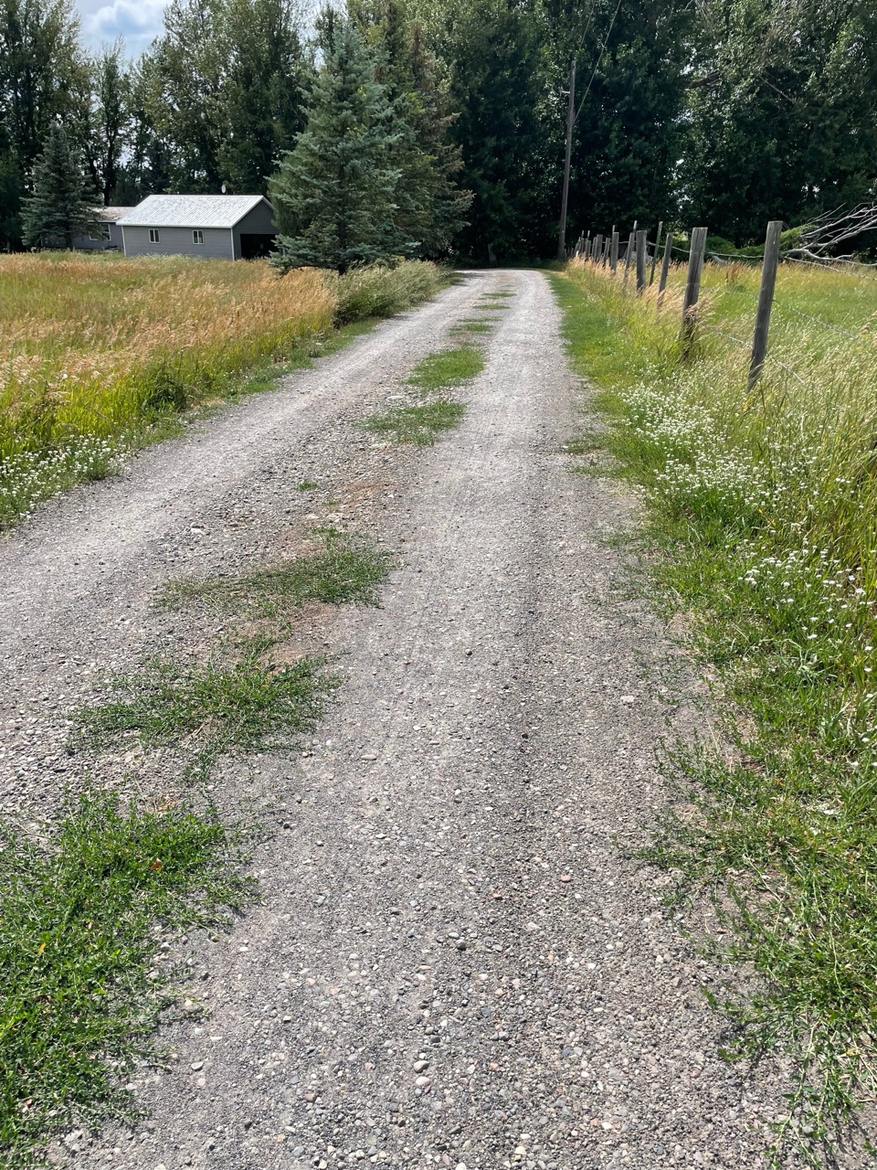

Our gravel road is rutted and needs fixing. I have a lx2620 with a box blade and am ready to tackle it, but I need some advice. Pictures below dont quite capture the grade/slope issue but hopefully you can make out what im seeing. On one side of the drive is a fence, the other side drops off into the field. I cant tell what they originally did here but the question is, do I try to put a crown in the center, or can I/should i just slope it all away from the fence and towards the other side, where it drops off into the field?
How much of a slope, in either case, and how might i measure that, lacking a transit?
Any idea as to how much gravel I might need on this? My original estimate of 3" seems way too low, now that I looked at the troubled spots.
Any other thoughts on what im about to do?
I appreciate any help you can offer

I would slope it from the fence to the field, just slightly... you can eyeball it. Wait until it rains and see if it works. You'll most likely not get it right the first time but you get practice doing it. As for gravel, get it right with the slope first then add gravel after you got it right. I would ask the driver to try and spread it with 2" - he should be able to get it close.

looking at your pics, I'd just slope it from the fence to the field side slightly.
Honestly, I don't think that you'll need to buy any stone at all. Put the rippers down on the box blade to loosen what you have. The box blade with pull up the stone. Once the box blade is full of stone it will level off your driveway. Just raise one side of the box blade a bit to get your slope.
If you did need to buy stone, the easiest way to figure it is that a yard of stone will roughly cover 100 sqft to a depth of 3". That yard of (driveway) stone will weigh in just shy of 1.5 ton.
Alternatively, 1 ton is approx 3/4 yard...so about 75 sqft at 3' depth.
There are many good youtube videos on how to rejuvenate a stone driveway. Just watch a few of them before you proceed.

agree to slope from fence line to ditch, no 'crown' in the center.
maybe start straight blade (no angle, or pitch) to remove the crown, then angle toward ditch.
After you've made a zillion passes, quit for the day, let Mother nature take over for a week or two, then grade(pitch) towards the ditch. Drive on that for 2-3 weeks and DON"T drive in the same two lines....
Late farmer cross the road would drag 8' C-channel and used tire chains, up and down his 1/4mdriveway, every Sunday, after church, before brunch. His driveway looked GREAT !
You may find after restoring the 'base' you won't 'need a lot of 'topcoat' gravel.
When you do buy it, lay ONE course down, drive on it for 2-3 weeks, THEN add another if needed.
The idea is to tamp each thin layer firmly. You cannot add '4-6" and get a good result.

I would mow the edges even if it's just a bit. I also would follow the existing slope.
Do take your time with the box blade. If it's level, it should still cut enough to smooth the driveway.
Don't use the rippers unless you have to. It will increase the amount of work you do to smooth it back out. Otherwise, you'll have lines in your driveway from the rippers. Rippers are good for potholes, but I'm not seeing that.
If you have weeds, I'd consider spraying them and waiting a few days before mowing.
Finally, a landplane/graderscraper is much easier for a driveway. It take almost all of the thought out of it since the grader scraper drops the gravel automatically toward the left.

Do you know how to use a box blade? Basic question but if you have the top link too short to begin with, you can make a mess very quickly (several of us have done that). Try extending the top link so that you are riding on the rear blade of the box blade at first... then shorten the top link a wee bit until the cutting front blade starts to work up the gravel...
Learning, you'll be up and down, out of the tractor seat, adjusting things MANY times...
And yes, someone mentioned, your 3 point hitch, the right side of the hitch can be adjusted so that side could be raised or lowered. I would honestly try and get it somewhat flat and level first than progress to this!!! Good luck, don't be afraid to show results, good or bad and ask for more help!!

My 2 cents to add to Jay's very solid advice:
1) your light duty (read not much weight) box blade won't do a whole lot unless you have had a decent rain recently, and you need WEIGHT on that blade. I have a light duty 5' BB with a 14" log that is 5 ft long strapped on top. I wouldn't use rippers either.
2) A very thin layer of gravel is all you really need, but only after you get it graded. A good driver can tailgate as thin as you want. After that drive up and down over and over with the heaviest vehicle you have available, getting every little line packed down. A good rain will almost cement it in if you have a lot of fines in your gravel. Too much thickness will just be soft to drive on and will cause washboarding and divots. This from personal experience.
3) Remember, the enemy of good is perfect. I always have to remind myself of this because I'm a perfectionist. Tamp it down, let weather do its part.

One other thing to remember about the slope and a rear blade or box blade. If you set the slope on the blade for going out of the drive, when you head back in the slope of the blade is the wrong direction and will cause you a headache. Just work in one direction, drive back with implement up and then start working again when you are turned the correct direction.
There are ways to set the slope easily if you really want to do that. Most people will just use the
“that looks good “ method and adjust it as time and erosion occur.
You can set up level across the driveway with a water level or an A frame level or a transit or a hand held level
