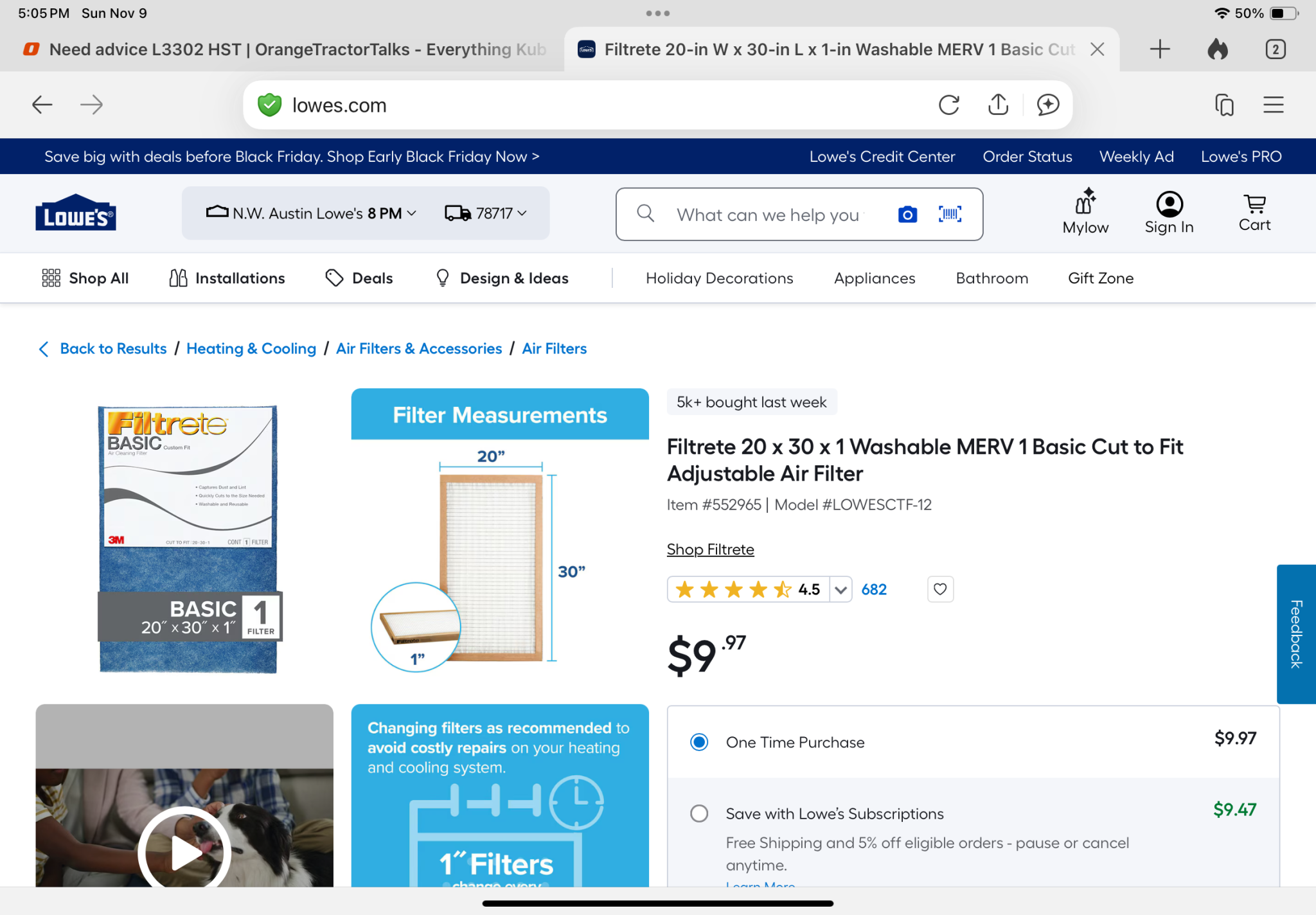

I will try to fill in any gaps for you as best I can as I probably am ignorant of some gaps as well. The only thing noticed at first was a small puddle on the ground under the tractor after I parked it. I simply put a bit more antifreeze (got it from Lowe as well because I wanted to make sure I had the right stuff) because they said it may have just been an air bubble in the line or something and it might've burped out. After that the level in the reservoir never changed so I assumed that problem was done. Why didn't I call the delivery dealership? I got the tractor from Wowco in Baytown,TX, the tractor was up in Mt Enterprise, TX (3 hours away from our home in Houston and Wowco) which the closest dealer is Lowe tractor in Henderson, TX. I didn't know what was wrong with it until it started acting strange so I figured Lowe is the tractor dealer I would be doing business with for ongoing maintenance so figured it was best to start there. I do plan to call Wowco to see if they can give me more information regarding the tractor before it was raffled based on the replies on here. I got it from them April 21st of this year. It had 4.4 hours (just got the original paperwork from the safe) on it (please correct me if I am wrong if 4.4 hours makes sense as a used tractor or is normal mileage for transportation to dealer). I took it to Lowe in Henderson in early October with 15 hours on it, took them a couple of weeks to get to it and they gave me the news about 2 weeks ago which was when I sent the letter.
I did not pay taxes on the tractor, I literally walked in, they verified my drivers license to ensure I was indeed the winner, gave me keys, manual, gave me a walk around and went over the basic functions of the tractor and then I loaded it up on my trailer and drove it to our property. Warranty I honestly assumed it was new so I assumed it came with a standard warranty. They did offer to sell an extended warranty called KTAC? when i picked it up but I was under the impression it came with the normal kubota warranty and wasnt needed. Just saw on the paperwork from Wowco it says, "remainder of factory warranty available. Any warranty work to be completed by Wowco." Perhaps I should've driven it straight to them first and had them break it down. Definitely need to call them tomorrow. As for a PDI sheet I dont know what that is but dont have anything that matches that description that I know of in my envelope from them. I did get an operators manual for the tractor and implements and 2 keys. They said first service would be at 50 hours. I didnt run it a whole lot because we live in Houston, I work full time, we drive up to the property a few days a month to work on things, mow, etc. It was timber land prior to us paying someone to clear it so a lot of work still left to do. If we were out there all the time I would've had a lot more hours into it for sure by now.
I am glad to hear that the air filter screen getting clogged wouldnt cause this. At least I now know that for the next tractor. I thought for sure operating it that it was getting choked out.
7,609
2,933
I am not sure what you are referring to as an “air filter screen” since there is an engine air intake filter and then a filter screen in front of the radiator to keep chaff out of the radiator. I am assuming you are referring to the fine mesh filter in front of the radiator. The engine air intake filter would stall the tractor engine out if clogged but it wouldn’t overheat the engine. See below for more details on the engine.
It is true that the weed and grass seeds will fill that radiator screen up and reduce the amount of air that gets through the radiator to cool the fluid. I was going to mention that when you are mowing it is a good idea to stop ever so often or as the temperature gauge goes higher to clean the chaff off the screen in front of the radiator. If there is room in front of the screen I suggest you add another filter in front of the screen like this plastic washable filter available at Lowe’s Home center (not the dealer Lowe). Cut to fit the size needed. IMG_0545.png
