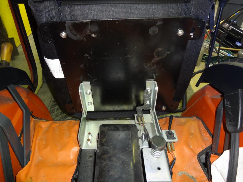

Can I get it to fit on my B3200? The OME seat Sucks big time.... It's only thing I can find wrong with this machine.
I looked at couple of other seat up-grades and just wouldn't fit , without by-passing the safety switches and or the whole base.
Un-doing the dead man switch is not an option where I come from.

I would think it should bolt up to the original mounts.

So I received the new seat today, had to fab up a new base plate to make the Dead Man and Rear PTO switches work.

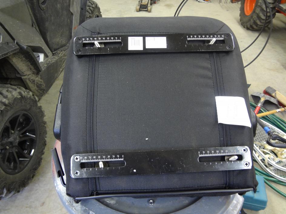

Removed the sliders from the new seat, not needed still using the OEM.
All over not to bad can wait to get out and try it out.
