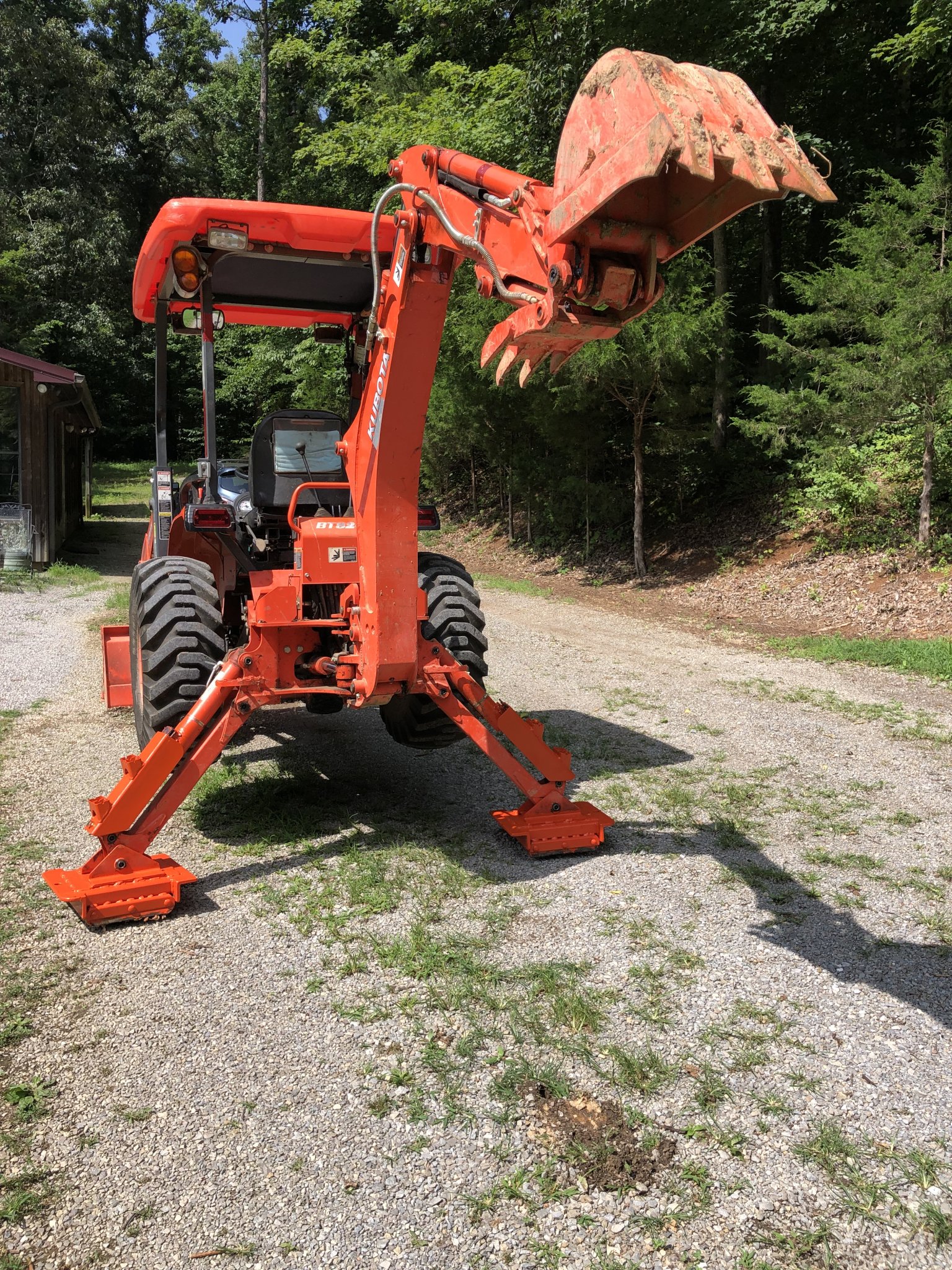

Take a look at the subframe on the Kubota TLB's and compare it to a backhoe attachment subframe.
You get bigger/more hydraulic pumps, a much stronger/faster loader etc. with a TLB. The TLB line is made for digging unlike an ag tractor with an adapted backhoe. Don't forget the loader will still be a ag loader which is really a material handler.
If you intend on keeping the TLB after the trenching work is done, I wouldn't bother with anything smaller than a L47.
Even my L47 operates less smoothly than a full size TLB. Operating two functions at the same time tends to starve the pump. I believe the rotation has it's own pump for that reason.
If you intend on selling after the job is done, I'd look into renting a mini-X as suggested by mikester.
