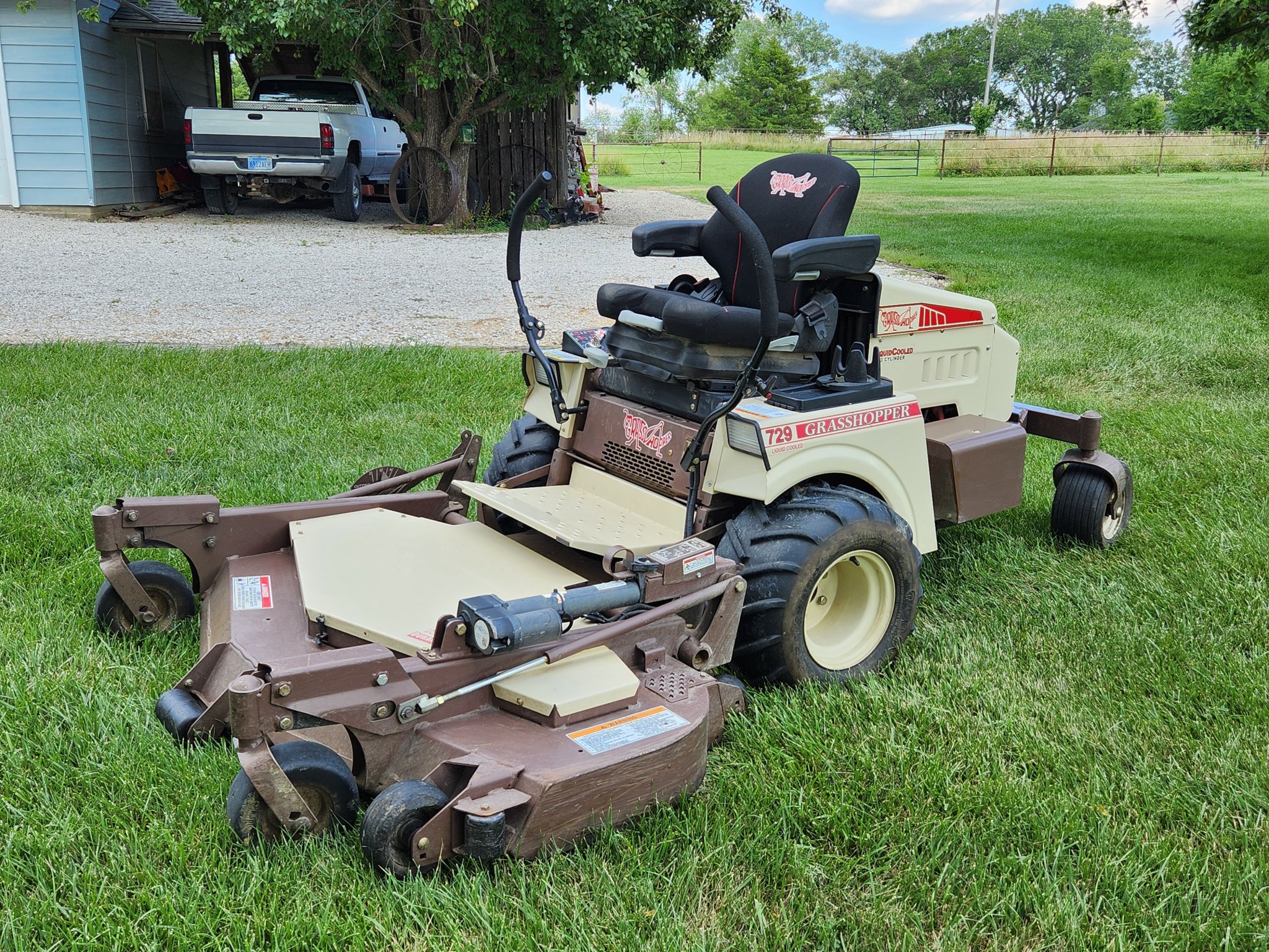

I'm extremely prejudicial, but if you want an excellent zero turn look at Grasshopper. Get one with a powerfold deck. You can get a diesel or gas. Gas is a Kubota engine. All models are commericial/industrial rated. If you trim any trees get the one with the deck out front (It's the one with powerfold).

Thanks for all the help.
It's too late for me to start looking for other brands. There aren't a lot of Grasshoppers around here anyway.
I'm really hoping I bring a mower home tomorrow. I am beyond over the JD.
