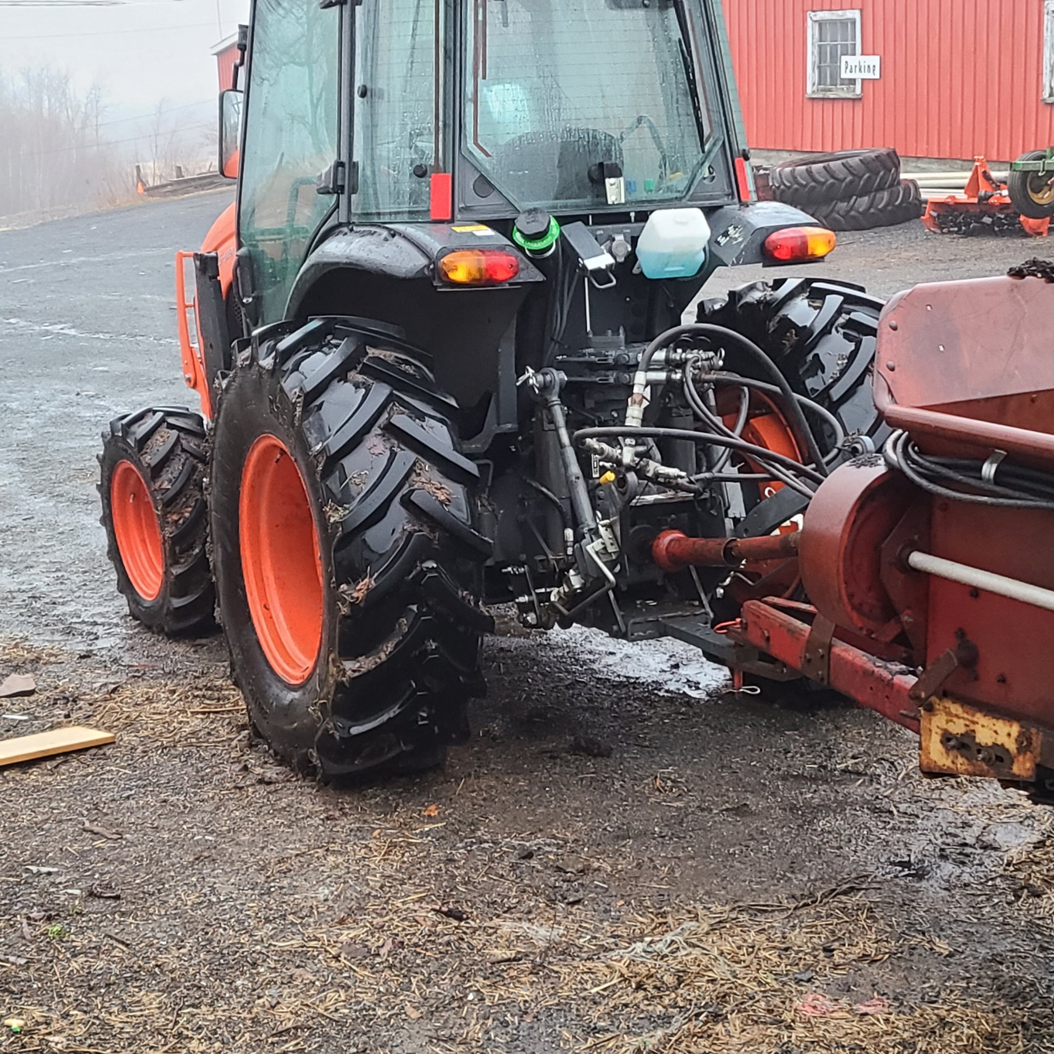

I'm really curious if anyone else has to do this but our current orchard tractor is the m5n-091, last one was a deere 5083en that fell apart. But we have narrow tractors to fit down the orchard rows because the limbs hang out. But were on a hill so some of our orchards are really tilted like driving sideways on stairs steep. Stock it would tip easy so both tractors end up with back wheels so wide they aren't under the fender at all.
But then it won't tip over, anyone else have land that they have to do this with?

Oh yes it's all ballasted to the max, see theres the odd rut too which makes it steeper.
I know what you mean, definitely to late and with the clay it wouldn't likely work well but I have seen that before.
